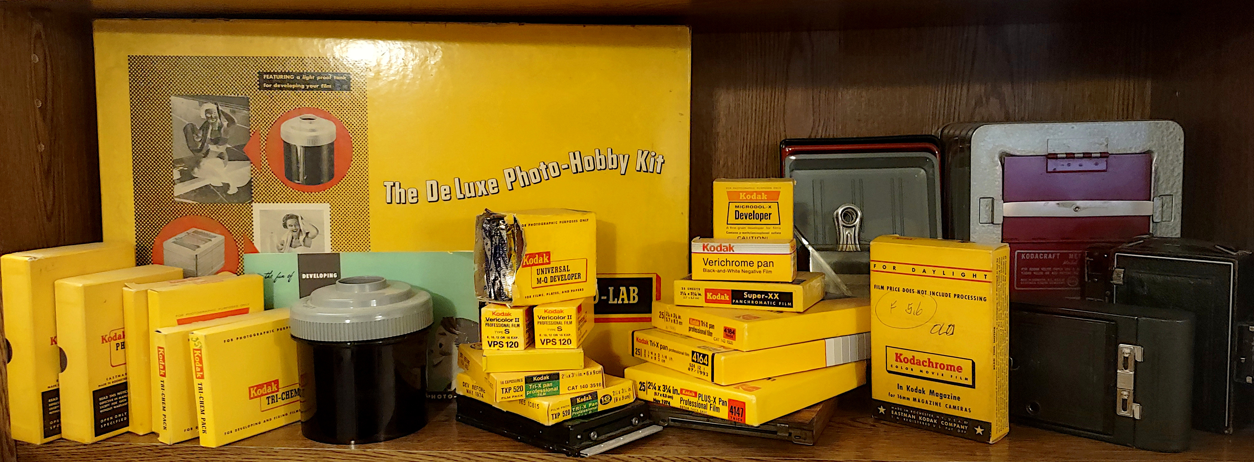

BTW, once upon a time, the "universal" developer for both film and paper was Kodak M-Q. That was followed by Dektol. Both were packaged - at one point or another - in Kodak "Tri Chem" packs for use by low volume hobbyists. It's how I got my start so many decades ago.
You can see some examples in the middle if this picture from the photo shrine in my office...
