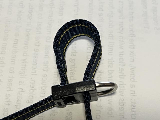

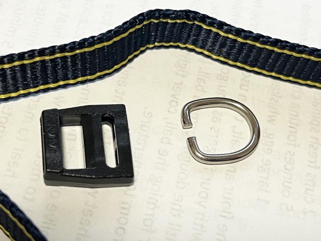

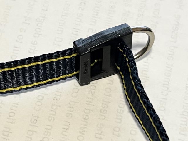

From appearances, the strap in question is a standard Bronica strap. The metal ring is a U-shape ring with an opening. Simply unthread the end of the strap trom the plastic path of the plastic ring cover and you will see the opening in the U-shape ring! See p.24 in this manual
chrome-extension://efaidnbmnnnibpcajpcglclefindmkaj/https://www.cameramanuals.org/bronica/bronica_etr_si.pdf
Feed the strap out first, then the metal ring separates from the plastic and can be removed from the camera.

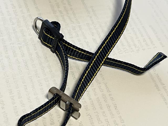

To my amazement, I have a strap in its original package! (I use a tripod.)
