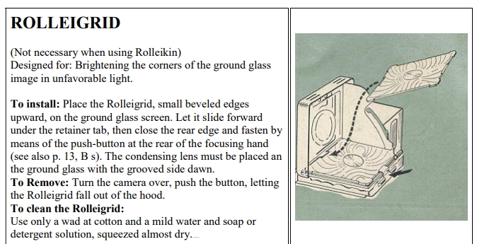

Yes, the shutter is odd. Slide one way to cock and the other to fire. No big deal after a while. I was just using mine a while back. One big improvement I made was to fit a fresnel over the ground glass.

So the fresnel helped brighten the image? How much did it cost?

I did clean the reflex mirror (which was in good condition) and replace the focus screen with the Rick Oleson screen- quite a nice improvement in lower light situations.
I found some 'bright' screens hard to focus. I left the original ground glass and make a copy of the Rolleiflex accessory fresnel by taking a fresnel from another camera. There is a clip that holds the accessory fresnel in place above the ground glass.
Sorry I’m a little confused by what you mean about making a copy of the fresnel accessory?
I had a fresnel from another camera and trimmed and beveled slightly to fit into the Rolleicord like this, on top of the existing ground glass. Nothing to take apart or replace.

I go back and forth with a 2.8F which has the fresnel built-in already so I notice the difference. Otherwise it is reasonable without the fresnel.
Ah okay I understand thanks for the clarification. Interesting I’ll see how I feel about the brightness after I shoot a few rolls with it. Thanks.
Good idea. Bright screens are often overrated. The Rolleicord Vx screens are pretty good. If the mirror is bad, that is more of a problem.
