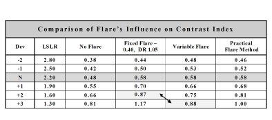

Bill,
I have a nice chart that has the CIs for various developmental models at home. I think it will help illustrate the concept. Then I want to start on K.
And while your analysis in post #21 is rather good, your conclusion is backwards. Think of flare as a buffer. It keeps you from having to too long of development times for short luminance ranges and keeps you from having too short of development times for long luminance ranges.

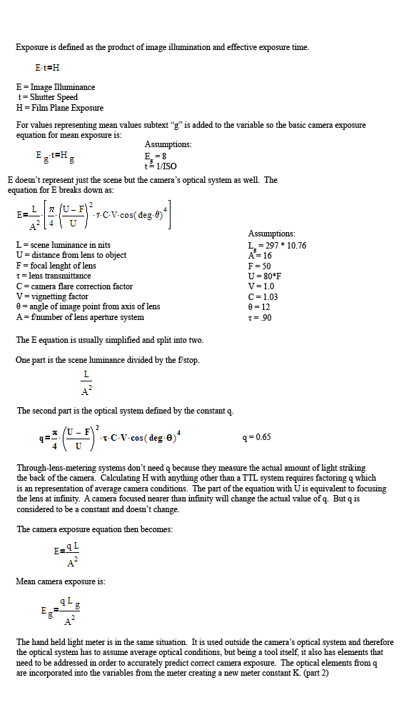

Defining K - Part 1
First DON'T PANIC.
Before being able to discuss the merits of K, we first need to understand what it is and how it works. The only way to explain how K and the other constants function and how they interact with each other is to use math. In order to have any insight into the process, you need to see the numbers and understand where they came from. I plan to have values for each of the variables and walk through the equations so that they make sense. I'm not very good at math myself which is why I use Mathcad for the equations. I just plug in the variables and let it do all the work. I'm sure for others like me, there's some type of freeware scientific calculator or Mathcad equivalent that can be found on the web.
So that it's not overwhelming, I plan to present it a little at a time. Part 1 is an introduction to camera exposure and the constant q, the camera exposure constant. It's attached and is a jpg file because I wanted to keep the math formatting.
