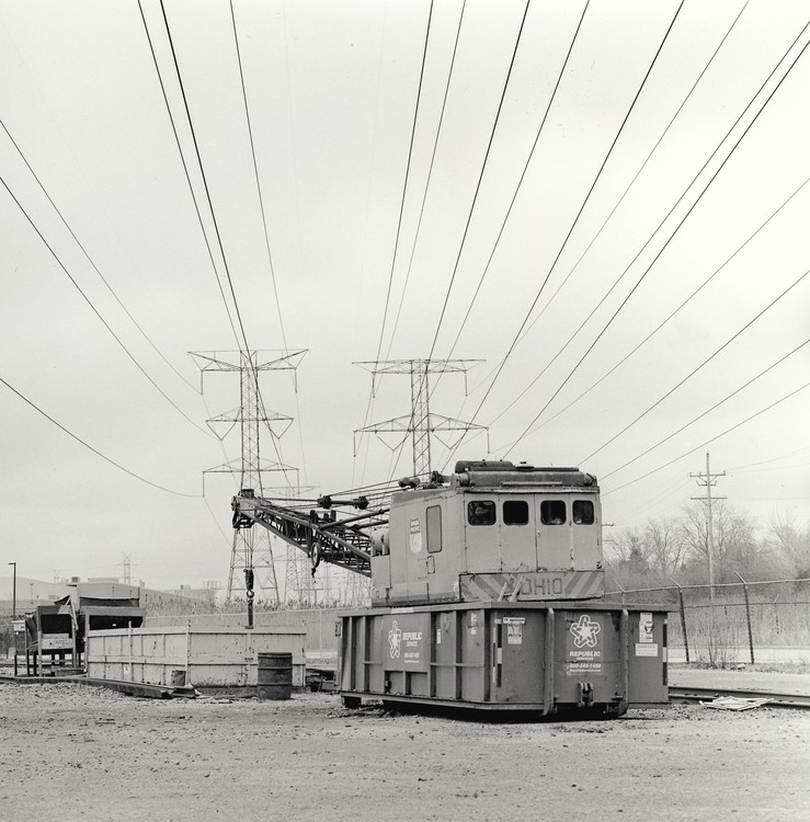

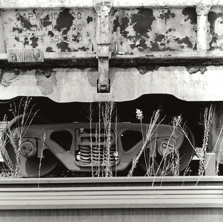

100mm f/3.5 Planar CF T* maiden voyage.
It's a bit hard to tell because I was hand holding, but this lens seems to do better at distance than closer in. It also does not focus as closely as the 80mm f/2.8 Planar CF T*.
Tri-X @ ASA 400, Pyrocat-HDC 1.5:1:250, EMA developed for 60 min. Scans of silver prints:
These subjects will not be offended that the lens shows every detail and imperfections.

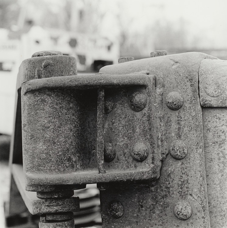

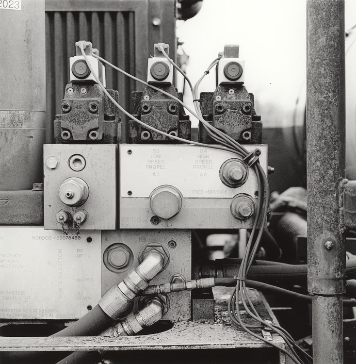

Here are some I did to test my new 100mm. These were handheld. I guess these could be even sharper had I used a tripod and prereleased the mirror, but it will give you some sense of the lens.
Scans of prints:

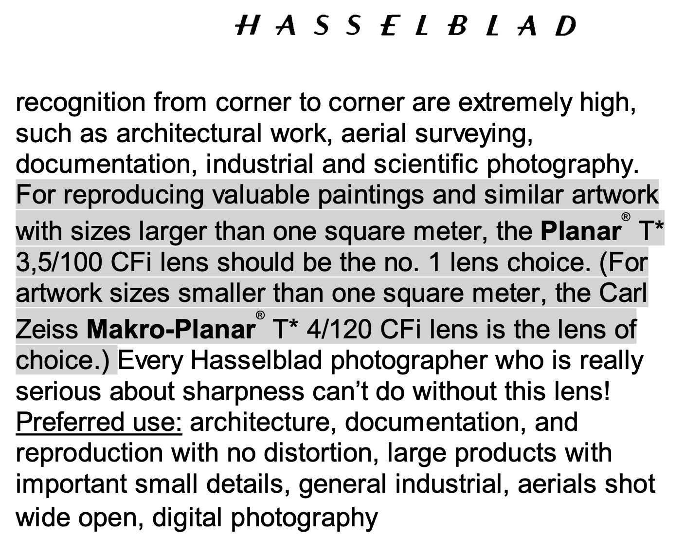

Actually, the 100/3,5 Planar is not famous for its bokeh. It is nothing peculiarly spectacular and under certain circumstances, it can be quite harsh. Please mind this lens was designed for aerial photography, landscape, architecture and industrial work, where out-of-focus areas are unimportant. If you want to have great bokeh, rather look for a 2000 body with the 110 Planar. If you want to stay with the 500 system, both the 80mm and 120mm have smoother bokeh than the 100mm.

The Makro-Planar 120 is often used incorrectly as a general-purpose lens. Besides macro photography, this lens is ideal for still life and studio work. Its design, which is intended to produce sharp images from corner to corner at close-up and macro distances, is not ideal for images at infinity. However, starting from f/11, it becomes acceptable.

As I mentioned in my previous comment, Zeiss states that, for higher resolution in reproduction work, the Planar 100 can be used instead. The Planar 100 is known as the sharpest lens in the Hasselblad system.

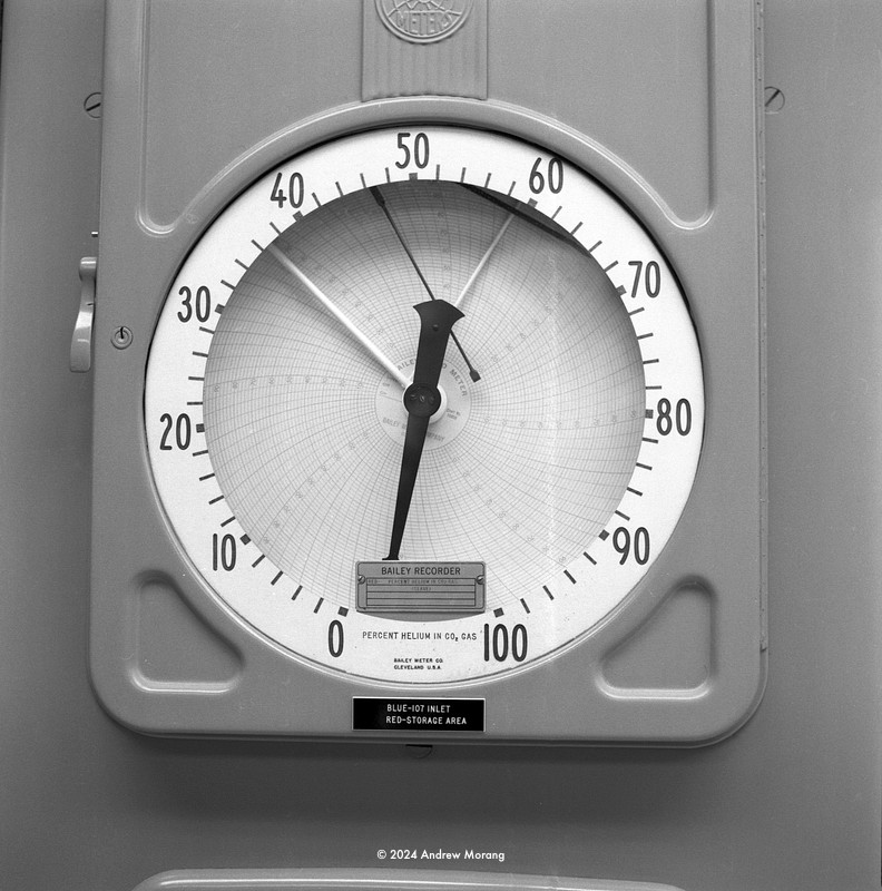

Not quite macro, but the minimum focus distance with the 80mm ƒ/2.8 Planar-CB lens (hand held, Tri-X 400 film). This is one of the instruments at the historic Plutonium Reactor B at the Hanford site in Washington state. I scanned the negatives with a Minolta ScanMulti film scanner.
Ah heck, my Kodak Instamatic X-15 could do that good. Snicker, snicker!😏😏 Hard to beat Zeiss glass and 120 film format.
