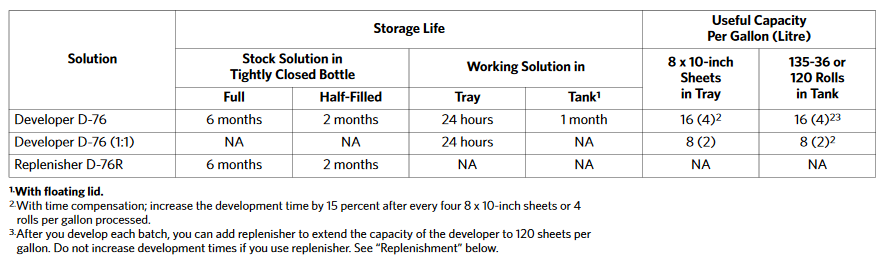

I’d like to find a way (increasing development time) to develop four 120 rolls reusing a litre of stock D-76. I don’t want to discard 2.5 litres after that, just because sometimes I can’t buy D-76 here, so I’d like to try Kodak’s recommendation of four rolls in a litre, instead of wasting more developer than it’s necessary.

Per the tech sheet. For every 4 rolls of 136-36 or 120, add 15% more time.
Per the tech sheet, increase time by 15% for every 4 rolls per gallon. Which amounts to (roughly) +15%/roll/liter. YMMV. Do your own testing.
https://imaging.kodakalaris.com/sites/default/files/wysiwyg/pro/chemistry/j78.pdf
Page 5.

In general it works very well, they said (adding 10%, 20%, 30%...) and even for ten rolls, not just for four.
But some members said, that can't be totally accurate because TMax films and classic grain films require different amounts of time increase.

Lots of people say there's no need to change time for the first rolls... I remember Bill Burk said he found that wrong. That's the only thing I did test back then: a second roll after the first one, in one litre, no time change... Bill was right. The second film was so clearly underdeveloped!

You need to adjust the developing time for the films developed or replenish. One way or the other account for the films developed or you will get flat underdeveloped film.

A few years into my experiments in film developing in the 1980s, I realised that ID-11 stock (which is effectively the same as D-76) lasts at least 6 months as 1 litre of stock solution in a concertina bottle. I tend to use the suggested times for the first 10 films, and add a minute or so for 11-16 and stop at 16. I put a sticky label on the cap saying developer type, date I made up the solution and the numbers 1-16 which I mark off by crossing each one out as I process a film.

When I did a second development (35mm 36 Exp. roll) with stock D-76 (1 litre) without extending development time, the frame at 400 was visibly underdeveloped, and the same frame at + half a stop was perfect (contact print). Of course the underdeveloped frame could be printed too, but it was clear a single roll takes a good bite of the litre.

For Perceptol stock (1 litre reuse) only four rolls are recommended, not ten.
Lots of people say there's no need to change time for the first rolls... I remember Bill Burk said he found that wrong. That's the only thing I did test back then: a second roll after the first one, in one litre, no time change... Bill was right. The second film was so clearly underdeveloped!.
