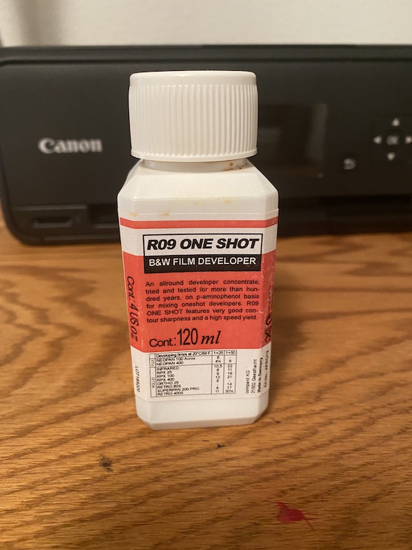

During my brief experience with "Compard R09 One Shot" (as pictured in post #3), it turned a dark nasty brown color in a relative short time after being opened. I was taking a university photography class, and the professor told us to use the R09 until it turned dark as coffee, then replace it. I dumped what remained of my first bottle halfway through the semester.

I have a bottle of R09 one shot (the Rollei Compard branded) from around 10 years ago that I used for a few rolls of film back then. I stored it in various conditions until I set up my darkroom earlier this year. Not trusting it to be any good I tested it compared to a fresh developer on identical shots on 4x5 film, and it worked correctly as far as I could tell. I have used it for some old rolls of film I had frozen after shooting years ago and they worked. Not sure how helpful that information really is but I am not complaining about having amore useful developer on hand.
I have the same which I bought almost 11yrs ago. About 1/5 left and last used it this weekend. Still works as expected despite being a heavy orange/brown and full of crystals.

ADOX Rodinal and ADOX Adonal are completely identical.
Both are the real original, last / latest formula / recipe which was used by Agfa before Rodinal production was stopped in Agfa's German photo chemistry factory.
R09 One Shot has a different formula. It is a 'Rodinal clone' made by a German photochemistry manufacturer for the company Compard. Compard has no own chemistry manufacturing.
They are only confectioning / bottling chemistry and distributing it.
If you want to have to 100% the orginal Agfa Rodinal characteristics, using ADOX Rodinal / Adonal is the way to go.

They have several different suppliers. Suppliers (and with them formulas and product characteristics) have also changed in the past with some products.
