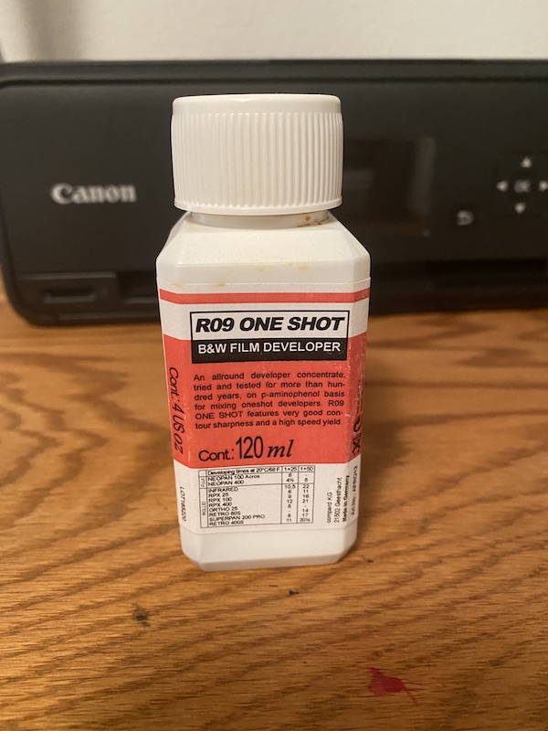

Does anyone know if these developers are essentially similar to each other? I understand developing 35mm Tri-X in Adox Rodinal, and the negs come out fine. But I had some iffy results in the past shooting Shanghai GP3 in 120 format that had been developed in a clone of Rodinal. It may have been called just R09, w/o Hotshot in it's name. It went bad quickly too, the bottles had issues.
Those Shanghai negs weren't really like Rodinal negs, just similar, and seemed to have less punch and contrast. But I was thrown off because the Shanghai film was 120 format and tended to be low contrast anyway. This is 35mm Tri-X that I have now, and w/ both developers in front of me, I'm not sure which one to go with.
If it is truly R09, it actually is one of the many (over time) versions of Rodinal.
In your title you refer to One Shot. In your post you refer to Hot Shot. What is your source of R09?
It's R09 One Shot:
