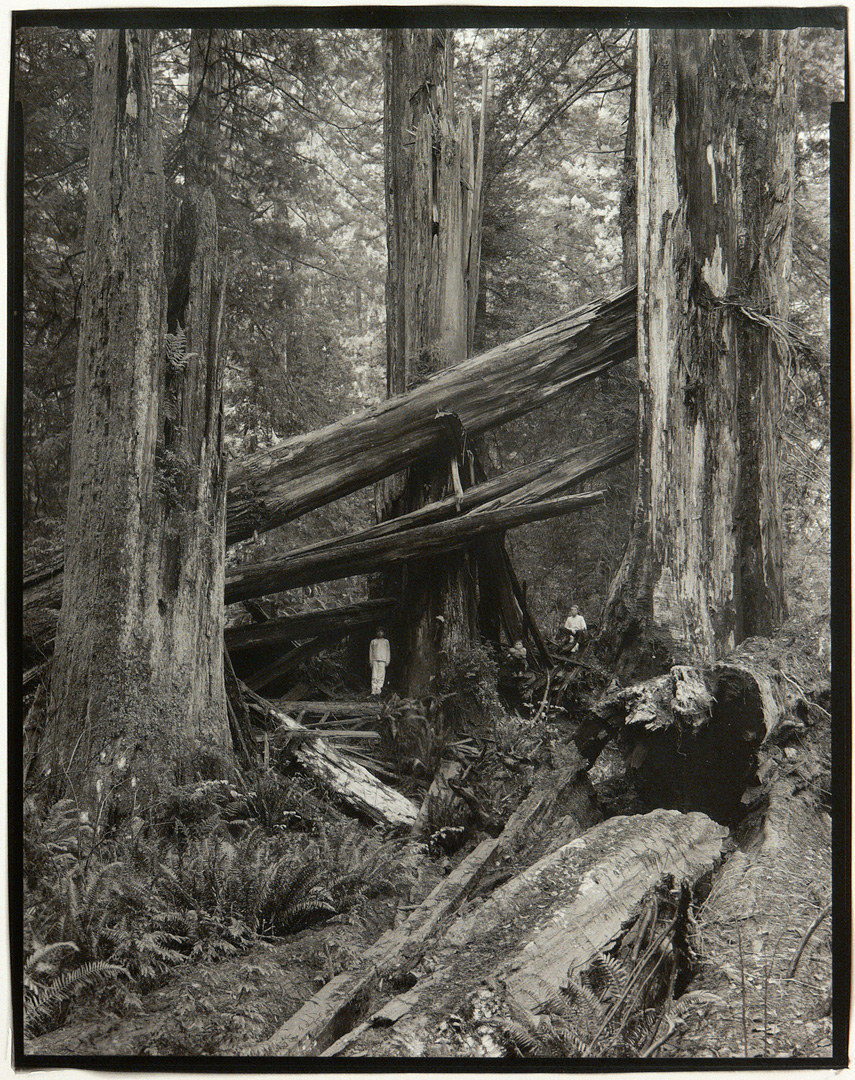

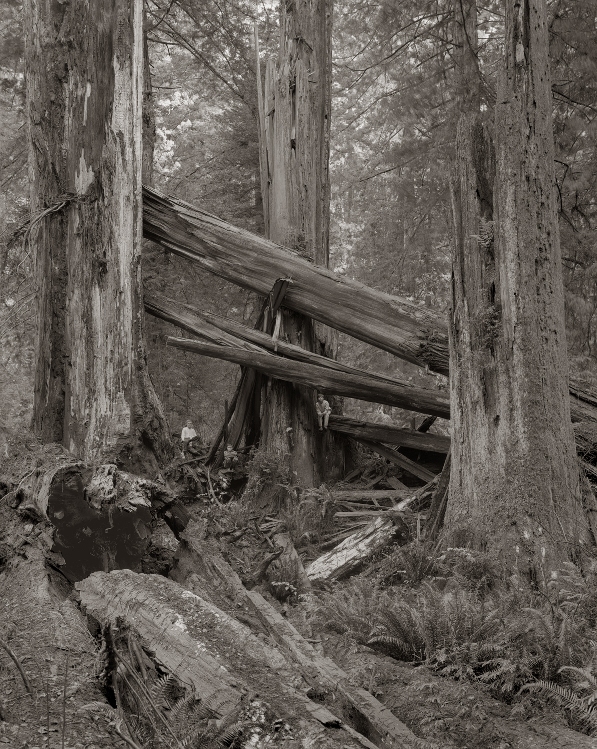

But I also will take the same image twice, then process the negatives for different printing processes (primarily platinum and carbon transfer). So there I am again being unprofessional and can't bloody decide on the spot...can't even (pre)visualize which process to use, let alone what it should look like or what it should convey from the deepest recesses of my heart. Disgustingly amateurist...
My three boys, New Years Day, 2008
Same f/stop: Right image (Pt/pd) 1 min exposure...Left image (carbon transfer) 2 minute exposure.
Just noticed some horrendous photoshopping at the end of the log with the pt/pd image. sorry...
