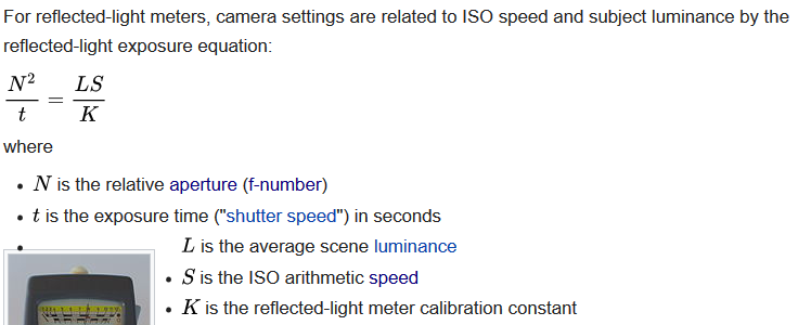

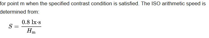

And neither does the Kodak document '...sensitometry_workbook.pdf', that assumes you have a focal plane meter calibrated in lux (well, actually I have a luxmeter somewhere, but the sensor is too large to fit in the focal plane of a 35mm or even MF camera). But the other document that you mention provides this equation:
and I should be able to compute the illuminance (lux) in the focal plane from the scene luminance L (cd/m2) and the f-umber N, thus relating lightmeter indications to lux-seconds.
Same Wiki article on lightmeters gives some interesting information on the gray card reflectance that gives consistent substitute for an incident light meter. Much better than what I previously read in some discussion threads, like, "white (100%) is zVIII, therefore middle grey, zV must be 100/8=12.5%". Btw, my Sekonik gives consistent incident and reflected readings when using a gray card measured to be 18%.

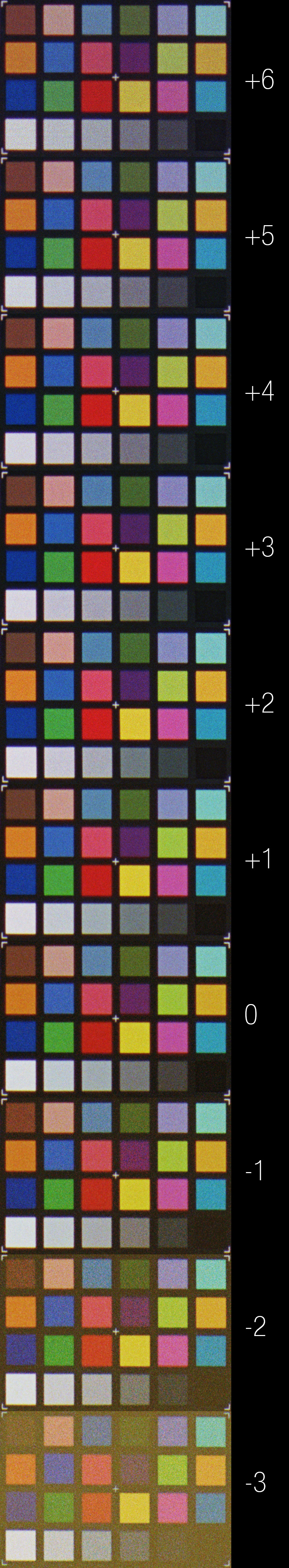

Here's a Colorchecker shot on Portra 400 at one stop increments from three stops under to six over and then scanned on a Noritsu. Density was corrected so that the middle grey patch D4 equates to 118 sRGB, but all scans have the same colour balance of the zero exposure so the natural colour shifts of the film are preserved. Under this workflow, Portra 400 gives orange shadows and magenta highlights. There is great room for overexposure although the highlights do start to compress at around 5 stops over. The brightest colour is at 2 stops over.
Sorry for the long image :smile:

Frank, do you shot C-41 ? just see the color checkers that are under your post !!!!!
Why overexposing ? Well, that color checker at -2 tells it... if your scenes have shadows at -2 you have a degradation there, but at +4 you don't have a degradation. So if your scene has shadows better to ensure that those are well exposed, because some overexposure in the rest of the scene won't harm.
It also depends on if you need film speed of not. Say that we shot outdoors in the sun with a VR lens at f/2.8, we may not need the film speed... then overexposing is feasible.
At the end it's about balancing exposure to get best results, but as overexposure does not harm (with portra / fuji pro) you may often want to overexpose to get a good depiction in the shadows.

When you have areas at -2, which is a pretty common situation, 1 stop overexposure is almost always benefical with porta and Fuji pro C-41. There are more times that +1 is benefical than the counter, if not needeing the speed, so overexposing +1 is not the rule but close.
Many Pro photographers that have been shooting C-41 says that.
Wow that’s great!
At +4, you may start to see highlights degrading instead.
ISO speeds are more closely related to highlight rendition than shadow rendition.
ZS speeds are more closely related to shadow rendition than highlight rendition.
For most viewers, un-manipulated prints or scans with poor (no detail) highlights look worse than prints with poor (no details) shadows.
If you want your prints (or scans) to come back from the lab looking pleasing, use box speed.

Matt, it is true, if overexposing an scene by +4 and highlights end at +6 then a degradation would be there.
But if we overexpose in a way that no area in the scene is beyond +4 or +5 then for sure we won't have any loss (with Portra / Fuji Pro C-41)
C-41 film has way more latitude in the highlights than in the shadows, as those color checker tests show, so very often the well balanced exposure is in the overexposure side, because we can get better shadows without damaging highlights.
