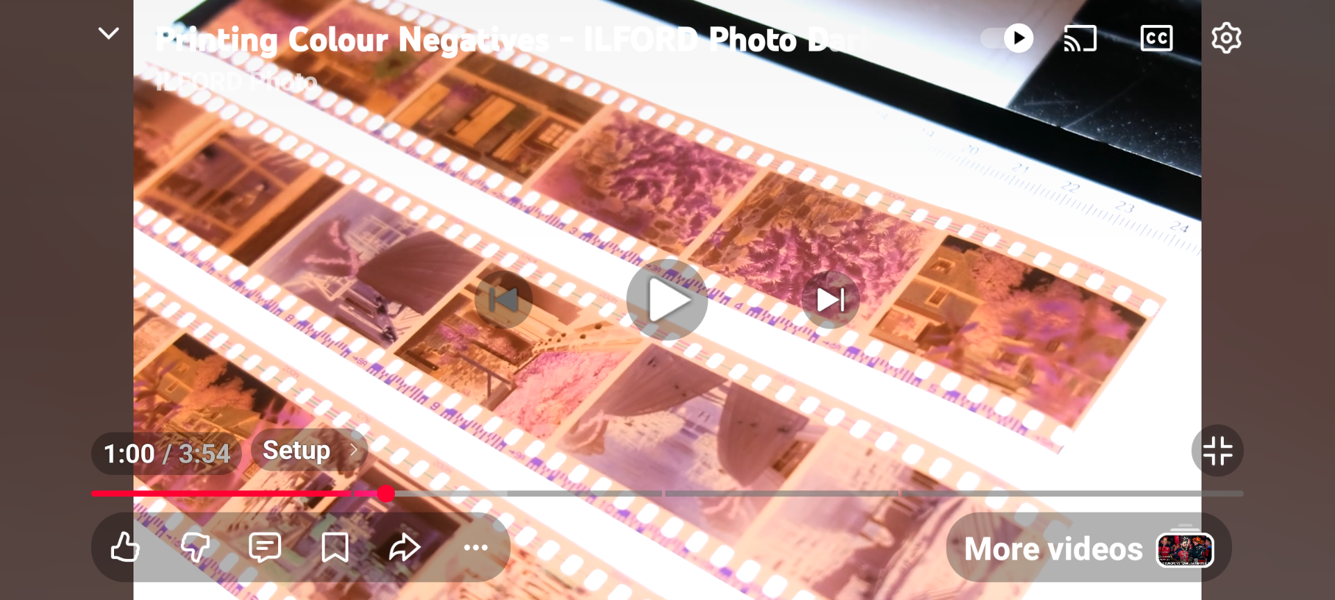

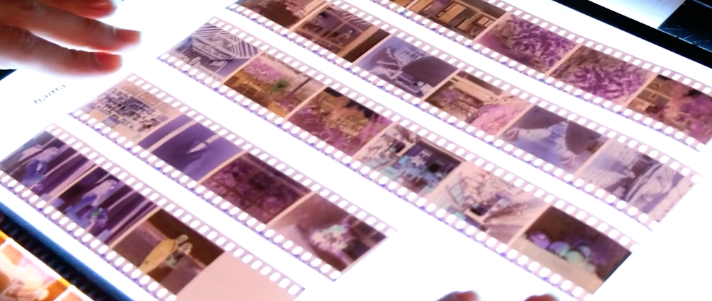

In the video they show strips of Phoenix (I) negatives.
I'm not sure what film that is, but I don't think it's Phoenix as that film was introduced in 2023 and the video is 4 years old. There's also a comment on that video from Ilford Photo in response to another poster's comment that reads:
Obviously we'd prefer it if everyone only shot our black and white films and stayed away from colour
That's probably not something Ilford would have said after the introduction of their own color negative film 🙂
In the video they show strips of Phoenix (I) negatives. That's a bit of an oddball because there's no orange mask to contend with, and contrast is far higher than on any normal CN film.
I hadn't noticed it was phoenix, I can see that maybe working a shade better, but I have seen others try with regular orange masked films too.

I was wondering about timing as well. The negatives shown do look like Phoenix at first glance. Probably some odd stuff.
Well, whatever it is, it's not a regular CN film:

I think the colour grading on that thumbnail is deceptive. The sheet she holds at the start a clearly orange masked. As are the ones on the light table

The gal on that brief Ilford flick made quite an understatement when she said the contrast might come out a little low. Color neg film originals tend to have far less contrast than black and white film, then you've got that orange mask to boot. Then, using VC paper, every tweak you make to increase the contrast by controlling the light color ends up skewing the native tonality of the original, chasing one's tail. Ole Panalure solved only half the problem. If my foggy memory serves me correctly, it never did have much contrast snap to it.
