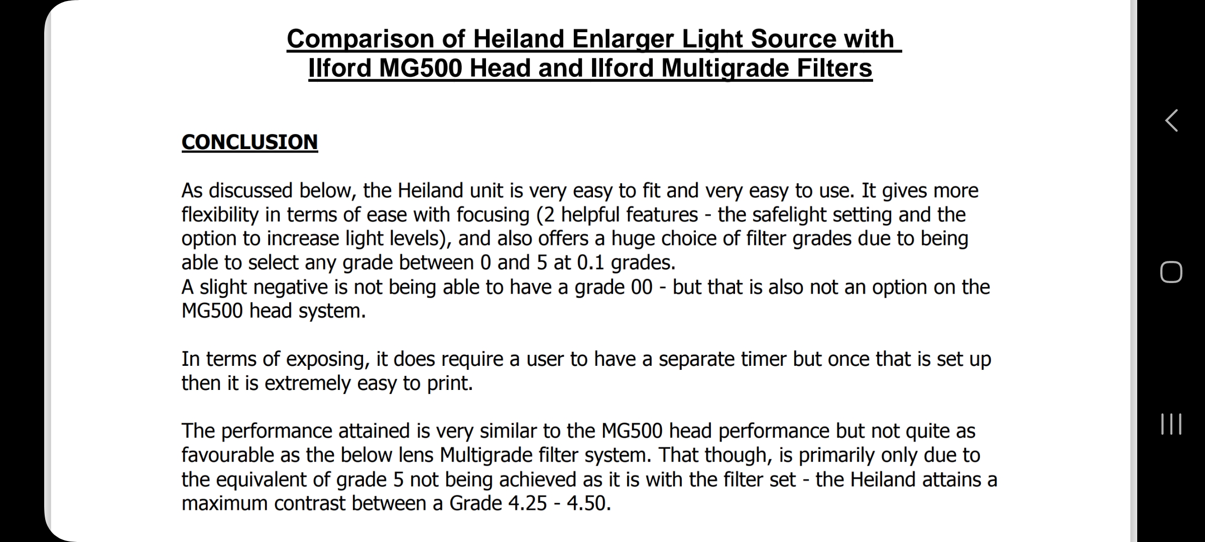

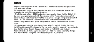

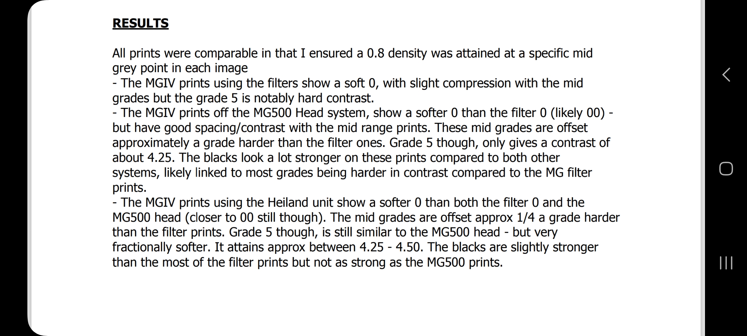

Ilford tested the Heiland LED light, its MG500 and MG filters and both the Heiland and the MG500 did not achieve as hard gradation as MG filters.
https://heilandelectronic.de/files/Heiland_Enlarger_Head_Report.pdf
But then at the same time I read how with addressable LEDs, where "ordinary" blue around 465nm is used, people have no problem achieving the same hard gradation as with filters.

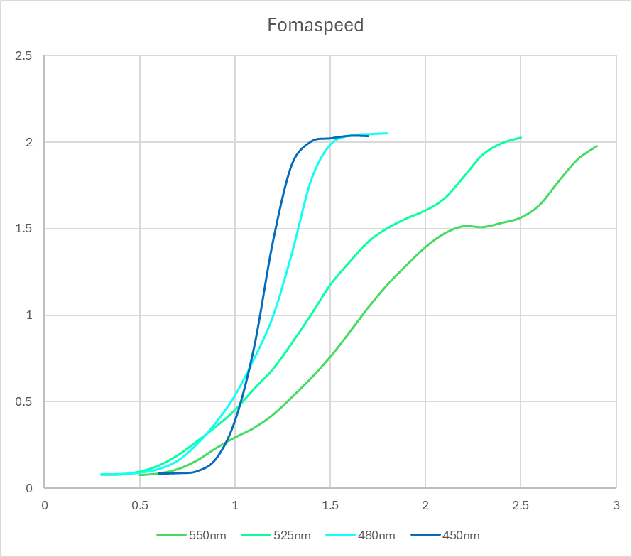

Above is a test I did on Fomaspeed paper with various wavelengths. Note how the toe of the (single!) 480nm wavelength exposure isn't anything like that of the 450nm exposure.
Also, in my interpretation/measurement, the highest grade was ISO-R 60, which is in my understanding grade 4.
Please do not misinterpret the plot above as a plot of various grades on this paper!!
So what's a "true grade 5" to begin with? It depends on definitions, as well as measurement methodology (which part of the curve do you use to determine ISO-R), as well as the paper you use, and perhaps a number of other things.
Now what, you might ask?

The report is from March 2017, when Heiland introduced a version of the LED source and controller on YouTube that looks the same as the one still offered. But maybe there was some fundamental change, I don't know.
By the way, Heiland has changed ownership and name, so I'm curious where they'll be heading.

FWIW, my Heiland head prints much harder than using filters. That is, the #5 exposure is much shorter than what I would use with an Ilford #5 filter. And the blacks are as intense.
