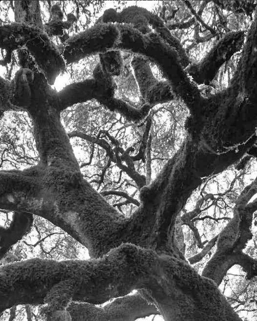

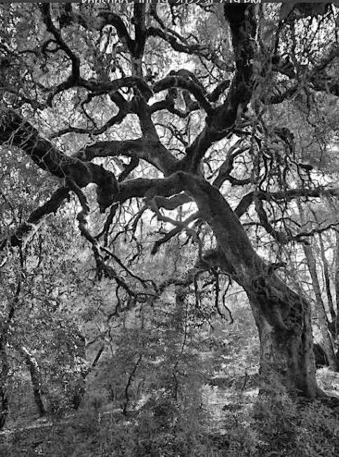

I was curious to see how much data is in the shadows and whether with these shots or more exposed shots you could bring it out better.
Originals by OP in post #28.
Wow. If you are able to pull out that much detail from low quality jpgs....
Yes the shadows do have detail. I've actually shot that scene dozens of times in various lighting conditions. I guess my problem is I'm unable to get a result that I like ... the tones just look worse and worse to my eyes the more I manipulate it. I can see couple responses that talk about the issues of trying to compress dynamic range which makes sense to me now.

A lot of detail has to be in the negatives if I could produce in a few minutes those results from just a screen copy of the OP's post.
With the original negatives, I'm sure someone like yourself could squeeze out a lot more in a darkroom. And a Photoshop expert could do similarly with scanned files of the negatives.
The point is the OP may have more in his existing negatives than he realizes and could try to work with what he has.
Seeing how much I was able to pull out myself tells me I was wrong in my other posts that the lighting was not sufficient for what he wanted to do. The details seem to be there in the shadows. It just needs a tender touch to bring out properly.
