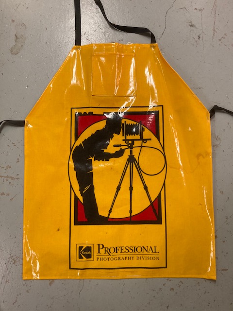

Matt, by any chance have you used the film apron as well? :smile:

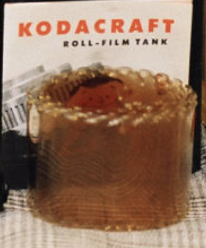

I started out doing the see-saw maneuver in the dark - yech.
I then went to using the Kodacraft tanks and aprons with 120 film and, for a short while, 35mm film.
They worked well, and were very helpful when it came to dealing with the fact that I lack dexterity and range of motion in my right hand.
Unfortunately, I have never located any of the aprons sized for the wider 116/616 film. They were made, and they would be usable with short lengths of 70mm film, but they aren't easy to find.
I have a Yankee ratcheting plastic reel tank that is adjustable for 616, but it isn't great when you try to load extremely curled, vintage 616 film on to them. The aprons are absolutely ideal for that - especially for 1.5 handed me.
I have an apron for 35 mm film in good condition but I haven't used it yet. Good to know that film aprons work fine, thanks Matt, now I am tempted to try. :smile:
