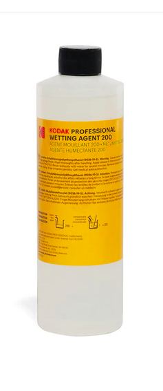

I just finished a litre size bottle of Calumet photo flo (after 20 yrs!) I have a single plastic Kinderman developing tank i use just for the purpose.....dipping the stainless reels. I just rinse the reels after hanging the film. We'll see if there's any change when i start using my vintage bottle of Kodak photoflo.
It is these sort of experiences that probably explain why Photo Systems didn't bother licensing the Kodak version of the name when they started producing the same stuff and selling it under the Kodak name :smile:.
https://kodak.photosys.com/collecti...dak-photo-flo-200-solution-16-oz-cat-146-4510
And also, you don't need to see-saw. Just slowly lower the film into a bowl or container, letting it curl naturally into the solution.
Matt, I don't see-saw the film in wetting agent. I was trying to describe very old school manual way of developing roll film without using reels. I place a bowl about ten inches in diameter with a very rounded bottom on top of a sigle step, about ten inches above the ground. I'm holding the film with one hand on each end and the drooping in a big U. I take the leader end of film and place it in the wetting agent with my other hand as high as I can reach and then slowly raise that end while lowering the tail end at the same speed, maintaining a loop submerged in the wetting agent. After the film passes through once, I hang the film in that orientation with the leader up. The film only passes once and a given section is submerged for one a second or two. This smooth motion avoids creating any bubbles and makes the solution run down the surface of the film instead of soaking in. Oh, and the emulsion side is toward the inside of that loop to avoid scratches.
My memory is throwing out more bottles of Kodak PhotoFlo than I can remember due to mold growth. This is my concern about it going into the emulsion. Any more I use a drop of Palmolive clear odor free dish detergent in about a liter of RO water left still for an hour. Never seen mold growing in that, I also use only RO water for all film processing steps including dev, wash, fix, and wash. My RO filter gives less than 5 ppm and I check it weekly.
I have never encountered mould growth in PhotoFlo concentrate - and some of the bottles I have seen are decades old.
That being said, if water gets into the bottle, then the mould can certainly grow in the water plus concentrate mixture - just as it will if you try to store "working strength" PhotoFlo.
The old glass with metal top bottles were fine unless the cap rusted.
The modern plastic bottles are just as prone to failure - i.e. sometimes, but not frequently - as any fairly heavy duty plastic bottle holding photo chemicals.
It is failure of the container that leads to water ingress, and resulting mould growth.
And I would never, ever use Palmolive or any other dishwasher detergent, because even the scent free stuff has ingredients that would be bad for gelatin.
I think my bottle of Kodak Photo-Flo is a collector's item and there is no mold. Goodness only knows where it came from, probably my uncle, but it still works.
I still use the one shown here - but I decant new stuff into it.
Nah. You win. I don't think mine is quite that old.
A very small amount of Thymol based Listerine can be added to stored dilute solutions to inhibit the growth of Saprolegnia water mold. But I neither store nor reuse diluted Photoflo,
and never never gotten mold in the concentrate. I do remember, as a beginner long ago, mixing up a large quantity of Photoflo and getting conspicuous water mold in that. You'd be amazed at what it will grow in, and the spores seem to be everywhere.
