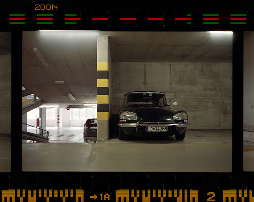

I know, but there are slim chances that I will want (more like be able) to figure out the filtration on the spot when I only want to spend 2 seconds on the shot. So, I just embrace it. 99% of time I even like it, in that weird, "it is what it is" lomo way...
For the rest, there's always a couple of clicks in PS...
Yes, it's a couple of clicks in PS, but wouldn't you be able to adjust filtration in your enlarger and adjust for fluorescent lighting? Or for tungsten for that matter?
In this case, no. If you would correct for fluorescent light you'd end up with horrible magenta/blue/whatever in the part of the image that is lit by natural light. It's not hard to correct for that in PS, much harder with enlarger.
Fluorescents and related abominable CFL bulbs do not have continuous spectra; so there is absolutely no way you can correct every anomaly, even in PS. Nor, in that scenario, can you correctly filter for all the problems. You are confusing simple color shifts with other
issues which will still remain after your PS tweaks. People have such low expectations of color neg film anyway, outside of portraiture,
that they don't even notice many of the anomalies which are in fact to a significant degree preventable under more suitable lighting and
better technique at the time of the exposure itself. Yeah, PS is great for stitching back together Frankenstein; but he still looks somewhat ghoulish even after PS.
Looks good!
Well put. It's hard enough to get the right filtration with daylight when making optical prints using an enlarger. Portra 160 is made for electronic flash, and the rare 5500°K daylight. Kodak Gold, Kodachrome is (was) more forgiving of color temperature.

On the green effect produced by fluorescent lights, I have taken a picture in my kitchen that has one such light without the FLD and it looked fine This was at night so no daylight outside nor with any incandescent light in the scene
However what I am trying to establish is what is the effect of such a filter in a shot where there is either daylight or normal incandescent in the scene also It sounds as if there is no correction possible that doesn't adversely affect the other light in the scene be that daylight or incandescent?
Is this the case? On this part about fluorescent light problems which isn't directly addressed to Drew anyone with knowledge of this problem and experience of solving or mitigating its effect without PS is welcome to contribute
