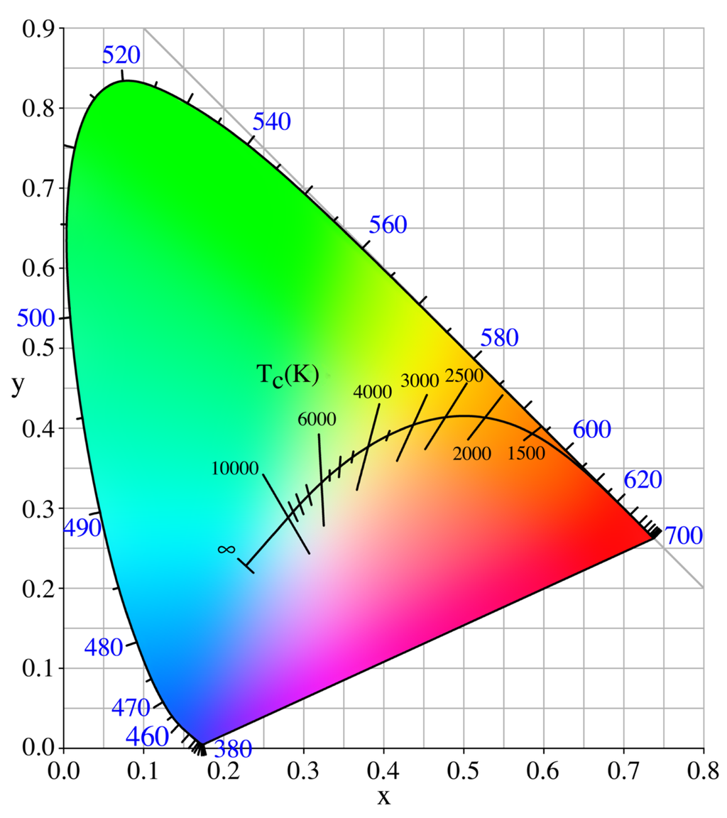

The color of the light source indeed has an influence on the picture. Ideally the light source's color should be located on the Planckian locus, i.e. the black body radiation (the black line on the chromaticity diagram below). Then you can correct it with the color temperature setting of your camera or RAW-processing software. If the color of the light source is not on the Planckian locus, you cannot correct the color cast by means of the color temperature setting. This is why the color temp setting cannot compensate for the color cast of color negative films.

See:
https://en.wikipedia.org/wiki/Black-body_radiation
https://en.wikipedia.org/wiki/Planckian_locus

See:
