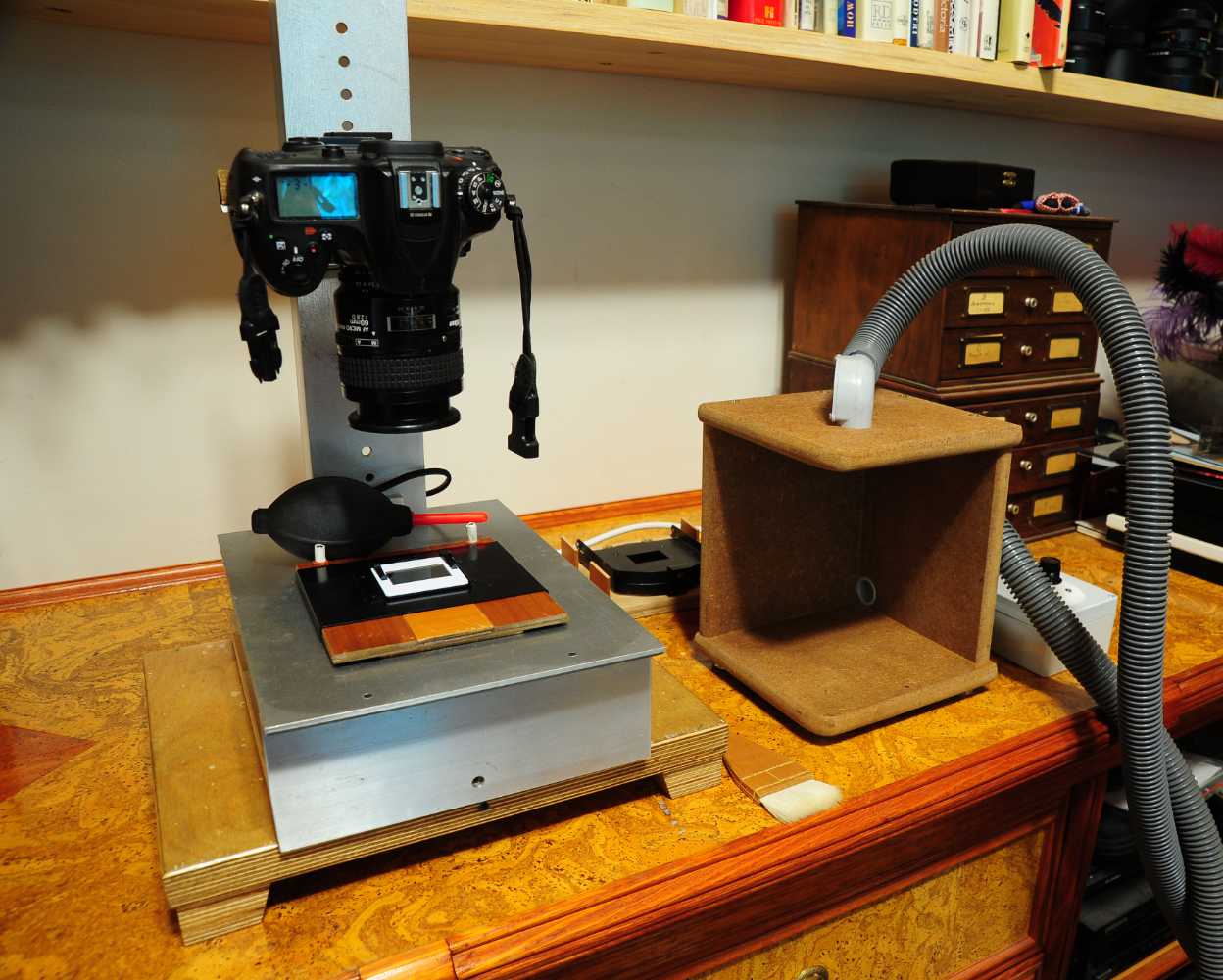

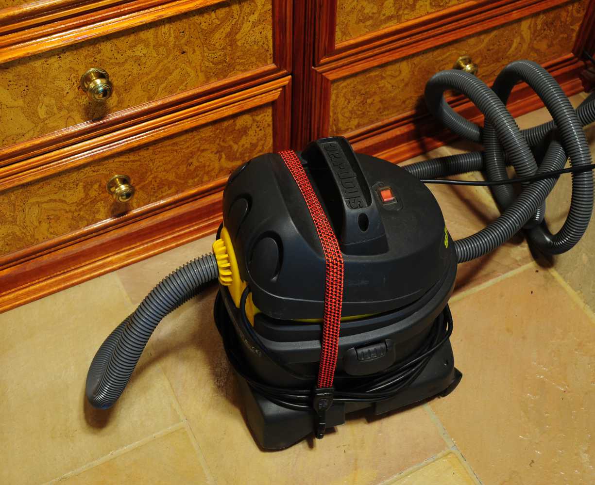

Can you post a photo of your vacuum cleaner setup?

Agree, sensor size (larger) offers no benefit to the copying process. My D7200 has an APS-C sensor and when combined with the 60mm micro-Nikkor offers a potential benefit by only using the central portion of the lens full frame image.
The box has an air outflow at the top and vacuum at the bottom corner. I regulate the flow intensity with an electronic controller. The filter unit replaces the simple filter that came with the vacuum cleaner.
Effectively, I have filled the chamber with a "toy stuffing" wrapped in a clean cloth material forming a set of close fitting pads.
Ran the unit per a short while to ensure its cleaning function was working and any loose material was captured.
The air flow from the top is combined with the action of a soft brush. To date, the unit has worked very well.
This is next level stuff.
