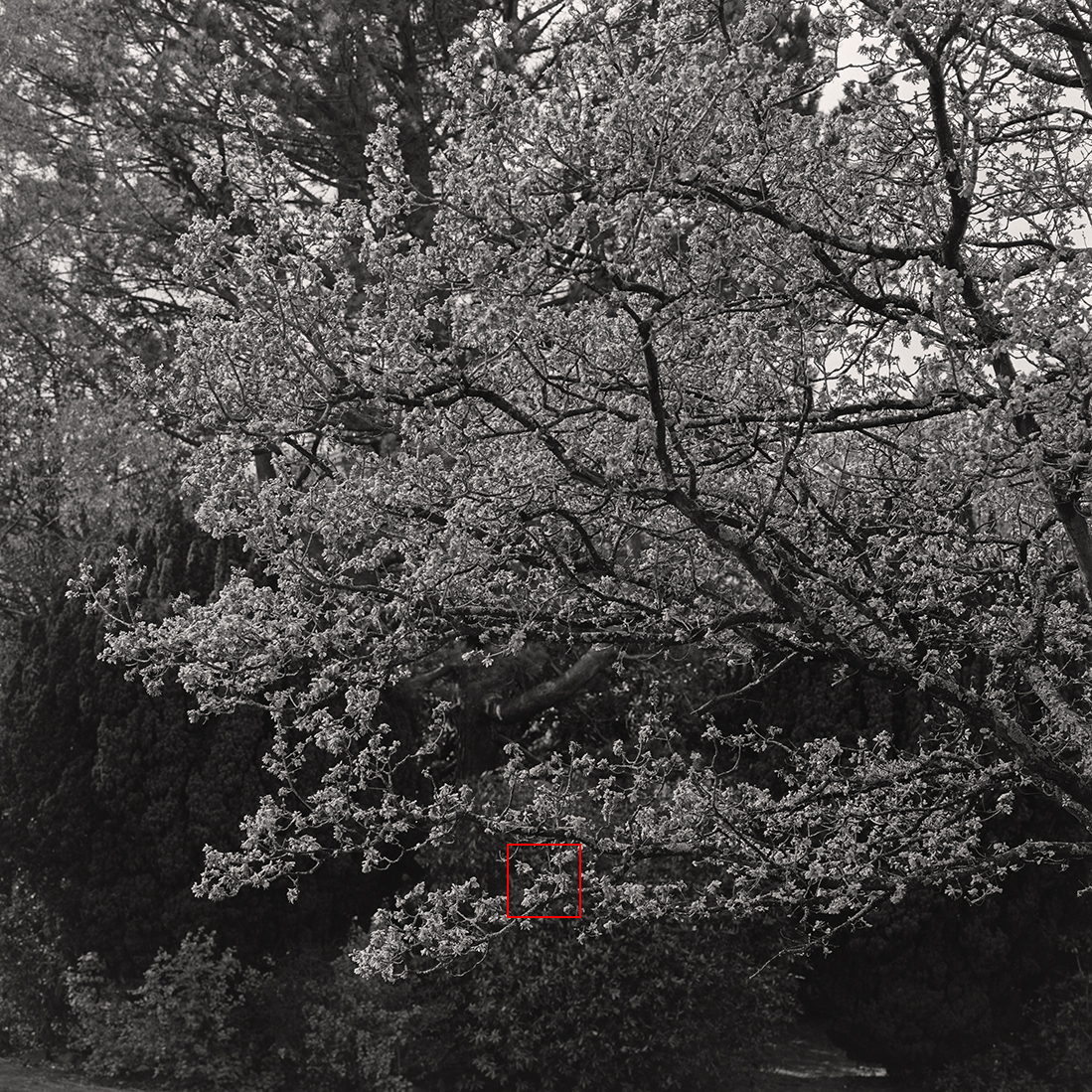

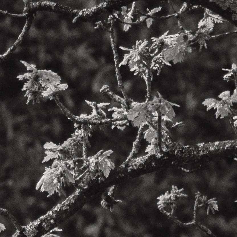

I rarely take it to that level, because of the amount of work involved, the huge file sizes, and the time it takes
Yes, it can be frustrating and time consuming to do multi-shot stitches, because of the issues I mentioned above. The results, however, speak for themselves. The following is an experiment using a 9-shot stitch of a 6x6 frame of Copex Rapid, which gave a 121 MP file (a 100% portion from the red box is shown):
The day a flatbed can do this is the day I eat my shoes.
