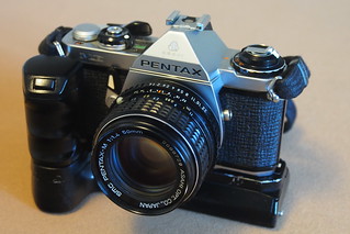

I have the ME with an auto winder, it's a nice small SLR without the auto winder attached. If I shoot in any kind of auto mode I prefer aperture priority. Similar to what has been said already, once you know how to manipulate the camera for over/under exposure and such you can do a lot with it.
Pentax ME by Bryan Chernick, on Flickr
