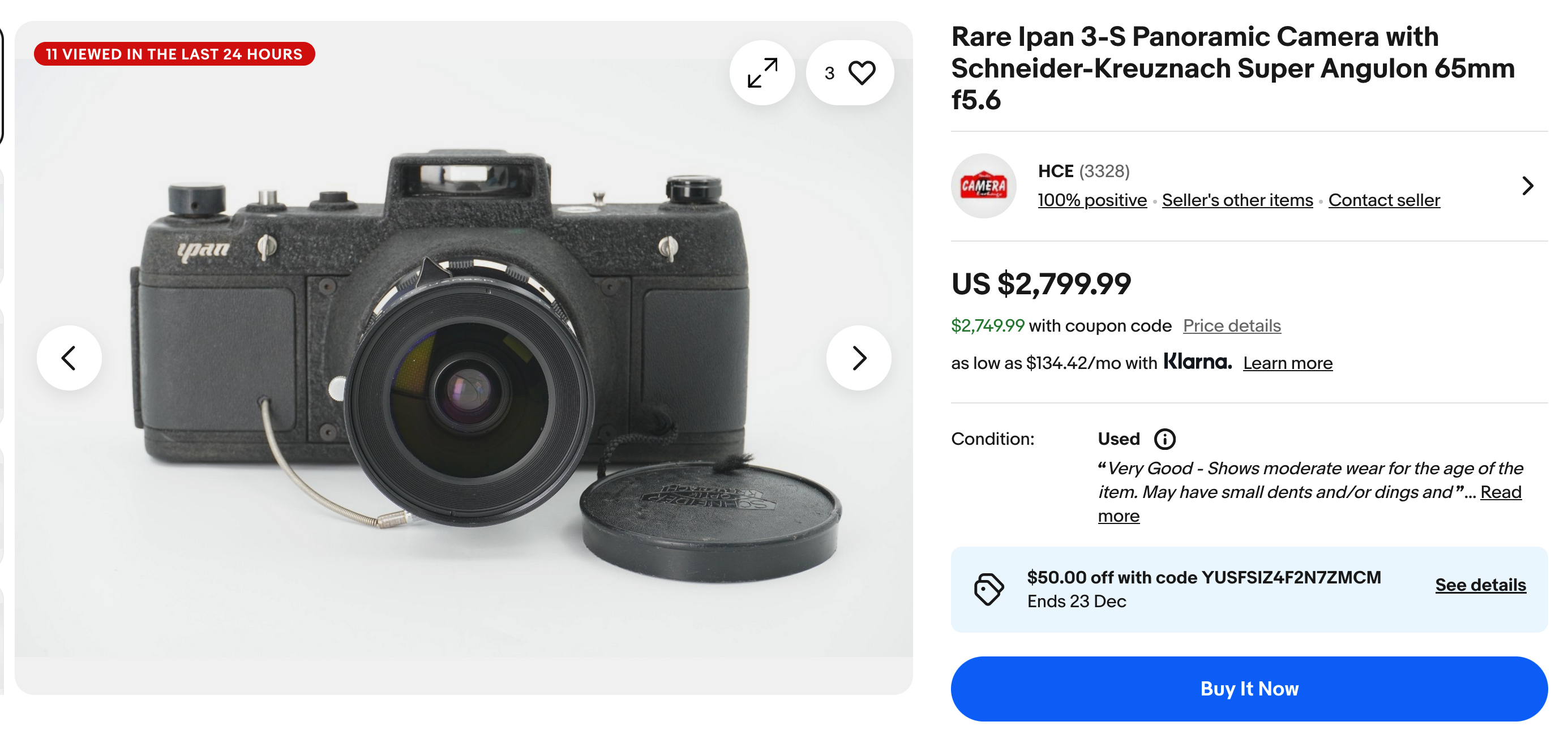

Here's one listed on eBay right now for about 99% less:
