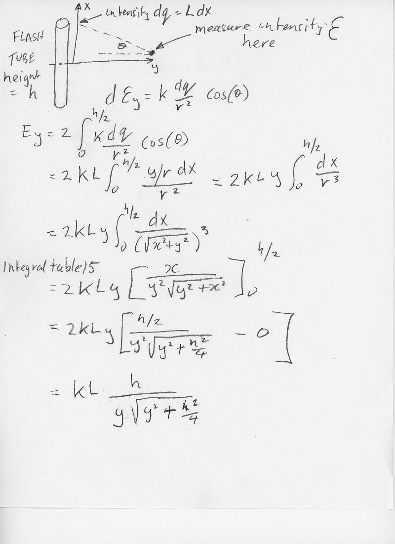

Referring back to the OP - it is a good question , relevant for macro flash.
I think the Gauss Law still applies, but you have to consider the source with real dimensions.
This can be done by the integral calculus -conceptually, by applying Gauss law to many small illuminated points.
I hope my scribble is legible. It is for a 2 dimensional "flash tube" - approximately OK for a thin rectangular flash
and could be expanded to a 3D flash reflector.
On the phone with Dad, can't read him your written stuff as I don't understand it, but he said he agress with what you typed.
