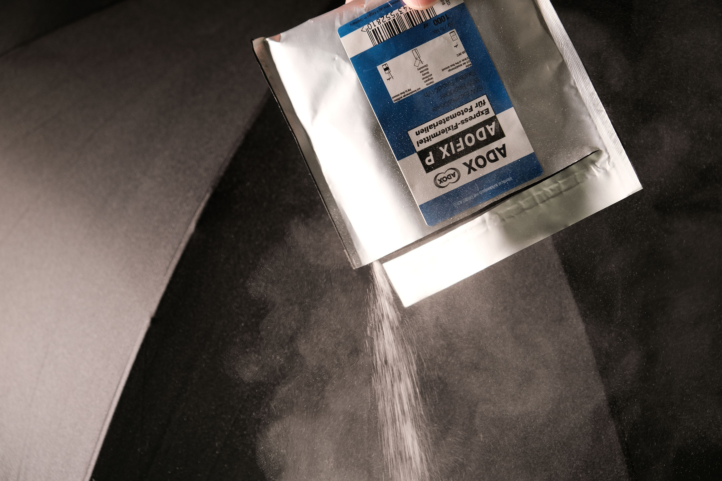

We started ramping up the powder production in our new factory. This gave us the opportunity to finally introduce our long researched and prepared ADOX CAPTURA dust binding technology.
The above image is without and shows how much powder chemistry is dusting upon mixture.
CAPTURA releases the photographer from having to smell and inhale chemical powders while mixing up photo chemistry from powder packaging.
The powder now looks and feels "wet" when it comes from the packaging but it is not. It also keeps the powders from clogging up.
CAPTURA is water solvent, biodegradable and has no impact on photochemistry.
We will be upgrading all powder products to the new technology and we are also preparing more powder chemicals.
