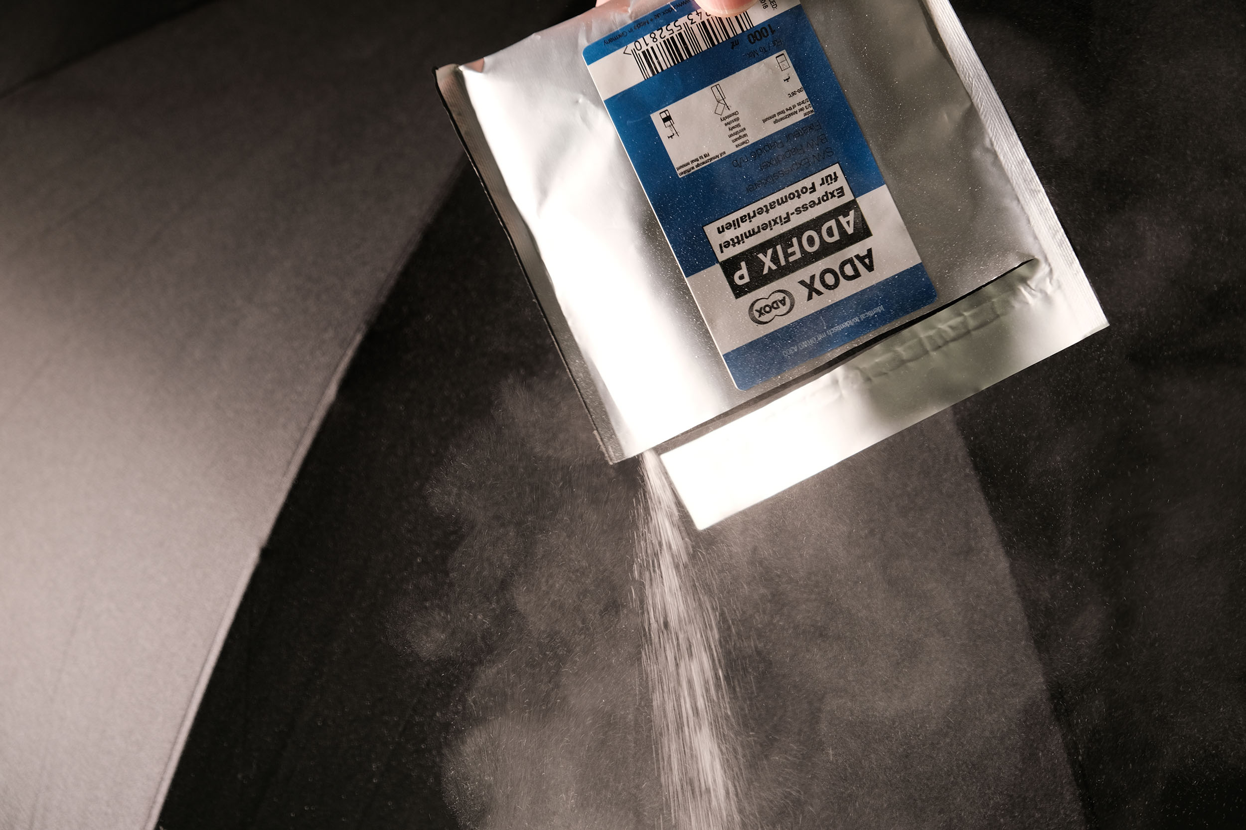

We started ramping up the powder production in our new factory. This gave us the opportunity to finally introduce our long researched and prepared ADOX CAPTURA dust binding technology.
The above image is without and shows how much powder chemistry is dusting upon mixture.
