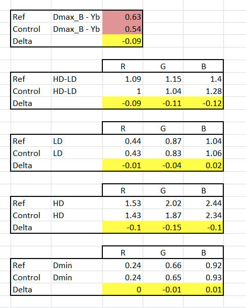

I finally acquired a color densitometer and scratching my head looking at my results. I'm using freshly mixed Flexicolor chemistry. The reference strip is above, my readings are below:
So it looks like my B values are pretty close, but R and G are too low. Fuji has a document called C-41 technical bulletin, their version of Kodak's Z-131. When I go through the troubleshooting/correcting actions table on page 28, I do not see a use case like mine.
Low/high temperature or low/high developer activity lead to the Blue value deviating first, which is the opposite of what I'm seeing.
Any ideas what's going on here?

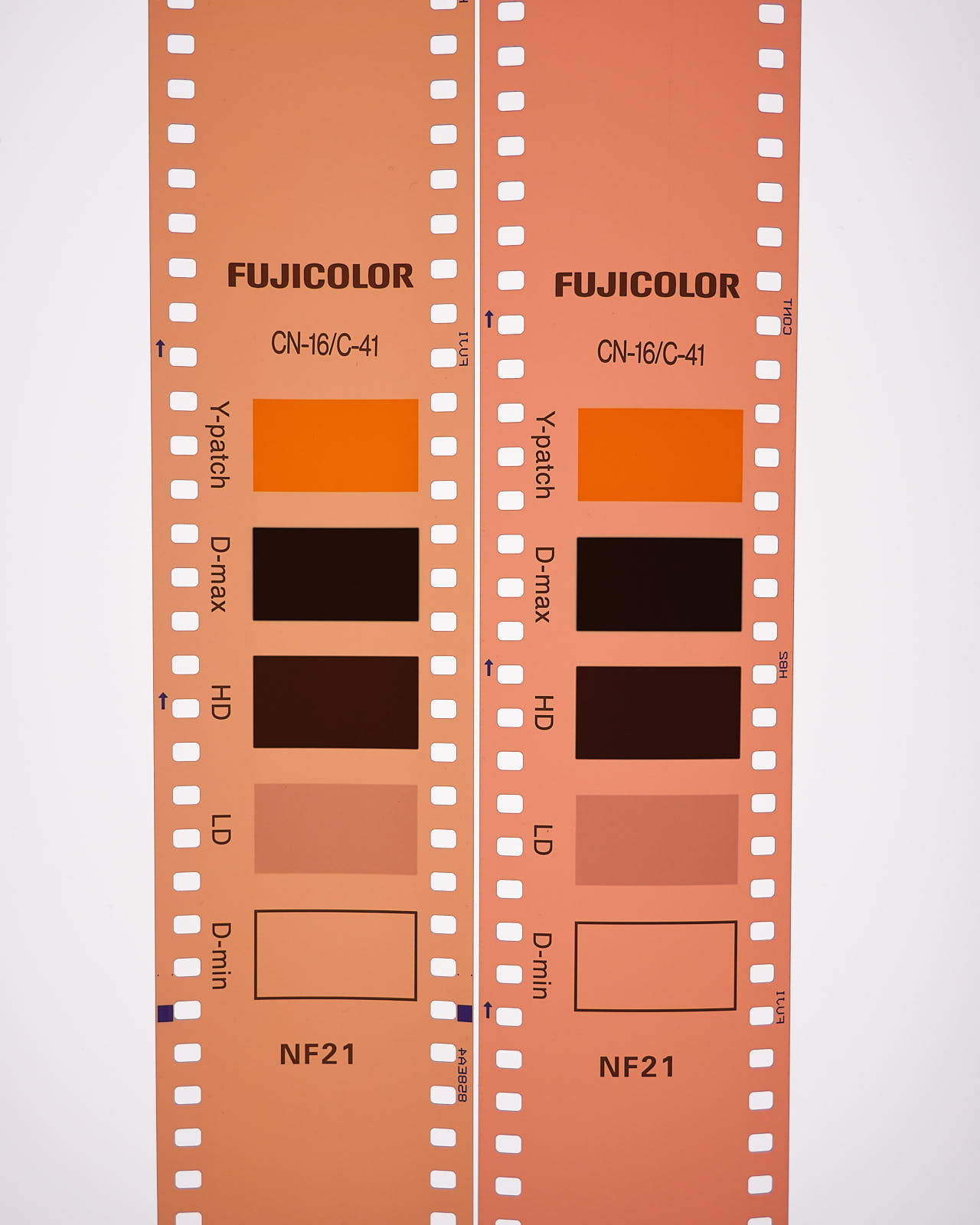

In case this helps, I'm posting a photo of the control strips on a light table.
Fuji reference strip is on the right. The one I developed is on the left.
The orange mask on the reference strip visibly has more red and less green in it. When I white-balance on the transparent area of the reference strip in a RAW converter, it reads 150/150/150, my strip reads 145/161/150.

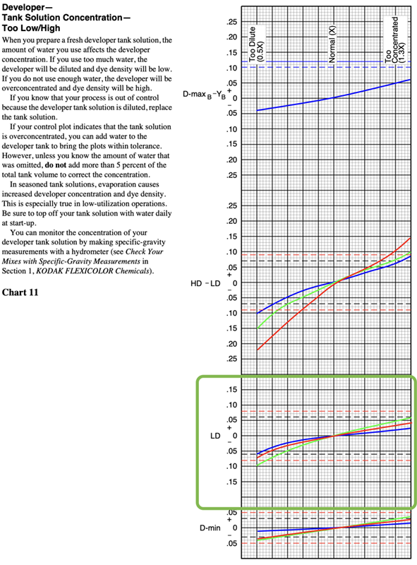

Since everything seems to be on the lower side, I'd start with increasing the developer concentration a bit.
Otherwise, reading the Kodak Z-131, middle layer (G) going more astray than B and R in LD parameter doesn't seem like a thing that couldn't happen.
Sure, it would be ideal if your Dmin measured parameter would track well corresponding to the Chart 11 (Y and HD-LD seem to track well), but it may not be that you need to adjust only one of your developing parameters to get all the parameters within spec...

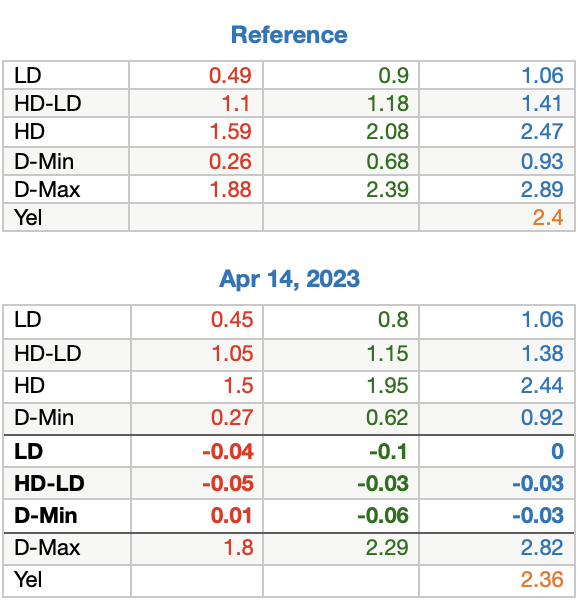

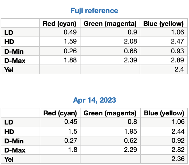

Quick update: I have played with temperature some more. By raising it by 1F I was able to land within spec, but the green and blue continue to maintain a solid density gap vs red:
And the orange mask in my strips is never as pink-ish as the control strip. The LD numbers describe the difference perfectly. At this point I am giving up, and I am questioning the validity of my approach of using Fuji control strips with Kodak chemicals.

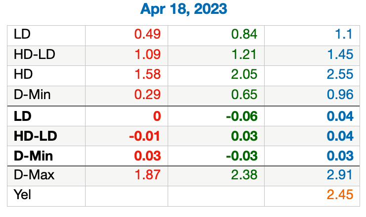

Interesting... you're also seeing the pattern of the weaker green. TBH I am puzzled by this, but I am no chemist. How is it possible for the middle layer to be the most problematic?
Steven, the two strips look pretty close to my eyes. Maybe they aren't as close as I think they are and the differences are clearer to others and are enough to give problems with the finished article?

@pentaxuser You can use color picker to sample the mask to see what I am talking about. In terms of practical implications of staying within control limits, I can only speak to the hybrid workflow. I do not wet print, but it should be obvious that correcting color problems stemming from development errors is easier digitally. However, even when working with CN scans, color balancing is just easier when film is developed perfectly. Tools like Negmaster give me a better starting point.
