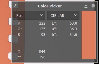

A tool in Photoshop or similar image editors that allows you to examine RGB values of an image area.
@pentaxuser
Exactly. As here, e.g. in GIMP:
Applied to the right-side strip in Steven's earlier image of both test strips:
Note RGB values in top left of the dialog.

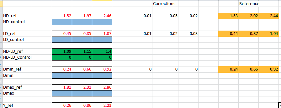

Most test strip packs should come with a paper insert with the densities listed for the test strip . If you loose that then you can use the reference strip and read the cells with your densitometer. The paper is useful also to verify your densitometer as you should get similar values as provided on the reference paper.
-Eric
-Eric
Yes i mean i get a paper with tolerances but not real densities, it's supposed that i have to read the test strip and suppose the densities from test are going to be the densities of my developed test +- tolerance from the paper.
But is there any nominal densities around?
Thank You
These are the values of my Fuji C-41 strip. Columns are not labeled but are R/G/B from left to right. Values on the far right are with corrections applied. This is from my densitometer so depending on your calibration your device may yield a different value.
