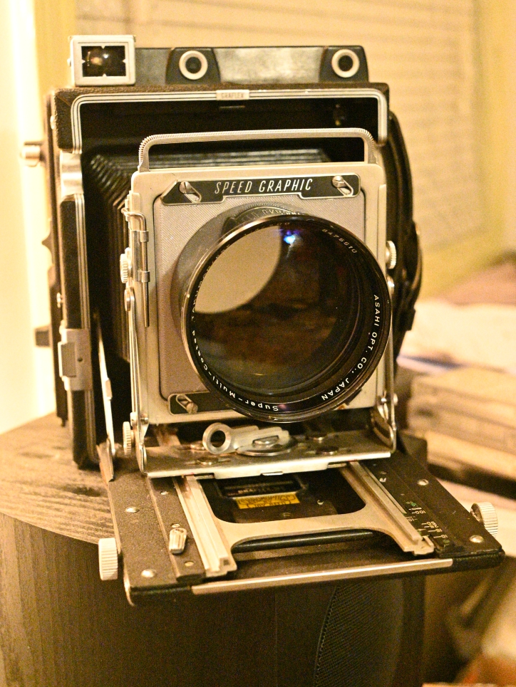

The aperture mechanism in my old-style Pentax 67 300mm f/4 was misbehaving, so I disassembled the lens. It turns out that the front elements are a single unit that can serve as a barrel lens for 4x5". Seen here near infinity focus.
The focal length in this configuration is a tad longer than the standard 135mm and seems to be at least a stop faster. Could it be the poor man's Aeroektar?

The SMC franken-lens just covers 5x7 at infinity with increasing coverage at closer distances / longer bellows draw. Are you able to use barrel lenses or do you need a shutter?
I could use barrel lenses, I just can't decide how much goofing around I want to do. I think I have 34" draw to play with in 8x10.
Upon some further reading it seems that SMC 300mm above is optically similar to the 400mm of the same era (i.e telescoping, not the later internal focusing design). Presuming the lens construction is also similar, the front group of the 400mm would likely provide somewhat greater coverage than the 300mm. A deconstructed 400mm f/4 would probably yield something like a 200mm f/2.8 with poor 8x10 coverage at infinity.
