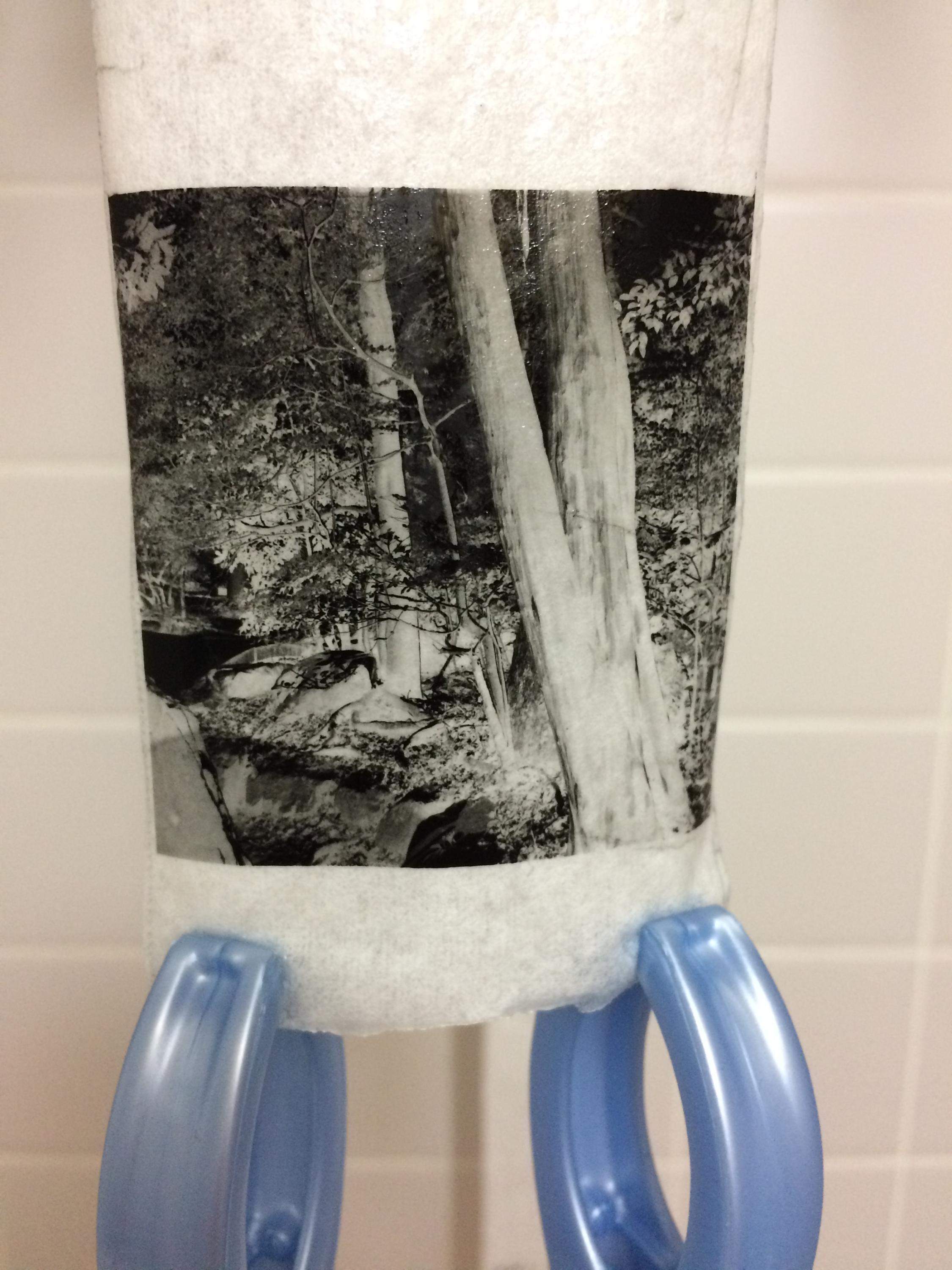

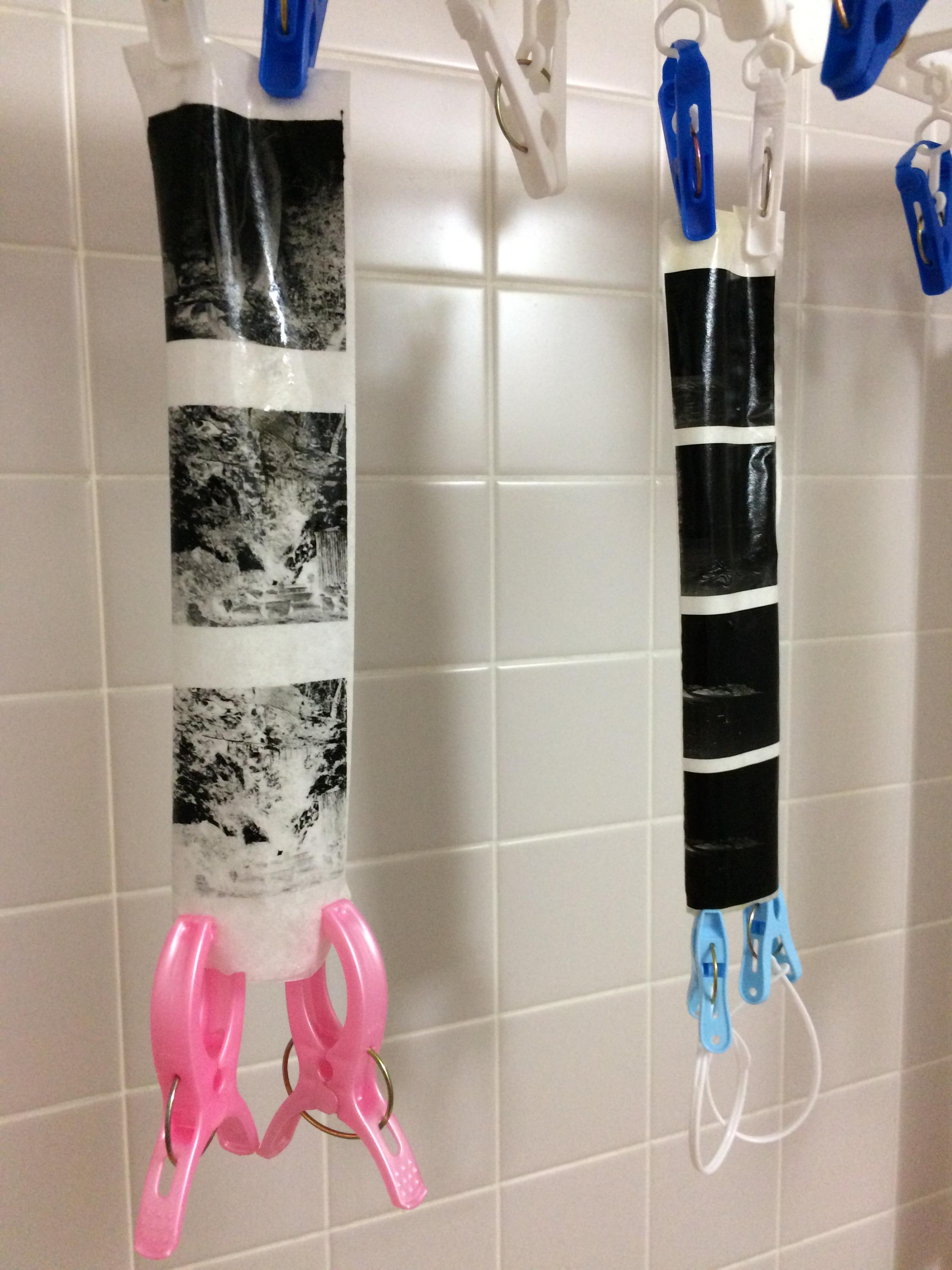

I've dried the film normally, cutting it into strips beforehand (at the fixing stage) to deal with the massive curl that seems to occur when hanging the entire 120 roll. So, I didn't have curling issues but it twisted a bit as it dried - as you can see from the photos below I found it hard to find a way to hang the negs in such a way that they would stay relatively flat and not buckle. To get completely flat negs, after they were dried and spent a couple days under heavy books, I put them between pages of blotting paper and ironed them and they look great. The one issue I don't like is the frill on the edges, just outside of the emulsion area - I want to find a way to eliminate that. One of my rolls did not get fully exposed (not sure if it is because of user, camera, or film error) so I dried that bit of film on a piece of glass, as I was curious as to what it would happen, as I know washi paper is dried on flat boards and thought this could work too. It did dry extremely flat but parts of it stuck to the glass (!), but I may have had it emulsion side down. In any event, more experimenting needs to be done.

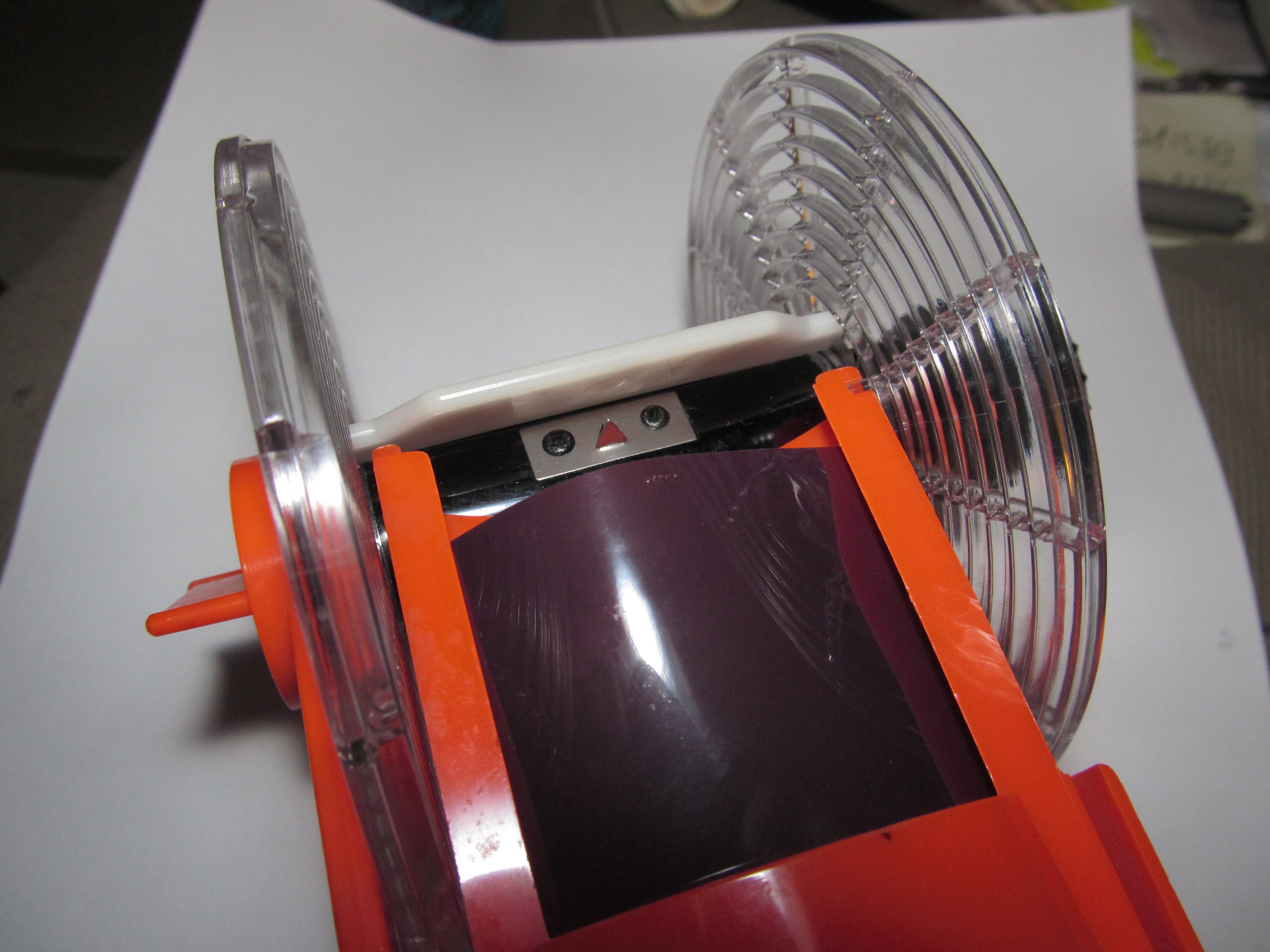

0.08mm if i dont err. from the producer. i have also the thin Agfa Avipan 200 PEO(0.06mm) beside the normal one PE1 0.1mm. i remember very well loading thinner than washi-film (0.08mm) to jobo 2570 reel(70mm/172cm/220 lenght). Old trick is cutting the corners of film
-tongue.
Agfa Avipan 200-filmthickness PE1(0.1mm), PEO(0.06mm)
http://www.gommamag.com/v4/downloads/data/006_page/agfa_other/aviphot_pan200.pdf
It must be checked in which cameras this thin thickness (0.08mm) could be a problem. a) transport-problem when autodriven b) filmflatness.
i want to join 2x 120 into a 220 one. and remove paper. have added 0.1mm tape anyway to filmpressure plate of kiev60 to improve film-flatness.
and 220-film-usage. tip from bayerfoto.de
have not yet found out why one cannot mount into standard reels. HP-Combina-reels have a thorn at the axis which can be reached with a loader.
so no problem using that tank. 35 and 120/220-reels available. didnt yet test 220-lenght.
