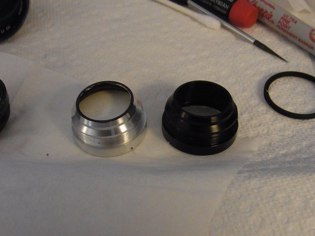

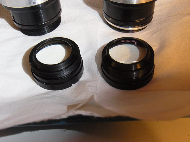

If you want to know which Jupiter-3's use Schott glass, just unscrew the fixture for the rear triplet. If the threads are on the front that screws in, and it has a guide ring around it, look like these two- it is made using Russian Glass. If it does not have a separate fixture, it has Russian glass and was made after 1962. The type of glass is important to the design, properties such as index of refraction and dispersion are important to the fundamental design of the lens. The Schott glass used on the Wartime Sonnars, and the post-war ZK and J-3 make them some of the best performing Sonnar formula lenses ever made. The wartime Sonnar has better edge-to-edge performance in terms of flatness of field compared with the Jupiter-3+.
"Schott Glass, Russian Lenses, And A Jupiter 5 Do Over"- What is a Jupiter 5???

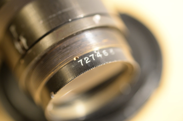

If the rear fixture of your J-3 has numbers like this,
It is really a German Sonnar with a J-3 name ring. Do not think of it as a counterfeit J-3, you will find it as good as a Wartime German Sonnar.
If the threads are towards the back of the rear fixture, it has German glass in it. The shape of the rear triplet was changed.
The Jupiter-3's with German Glass have less field curvature than those that followed.

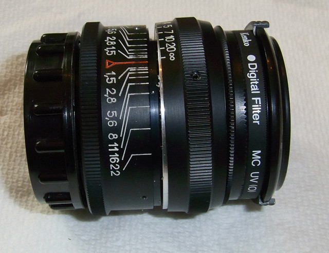

Filings left in the lens, found on more than one of these.
Whoops. I guess he missed the first time.
Glad I put the scribe to mark the correct one.
And the Helical could not drive the lens to infinity, mount had to be ground down and helical repositioned.
After all that, new taps for the focus ring, add almost 1mm to the shim, and taps for the aperture- works well. Nothing 12 hours can't fix.
