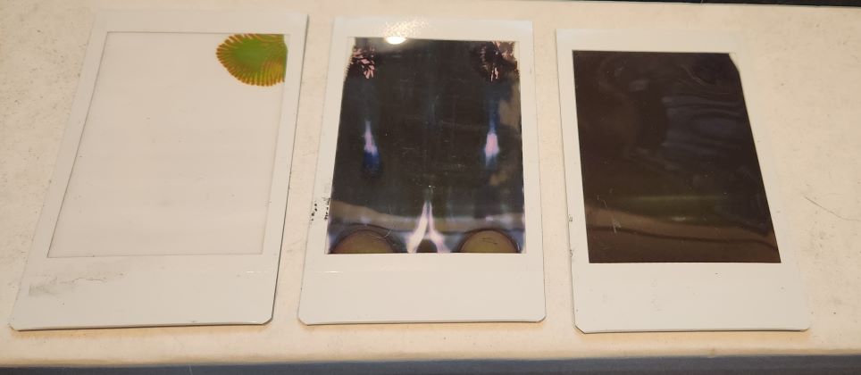

I tried a two test shots today. Neither came out but I wanted to share results here for science purposes and possibly as an example of what not to do.
I am using an older unbranded wooden holder that came with the Busch Pressman.
I tried using the filmholder without modification.
It was tight, and I think likely burst the the development pod.
I am processing by manually feeding the instax through the rollers of an old Polaroid 600.
There are three exposures in the image below.
White wasn't exposed in camera. I pulled it out and exposed to light to have one to dry fit into holders and to send through rollers as a test. Not sure what I did to upper right corner.
The two following were both shot in camera, but I think the pod had burst before exposure due to pressure in the holder.
I am going to try shooting with the instax inverted, pod up, tomorrow. I am trying to avoid having to modify the holders because I still use them for sheet film and paper negatives.

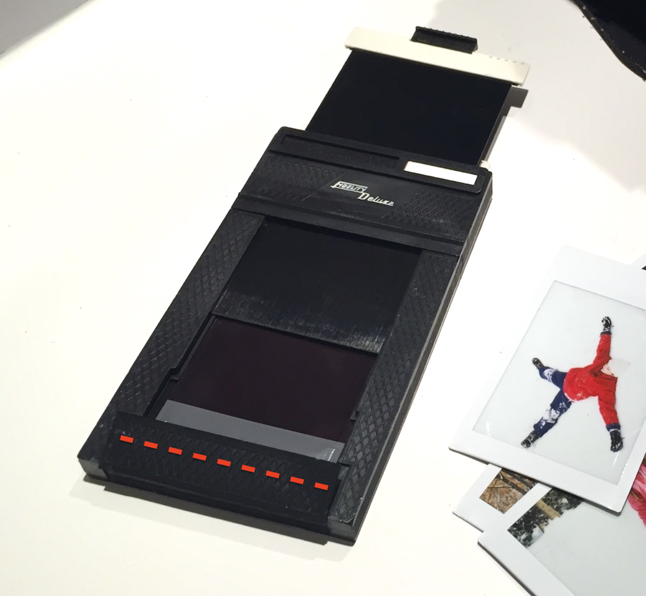

I might suggest modifying the flap and using an Instax camera for the development.
I have exposed perhaps 100 Instax films in the Fidelity film holders. In fact, I recently got two more NOS holders. Now I have five, enough to hold a ten-pack of film at once.
This thread was started in 2017 and all these years I have not bought a dedicated Instax film back for my camera because the bulk and the film plane offset outweigh the advantages. Not to say I won't ever get one, though.
