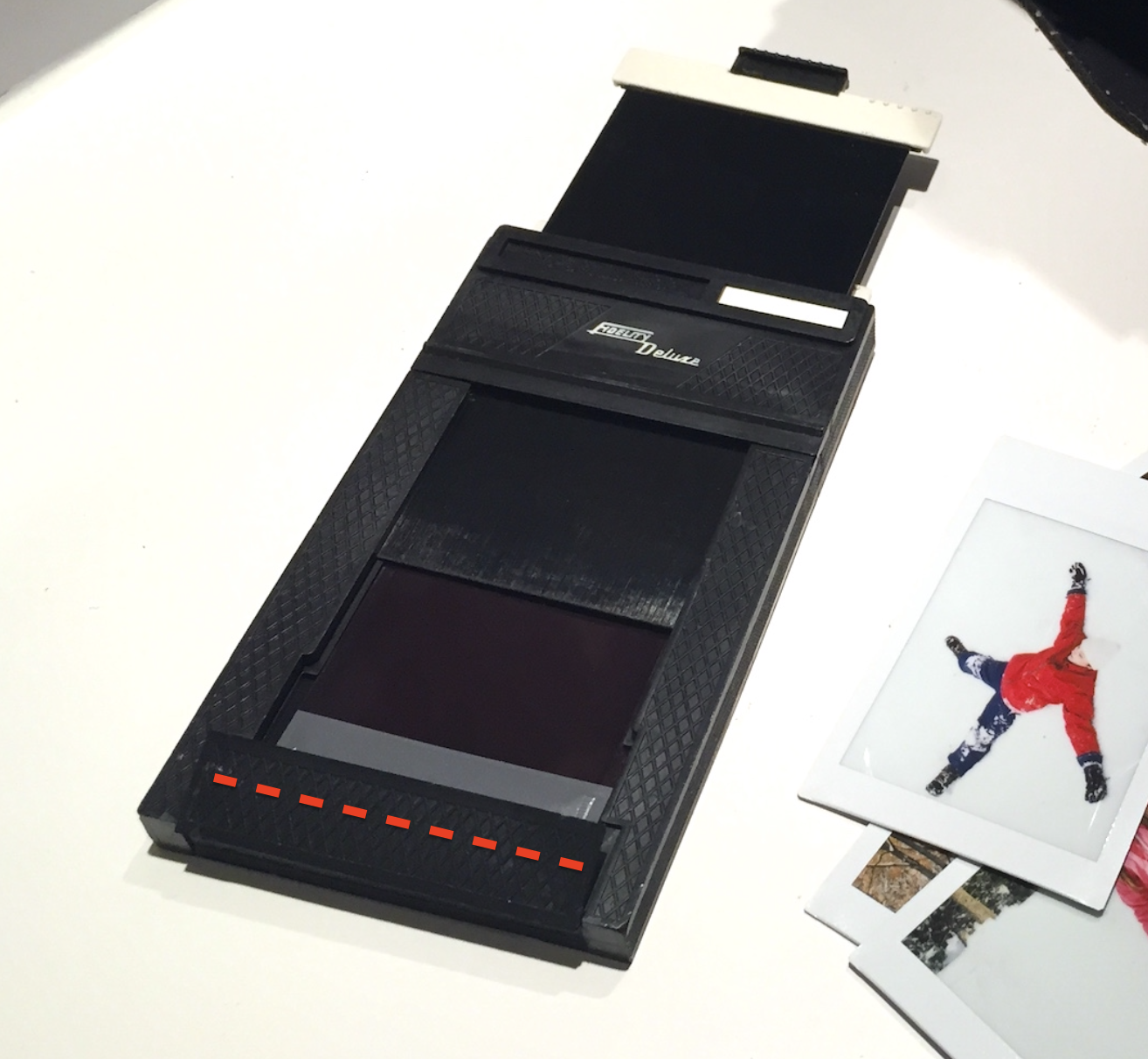

I finally found a use for my tiny film holders. The Instax Mini film fits well enough to make exceptional images (not blurry , light struck junk).
Caveats:
1) The Fidelity Deluxe 2 1/4 x 3 1/4 film holders need to have the flap at the bottom trimmed. Needs to be trimmed just enough to clear the processing bubble, yet still allow the dark slide to engage and hold the flap closed. The scrap of the first one I cut (by eye) measured 8.5mm when I checked. When cutting the flap on the other side I left even more of the flap so it would engage better, and that scrap measured 7.6mm.
2) It is a little challenging getting the exposed film back in the Instax cassette. My trick is to push out an un-exposed film just a few millimeters, to open the trap. Once the trap is open, slide the exposed filim OVER the unexposed one and push them both back in. The issue is the flap, as it closes, catches the junction of the image area and paper on the viewing side of the film as you try to push it back in the cassette. Maybe the safety flap can just be removed from the cassette.
Otherwise it works perfect! So well, that my 'Instax Graflok Back' conversion is on hold.

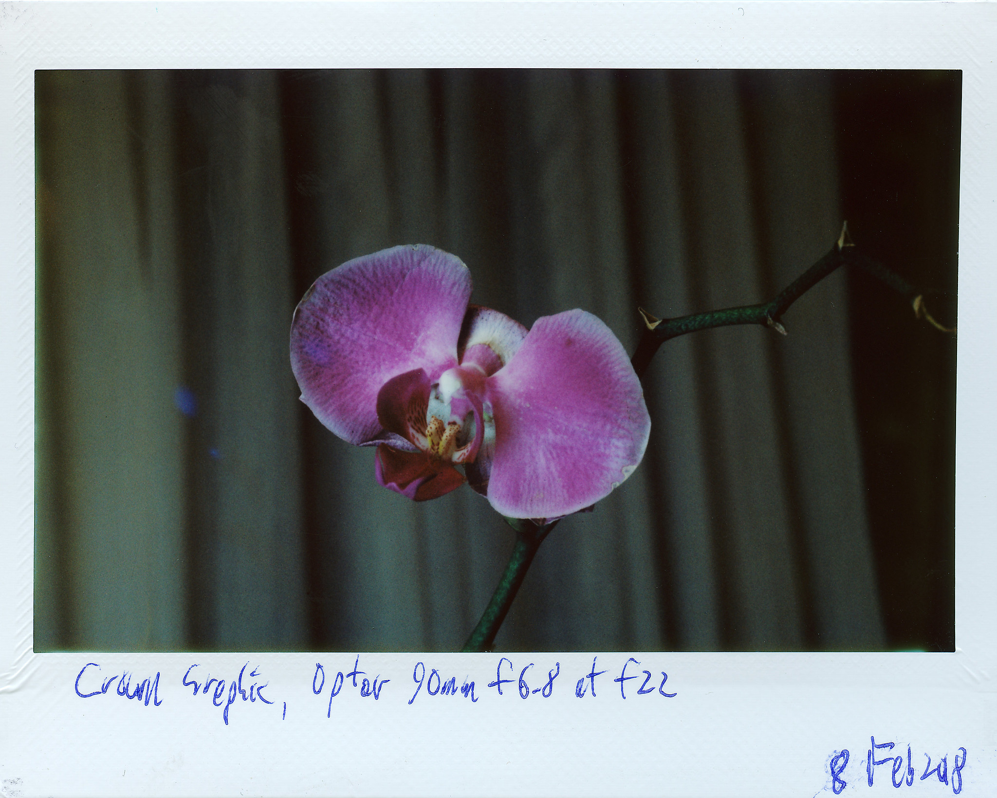

It works!
Orchid on Instax by Howard Sandler, on Flickr
It works!
That looks great. Can you share more details. That is, did you buy an Instax camera to use for processing, or did you already have one? Which camera did you get? Any other details to share?
I just did a brief portraiture project and did the some 'proofs' using the little Instax in the 6x9 holder. I used a dark-tent with the Instax camera in the tent to process the films while the subject waited. A little more cumbersome than the old peel-apart packs, but still not unreasonable.
I'm 100% B&W so I have no stuido lighting appropriate for the Instax color films, so my indoor-non-flash images are yellow, as expected. I see you have color corrected lighting. What kind of lighting did you use (or is this daylight?).
I bought a used Instax 300 for "developing". I actually shot most of a pack with it, and it's more ergonomic than I thought, though still basically a crummy toy camera. If you tape some tissue paper over the flash you can do decent close up exposures. Its shutter and fixed aperture don't allow proper exposure in full sunlight, but auto with flash is good for indoors at 2m distance, which is probably the main use of that camera. The orchid photo was lit with a daylight-balanced fluorescent softbox I have and I did not correct colour, specifically because this was a test run. I only adjusted white and black points globally, not per colour. From the very slight blue-green tint remaining of the paper, I would prefer to balance the highlights a little warmer after scanning. A straight linear reflective scan looks to my eye very much like the print. Overall, the orchid shot is probably 2/3 stop underexposed. This was very close up for the 90mm lens on my Graphic and I was just guessing the bellows extension factor.

Can OP post a photo of the mods done to the film holder? I have a few Fidelity Delux and non Delux holders and would like to see what modifications are needed.
I don't have any pictures, but what I found is there was a little ridge on the flap that would press down on the pod. I used a hobby knife to remove the ridge so the flap can close without touching the pod. Not all holders may have this issue. Does your flap close without touching the pod?
Don't have any pods yet, I'll let you know when I get some Instax that fits the holder.
So I got some Instax Mini and tried to load them into my Fidelity.
Can't get it to close no matter which way the film is loaded. Still unsure what to do to modify the holders.
On my film holders there was a small ridge under the flap in the area of the dotted line. I shaved that off so the flap closes without touching the development pod.
