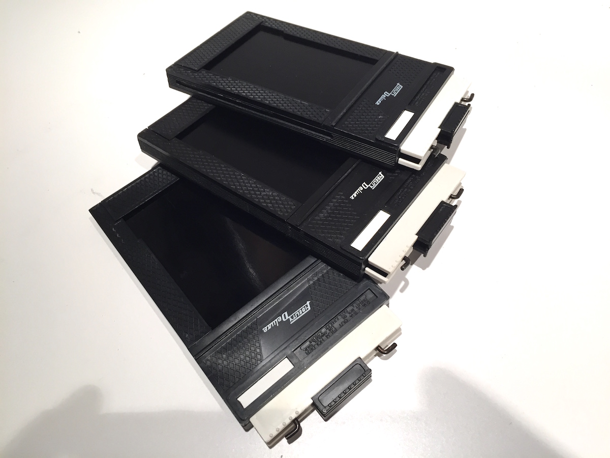

I received two more beautiful Fidelity film holders today. Now I have enough to hold six Instax films.
I removed the little light trap/flap on a spent Instax cartridge. That makes re-loading very simple.
The way I'm working is to remove all the Instax film from a cartridge and put the film in a light-tight 4x5" sheet film box. From there I load the film holders, just as if I were using sheet film.
After exposing the film in the film holders, I load the film into my Instax cartridge and put that in the Instax camera (in the dark because I don't bother to replace the darkslide on the cartridge. Then I can turn the lights on and process the film by covering the lens of the camera and spitting the film out one-by-one.
Compared to shooting with the Instax camera, it is more cumbersome. However, compared to shooting sheet film, this method is a thousand times easier.
