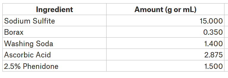

I'll throw my recipe into the mix - I can't remember where I sourced mine, but it was definitely an "Instant Mytol" recipe rather than just "Mytol". I adjusted the recipe down to make 250ml of stock strength solution (which I guess is supposed to be essentially equivalent to XTOL stock). Just enough for a single roll of 35mm in my Nikor steel tank. I can just open a "capsule", toss it into 250ml of water, and stir for a minute or so, and then use one shot.
I absolutely love this stuff for Delta 100 and HP5+ in 35mm and 120. Extremely fine grain and full film speed or better. Tons of resolution.

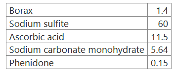

Seems to be the same as the one Koraks posted.
Yours, for 250ml
or Koraks' for 1 litre:
looks like 4x yours. (Easy for me to recognize, since I always mix 250ml of 1:1 calculated from that second recipe, and it is pretty much 1/2 of every bit of your recipe.)
It's entirely possible that I got my recipe from Koraks originally. Been a couple of years since I started playing with Instant Mytol, and IIRC he was there helping me answer a lot of questions up front.

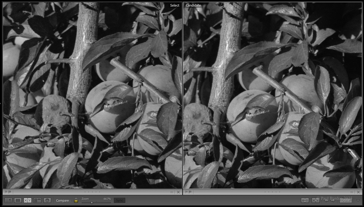

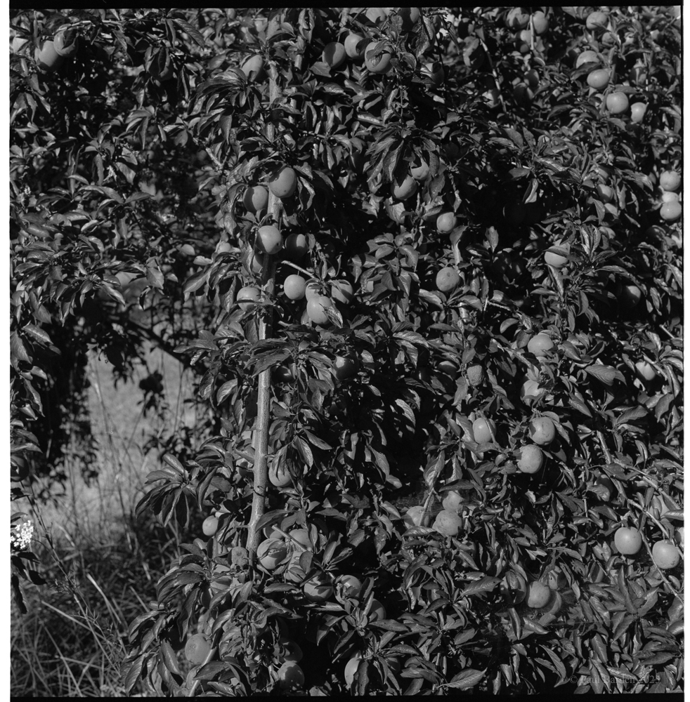

A bit tangential, but I'll add this bit of data: yesterday I exposed a roll of FP4+ (bracketing exposure by half stops) and developed half the roll in Xtol 1:1 and the other half in another Ascorbate developer, FX-55. In theory they should both act similarly, as both are Phenidone/Ascorbate developers.
I scanned the results this morning, and there is no perceptible difference between the two sets of negatives. The CI is virtually identical, and the grain structure and sharpness/acutance are identical.
On the left is the FX-55 image and on the right is the Xtol image. These are unaltered scans right out of the scanner — no sharpening, no processing applied. This is a 66% magnification of 14,000 x 14,000 pixel scan from a 2&1/4" negative. The camera used was a Rolleiflex 2.8E Planar, and these two images came from negatives exposed with an aperture of f8 @ 1/125th.
Full image here:
Good example. There is little enough sulfite in FX-55 that it would be there only for its other effects and not for much impact on grain.

To my eyes the FX-55 has a very slight edge in perceived sharpness. Could very easily be a matter of film flatness in the scanner, or wind during the exposure, or any other tiny confounding factor, rather than developer differences.
In real world terms, identical.

My eyes are not the best, but it looks that way on my monitor also. I had to blink five or six times, but every time FX-55 looks just a bit different. The tonality is the same for sure. I'm curious to see how your comparison goes between Mytol and PC-512.
Most likely it's because the shutter speed was 1/125th and it was quite windy, (I tried to wait for things to calm before exposing each frame) so there may be some motion blur in some frames.
I chose FP4 because it is so flat when dry, so there shouldn't be any issue with scanner focus. I might scan one of the other Xtol frames and see if it looks any difference. I suppose it's possible that FX-55 might not have the same grain solvent ability that Xtol has, due to the lack of sulfite.
