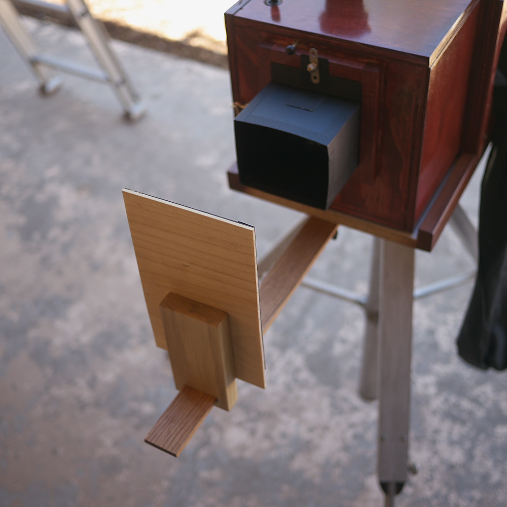

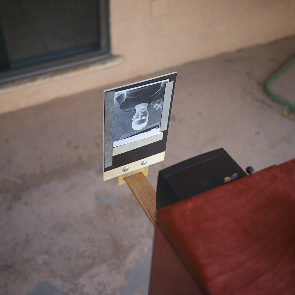

This morning I finished building the optical printing frame, a wooden extension that bolts to the underside of the support base, which carries an upright sliding plate whose front surface is covered in a rubber magnet sheet, such that a paper negative can be mounted magnetically in front of the lens.
P1100014a by jvcabacus, on Flickr
P1100013a by jvcabacus, on Flickr

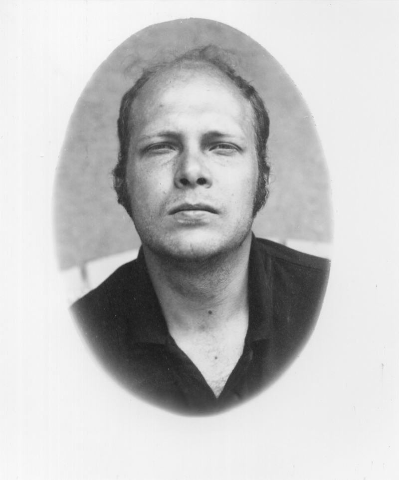

Another update of the Instant Box Camera project. I worked this week mainly on my optical printing technique, where I set up a printing easel in front of the lens and rephotograph the grade 2 paper negatives onto Ilford MG RC WT Luster paper.
I made some reference lines in the easel using drafting tape, and now I can accurately position the over mattes, focus the negative and compose much quicker. I was able to do a complete portrait session, from posing to exposure and development of the negative to setup, exposure and development of the print, all within 15 minutes, which is one of my goals for making this project practical in terms of public portraiture.
I was experiencing inconsistencies between my metering and the resulting exposure of the prints, until I realized that I was standing in front of the easel, blocking part of the indirect light, during the printing phase. And so I changed my technique to, after loading the film holder with paper, close the inner door and remove my arm from the sleeve, then stand behind the easel to make a final meter reading and operate the shutter.
I also made three different magnetic oval mattes with which to mask off the paper negatives, using rubber sheet magnets covered in adhesive vinyl film. One mask is black, rendering a white mask on the print; the other is white, rendering a black mask in the print; and the third is gray.
I also decided that, since I've gone this far with the project, it'd be worth my time to begin using my modern Fuji 135-5.6 lens, in place of the aged WWII-era Kodak Ektar 127-4.7. This means I now have a modern, accurate shutter, and that I can make sub-second exposures, and thus use wider apertures, for portraits where the background is more pleasingly out of focus.
Here's a reprint of a negative I made during that 15 minute session, this time printed lighter (I'm using a grade 3.5 contrast filter behind the lens) and using the black mask. I used the Fuji lens for both the negative and the print, F/8 for the portrait itself and F/11 during the printing.
The bottom edge of the oval matte is softer because of the shadow of the matte itself; the matte and negative are placed upside down on the easel, so the image is exposed right side up on the print.
Hunter001a by jvcabacus, on Flickr

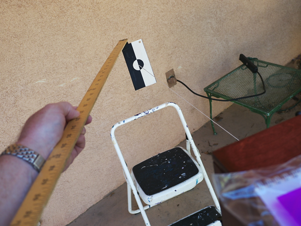

I did a self-portrait session today. To focus my image properly, I employed a focusing target attached to the camera's support base via a string.
I first adjusted the tripod height to center my face on the lens as I was seated on a stool, then adjusted the stool fore/aft to make the string tight with the target adjacent to my eyes.
Next, I taped the target to the end of a wooden yardstick, and was able to monitor and focus the image on the ground glass, through the camera's rear door, while holding the string taught via the yardstick.
Then I loaded up a paper negative, closed the arm sleeve door and seated myself on the stool, target in my left hand and shutter release cable in my right. I pulled the string tight, positioned my face to the target, lowered the target and released the shutter. Exposure was f/8 for 1/4 second, at ISO12 on grade 2 RC paper. I should have exposed it a bit more, by adjusting the aperture down a bit from f/8. But the highlights aren't blown.
After processing and a few dunks in the rinse water, I squeegeed off the negative using a film squeegee, flapped it dry, then mounted it to the printing easel with a gray oval printing mask. The print was made with a grade 3.5 filter onto Ilford MG RC WT luster paper, at f/8 for 3 seconds, rating the paper at ISO1.6.
Overall the process took about 20 minutes. It would have been shorter, but I had to deal with focusing, and my grade 3.5 filter fell into the developer tray; I had to quickly rinse it off and dry it, then fixed it to the front of the lens via gaffers tape instead. I'm going to make a holder to mount these on the outside of the lens. The dyes on these printing filters are not water-fast, as my rinse water turned pink after I tried rinsing the filter off.
Here's an image of the focusing target affixed to the yardstick:
P1100060a by jvcabacus, on Flickr
Here's how I held the focus target up to my face (but actually using my left hand - in this shot I was holding the Lumix G5 camera, LCD screen folded out, in my left hand):
P1100061a by jvcabacus, on Flickr

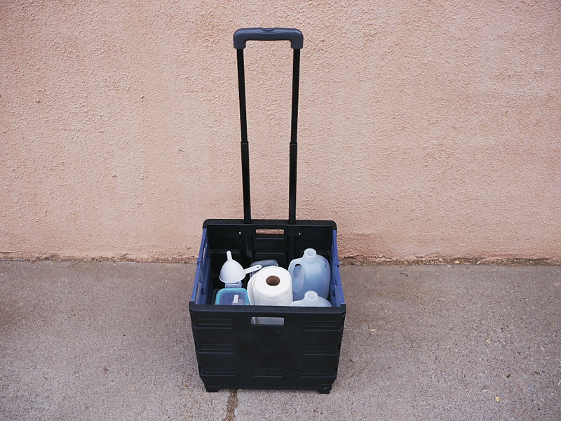

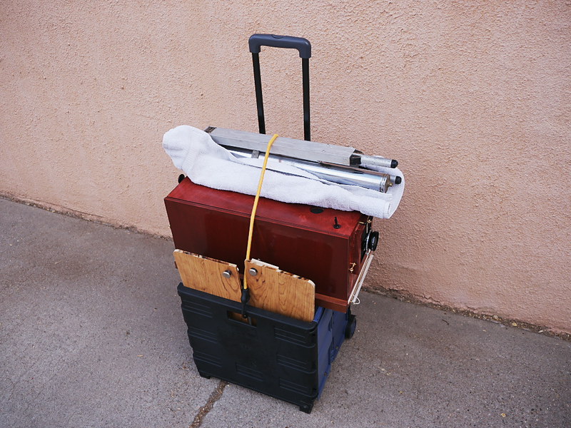

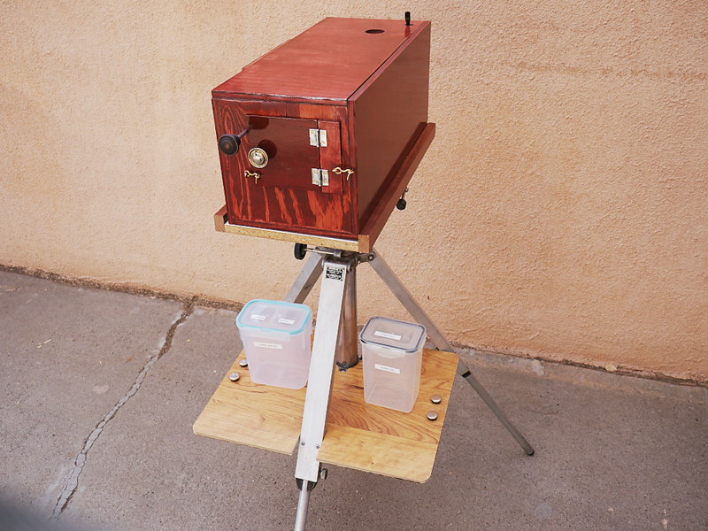

Today I worked on getting the entire Instant Box Camera transportable as a system. First, I made a visit to my local Staples store where I picked up this collapsable dolly, with 70 pound weight capacity. Inside I can carry two 1-gallon bottles, for fresh water and waste chemicals; paper towels, chemical bottles, spare fixer and developer, and a funnel.
P1100063a by jvcabacus, on Flickr
I also made a storage shelf for the bottom of the tripod. It's made from two pieces of laminate flooring that bolt together, with special notches cut out to fit around the center column and one support leg. This shelf gives me room for the two rinse containers, the smaller container with rinse aid and the other with fresh rinse water; along with other accessories.
For transport, I'm carrying many of my smaller accessories inside the camera itself, with the chemical trays dry and placed upside; there's room for my light meter, bubble level, printing easel and extension, spare magnetic oval printing mattes, and the viewing port (shown removed), along with the printing filter.
P1100062b by jvcabacus, on Flickr
Here's the entire system packed up and ready for transport. I wanted to be able to move the entire rig in one trip from my car, so that I don't have to worry about the possibility of theft, especially if I'm doing this solo. The tripod collapses to a compact package and is wrapped in a towel, to keep from scratching the finish on the camera box. The towel might also come in handy to keep folded atop the camera, for cleaning up spills and drips. A bungee cord secures the load. Once the camera is set up, I'll be able to collapse the handle on the dolly and secure it under the lower shelf of the tripod.
P1100064a by jvcabacus, on Flickr

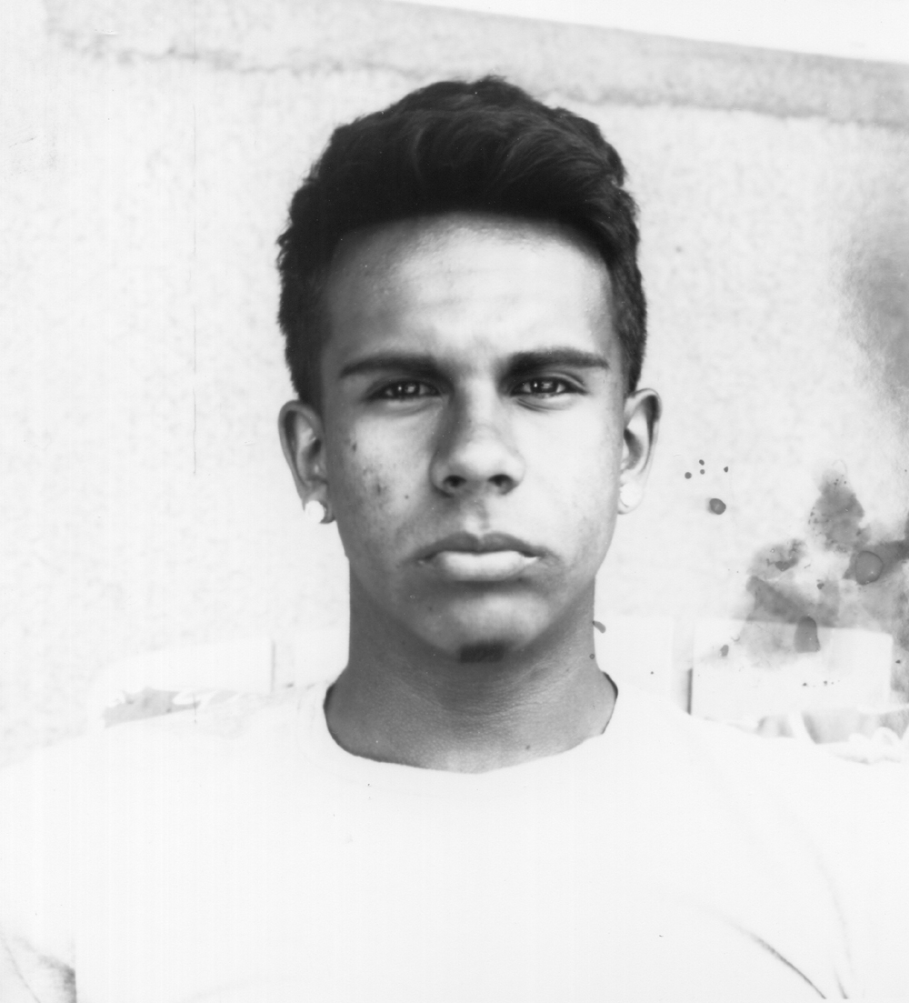

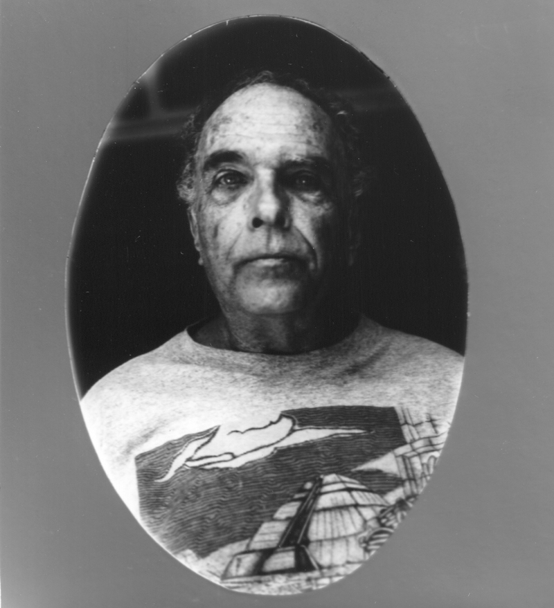

A quick portrait session from this morning, of a friend of my grandson. The negative, on Arista grade 2 RC paper rated at ISO12, was F/8 at 1/4 second. I used incident metering, adjacent to his face, then added 1.5 additional stops.
The print was via the printing easel placed in front of the camera lens, onto Ilford MG RC WT Luster paper, rated at ISO1.6 and with a grade 3.5 filter over the lens, an exposure of F/11 at 3 seconds. For this exposure I reflection metered a gray card placed adjacent to the printing easel, which worked rather well.
Mark001a by jvcabacus, on Flickr

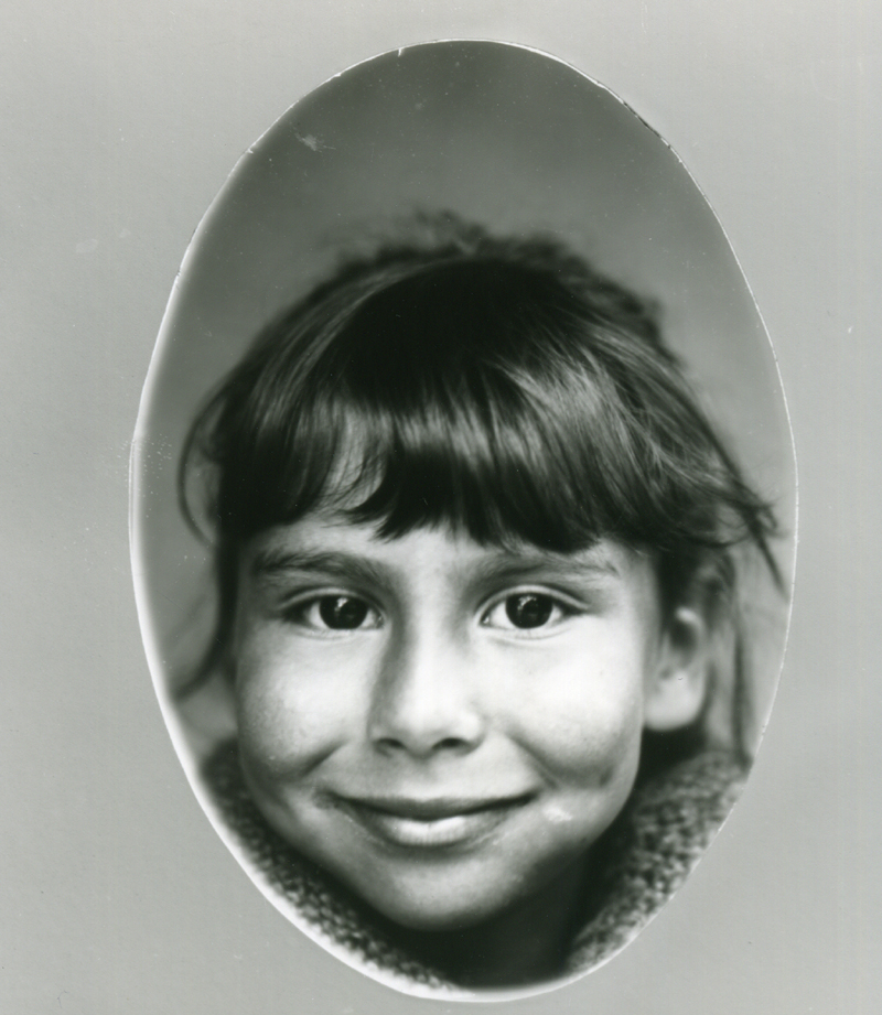

Here's a portrait of my grand daughter, made today. I had composed her nicely framed up, but she slumped down in the chair during the exposure, and so I couldn't get her face well centered on the oval mask, though I was able to avoid the borders of the negative from showing on the print. It was cold and rainy; you can tell she's snuggled in a blanket to stay warm. Incident metering +1 stop, for an exposure of f/8 at 1/2 second. For the print it was again at grade 3.5, f/8 at 3 seconds, metered by taking a reflection reading off a gray card. Thus far, this metering method seems to be working.
I had better luck with the focus today. I had her hold the focus target in front of her face, with the string tight, as I focused upon the target. After loading the paper and setting the lens, I stood next to her, with the string stretched tight and positioned her head so her eyes were adjacent to the card, then dropped the card out of view of the lens and tripped the shutter. With small kids, it seems to work better for me to operate the focus target rather than them. I'm using a 3 foot shutter release cable, so I'm able to operate the shutter while working with the subject.

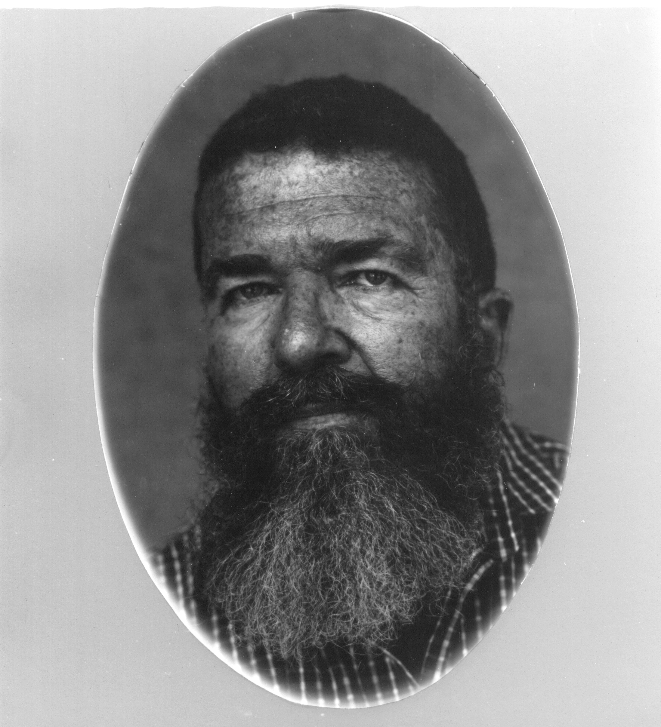

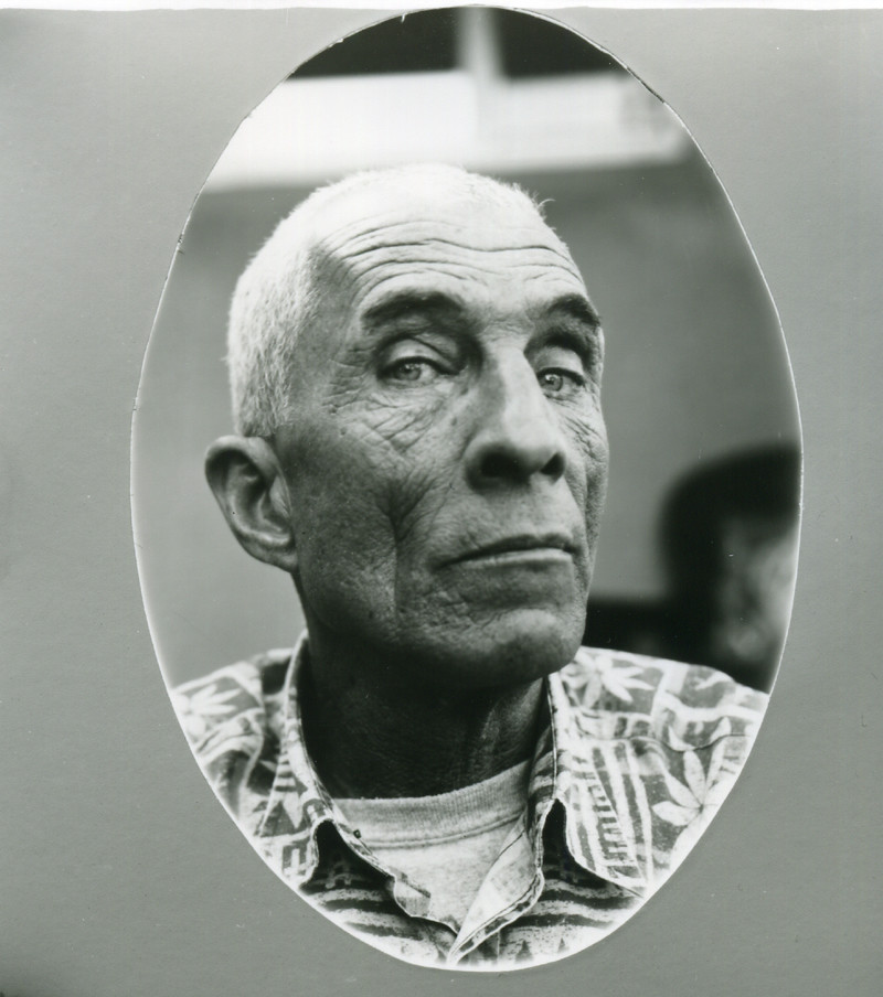

Some former neighbors graced us with a visit today, prior to leaving the state for a new life in the Pacific Northwest. I took the liberty of making a portrait, and presenting them a print. The paper negative was once again Arista grade 2 RC paper, f/8 at 1/4 second, ISO12; while the print was Ilford MG RC WT Luster paper, exposure f/8 for 8 seconds, grade 3.5 printing filter over the lens, rated at ISO 1.6. I continue to use incident metering +1 stop for the negative, and a reflected meter reading off a gray card for the print.
Kim001a by jvcabacus, on Flickr

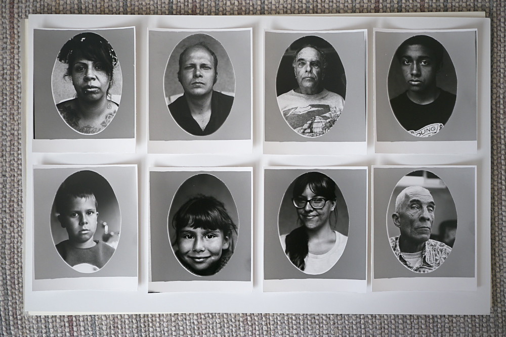

Today I conducted an extended printing session with the rig set up on my back porch, optically printing ten negatives I'd previously made during the last few months. While I made a few mistakes, wasting several sheets of paper, I'm pleased with the outcome. I switched to using grade 2 contrast filtration over the lens, the prints being exposed on Ilford MG RC WT Luster paper.
I still have some issues with my paper safe box. The first one was made from cardboard, but it wasn't moisture proof and so I spray painted it, resulting in the cardboard warping and ruining the box. The second one was made from sheet plastic, but was thinner than the first and thus could not hold as much paper.
This week I made a wider box, also from plastic, which I used today. It's proving to be too flexible, thus hard to load and unload from the box without light leaks. I'm thinking I'll have to make a stiff, liquid proof box from sheet brass, soldered together. That'll be for next week.
I made a presentation folder for the prints, that measure 4.5" by 6", made from silver/gray craft paper. Here's a scan of the back and front of the folder. Inside is a brief description of the print and process.
Luna Plata001 by Joe Van Cleave, on Flickr
~Joe
