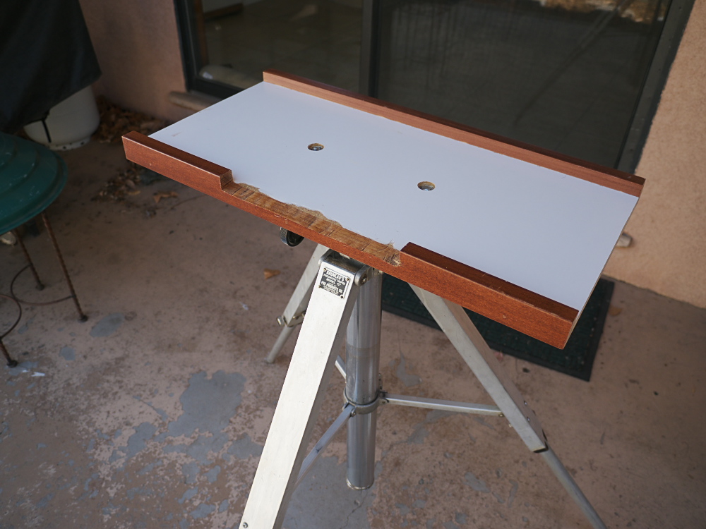

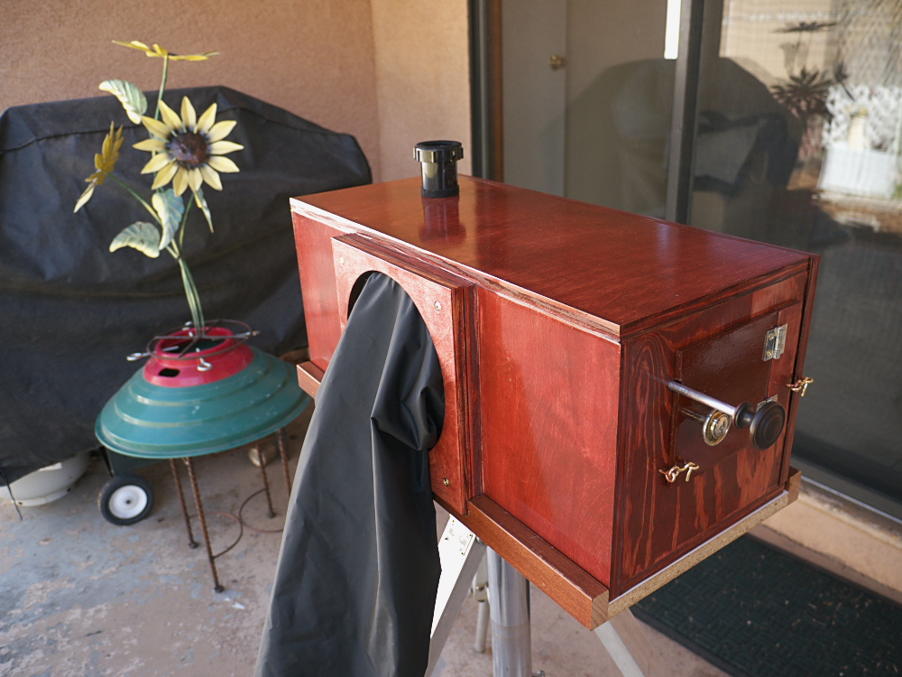

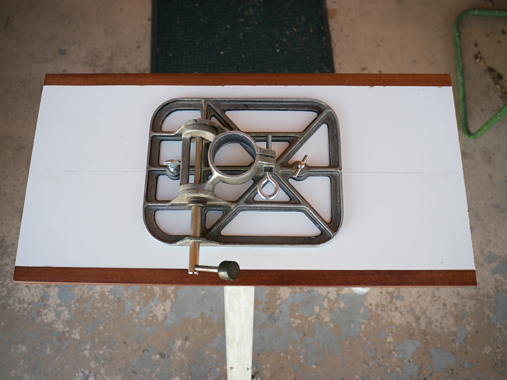

A final update for today. I used a salvaged cabinet shelf as a support base atop the Bruneau's Pneumatic Tripod. Note the two tripod bushings; the tripod head has three such fittings available.
P1090944a by jvcabacus, on Flickr
Here's the underside of the support base, showing the tripod head and mounting hardware.
P1090945a by jvcabacus, on Flickr
I did a series of tests today under my back porch. Note the addition of the plate around the arm sleeve, that secures its mounting rings.
P1090943a by jvcabacus, on Flickr
My initial tests showed some fogging or flare along one side. After a few tests I determined it was caused by bright light from off-axis flaring inside the old Kodak Ektar lens. I added a makeshift lens hood and the problem was resolved. However, the aluminum focus rods were left unpainted, and they reflect too much light. I'll need to paint them flat black, while ensuring the paint doesn't interfere with their motion.

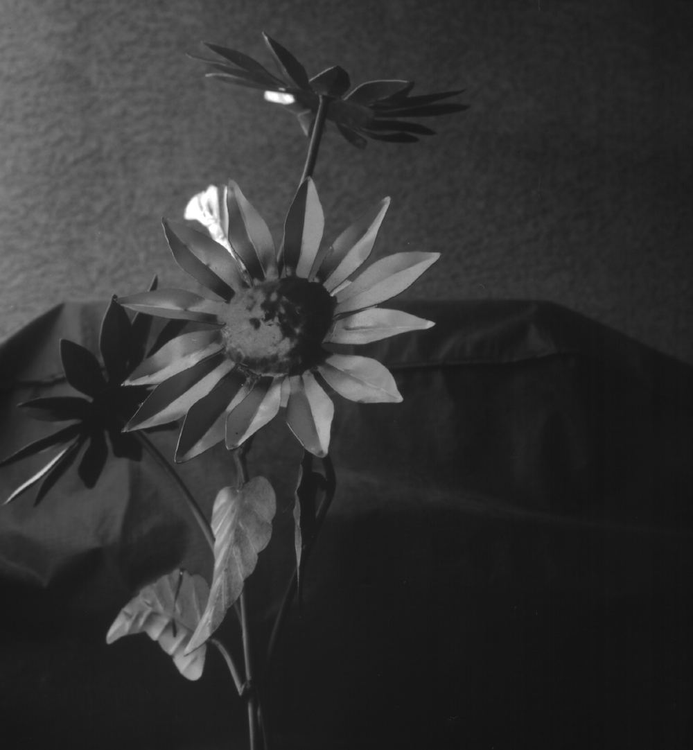

Here's the final test image for today. F/22 at 2 seconds, developed for 3 minutes, with red LED-illuminated inspection via the viewing port. No fogging. Next, I'll need to repeat these tests in bright sun.
Flower003a by jvcabacus, on Flickr

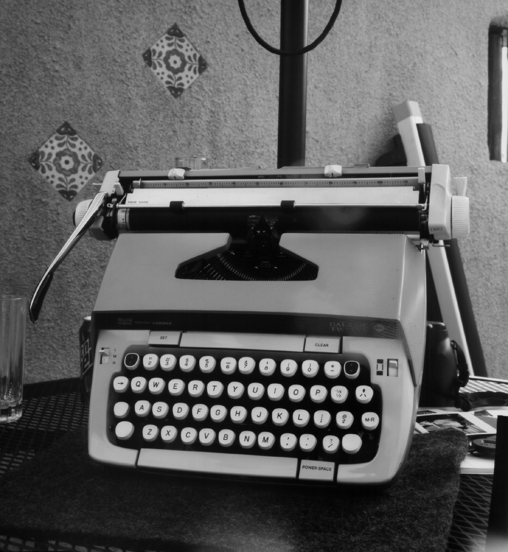

And later, a typewriter portrait (of an SCM Galaxy 12, for those of you typewriter fans).
Note the fogging at the bottom of the image, I've narrowed down the cause to light leaks in my paper safe. Today I fashioned a new safe from different materials with a different design, I'll post results with it soon.
Also note the light flare near the right side of the typewriter's platen, I think that's from lens flare coming from the bright light behind the courtyard wall window seen in the upper right. A lens hood might be the fix. Or possibly use my more modern coated LF lens.
~Joe
SCM_G12001a by jvcabacus, on Flickr
~Joe

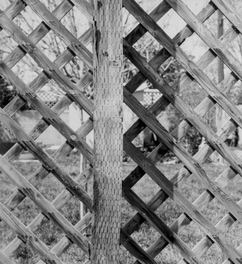

I took the Instant Box Camera out for a field trip today, first into my backyard and then further afield, to several city parks. Despite the wind, dust, pollen and whatnot floating about the spring breeze, the negatives came out fine. No light leaks, no lens flare.
Up to now, I've been making test images in bright shade, but today's images were all made in bright sun. My lens stops down only to f/32, and my light meter recommended about 1/2 second exposures on most of these, so I did 1 second exposures, about as fast as I can manage while still being fairly accurate. The results are not too bad for being over-exposed, there's still some sky detail faintly visible on several of these.
These first two are from my backyard:
Trellis001a by jvcabacus, on Flickr
Tree&Shed001a by jvcabacus, on Flickr
