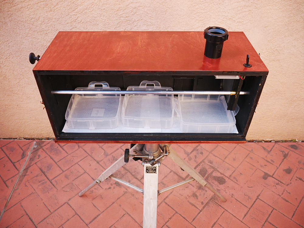

Finally, the pieces have come together into a nearly completed project, after months of preparation, planning and building. I'm referring to the Instant Box Camera project; but there's been nothing instant about it.
These devices are more commonly seen in places like Latin America (known as camara minutera), south Asia (known as Afghanistan Box Cameras) and Cuba (the Dead Link Removed). They combine a box camera with portable processing darkroom, employing paper negatives to, typically, make portraits in public. Some types have the front bellows section of an old camera attached to one end of the processing box, while other types (such as the one I'm building) employ an internal focusing mechanism comprised of a view screen and film holder bracket that slides on internal metal rods, controlled by a focus rod from the rear of the camera. Access to operate the camera is gained via a light-tight arm sleeve, mounted either to the rear door or, like mine, to one side of the box. Many of these camera use only two chemical trays, developer and fixer, but for mine, I've decided to use stop bath as well.
In use, RC paper negatives are produced, which after a quick rinse in a bucket of water are mounted to a bracket that folds up in front of the lens and are rephotographed to produce the finished print. A typical session might take all of 15 minutes from posing the subject to a wet print.

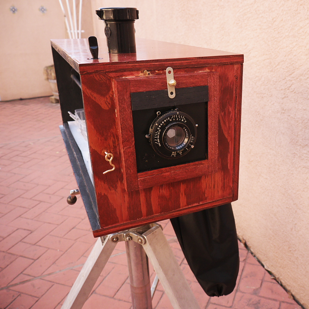

Last week, I completed staining the box and applying one coat of clear polyurethane, sufficient to call it ready for testing. This morning, I struggled with getting the black fabric arm sleeve and its wooden sewing ring clamps installed, with success found only after application of a rotary power tool to some tight spaces; anxious to begin testing the camera, I have not yet built or installed the final clamping plate over these rings.
I've yet to install a tripod socket under the box, my plan being to build a separate bottom plate that includes tripod socket and also the folding printing frame, that extends out in front of the lens for printing the paper negatives. And so for today, I just shot and developed a few paper negatives, one a portrait in my front courtyard with the camera resting on a small metal patio table, then another portrait on my back porch using as a stand an old studio tripod, the box secured with a bungee cord to the tripod's large base. My wife was kind enough to sit as a test subject for these first images from the new device.
Using the camera entails first bringing it into the darkroom, where I cut photo paper down to size (4.625" by 3.875") and load them into the cardboard paper safe inside the camera. Then the box is brought out and set up for the subject to be photographed. It's important to keep the camera as level as possible, to prevent sloshing of chemicals from their trays. And so a tripod with adjustable height will be required.
The premixed chemicals are stored and transported in small plastic bottles, the contents of which are poured into the trays, once the camera has been set up and the side of the box removed for access, after which the camera's side can be reinstalled.
I then take a meter reading of the subject, ensuring I've set the paper's ISO on the meter (with Arista grade 2 RC paper I rate its speed at ISO12), and select an f-stop sufficient to permit a shutter speed of around 1-2 seconds. I'm using an old Kodak Ektar lens from a Speed Graphic, whose shutter is busted, so I'll have to use a lens cap as a shutter, meaning that for accurate exposures I need exposure times of at least one second in duration - but not too long, otherwise the subject might be blurry due to movement.

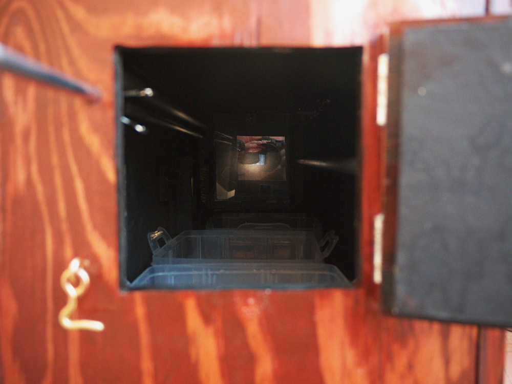

I then open the rear door and compose & focus the subject on the internal view screen. This might entail moving the camera a bit, while focusing is performed by moving the control rod in or out as needed; I mark the selected focus position on the rod by means of a metal clip, which limits rearward movement of the film holder to the preset position. Once focus is set, I secure the rear door, set the f-stop and cap the lens.
P1090939a by jvcabacus, on Flickr

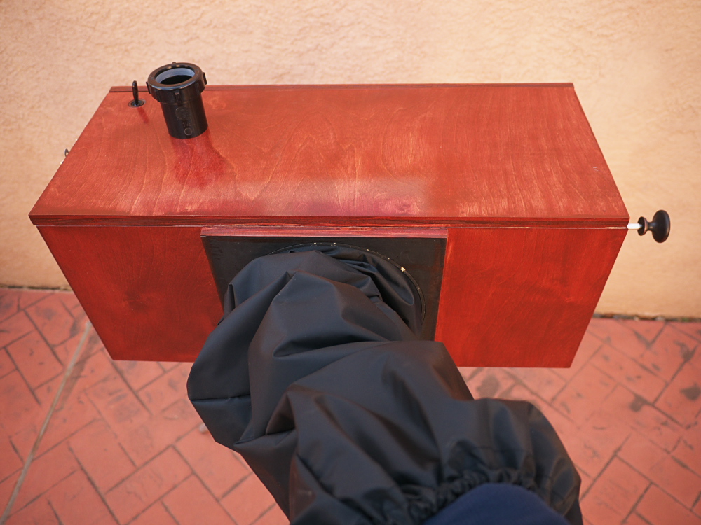

I insert my arm in the sleeve, then open the inner sleeve door. I push the film holder forward toward the lens, giving me room to open the paper safe box, sliding it back and rotating it upwards, then remove one sheet of photo paper. I can tell which side is the emulsion side by its feel, and also the paper's curl. I temporarily set the paper on end, leaning against the paper safe box, while I slide the film holder back a bit and hinge back the view screen. I must ensure that the screen does not fall down into a chemical tray (which did happen to me on one occasion). The paper is inserted in front of the screen, then the screen is hinged back up into place. The film holder is temporarily pushed forward, permitting room to rotate the paper safe box upright and slide it back into its safe storage position. Then the film holder can be slid back until stopped by the metal clip; the paper is now positioned at the preset focus position.
P1090935a by jvcabacus, on Flickr
At this time, I can opt to pull my hand from inside the box, slide close the inner door, and remove my arm from the sleeve, giving me both arms free to direct the subject and operate the shutter. For today's tests, I opted to keep my arm in the box. I asked my wife to sit still, eyes open and not to blink. Then I timed the exposure via the lens cap, after which I instructed her to relax and wait until I processed the negative.
To remove the paper negative from the holder, I have to slide it back a bit, then fold down the view screen and retrieve the paper. The tricky part is then closing the view screen while keeping hold of the paper; on the second portrait, I dropped the paper negative at this point, and it fell partway into the developer tray; by the time I had the view screen secured and pushed forward, part of the paper was already developing. In the future, I must ensure the exposed negative is leaning against the paper safe box, then the screen can be hinged back up and secured safely.

Just a quick update on the project. Yesterday I applied some shielding to the red LED illumination, so all the light has to pass through a frosted white diffuser. Today I set up the camera on my shaded back porch for more tests.
My subject was a still life, set up under the shaded porch; but off to one side was bright light coming from the sun lit area of my yard.
I kept getting a strange, semi-circular flare on one side of the negative. Thinking it was light reflecting off one of the focus rods, I installed some light shields to block the flare. I still had the flare, except the center of the semi-circular area was okay, meaning the light flare was like an arc.
Not finding any other source of flare, I began to suspect flare from the lens, caused by that bright area off to one side, behind my subject. So I installed a temporary lens shield. Finally, no flare, no fogging and I used the red LED illumination with inspection through the viewing port (and no red filter on the port).
The lesson learned is that this old WWII-era lens needs a lens shade. I'm going to build one designed for my film format, and will ensure it provides shading at all focal lengths, from infinity focus to macro focus while optically printing the negatives.
