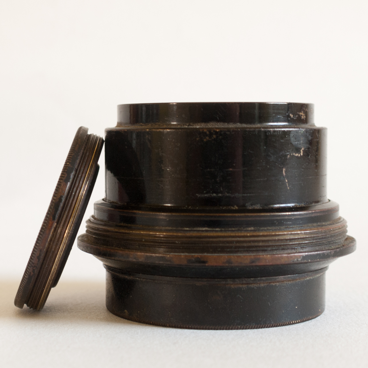

I couldn't resist buying this today while I was rummaging around in a box at a car boot sale.
The gunk on the front appears to be mud, by the way
I think the rear cell actually comes from another lens, as it won't screw more than about ¾ of a turn on, although the finish and the colour look identical to the rest of the lens. The thread doesn't look damaged to me, but then I'm no engineer. With the rear cell on, or indeed off, I can't get an image to form.
So that's a tenner wasted, unless I can find an appropriate rear cell, which seems about as likely as my winning the lottery.
All the elements seem to have some sort of damage, but the barrel has a very smooth working 12-bladed iris, though.
I should have bought the Kodak 203mm f/7.7 (in a jammed Compur) that I found in the same box, really, but I didn't have enough cash on me. Sigh. Bad decision.
Anyway, just for LOLs as they say, can anyone (Dan? Ian?) tell me anything about this thing? Is it actually a process lens?

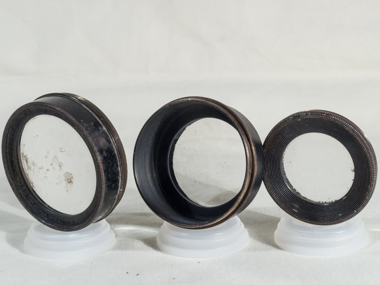

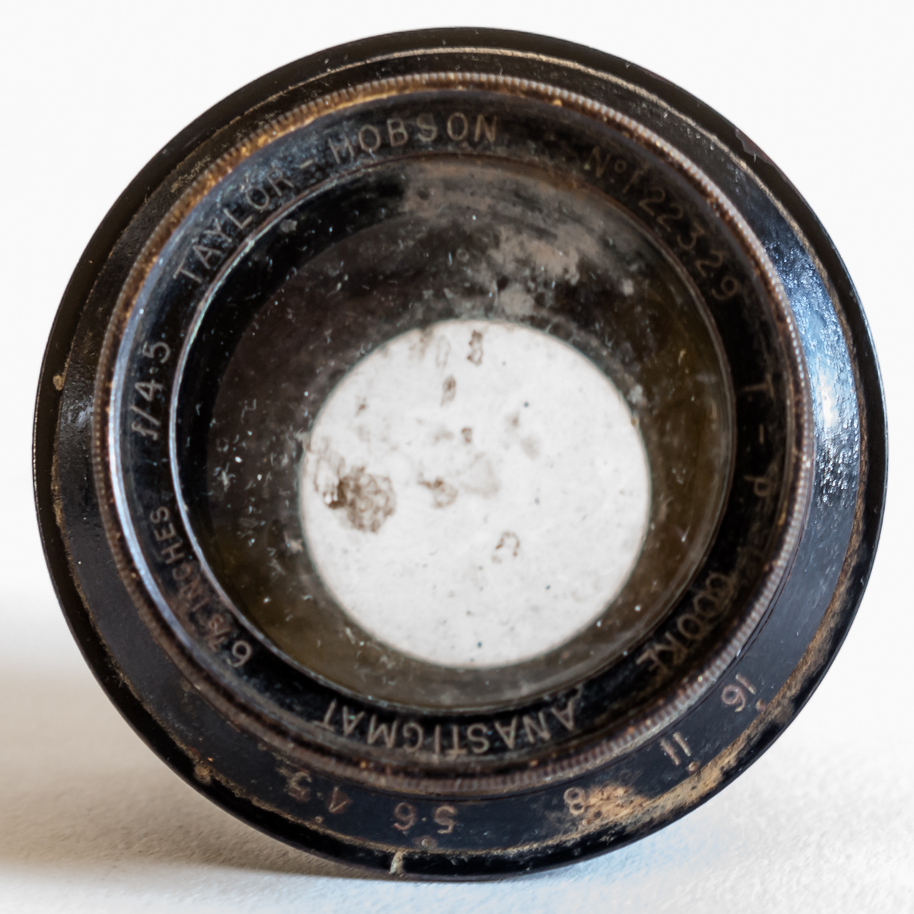

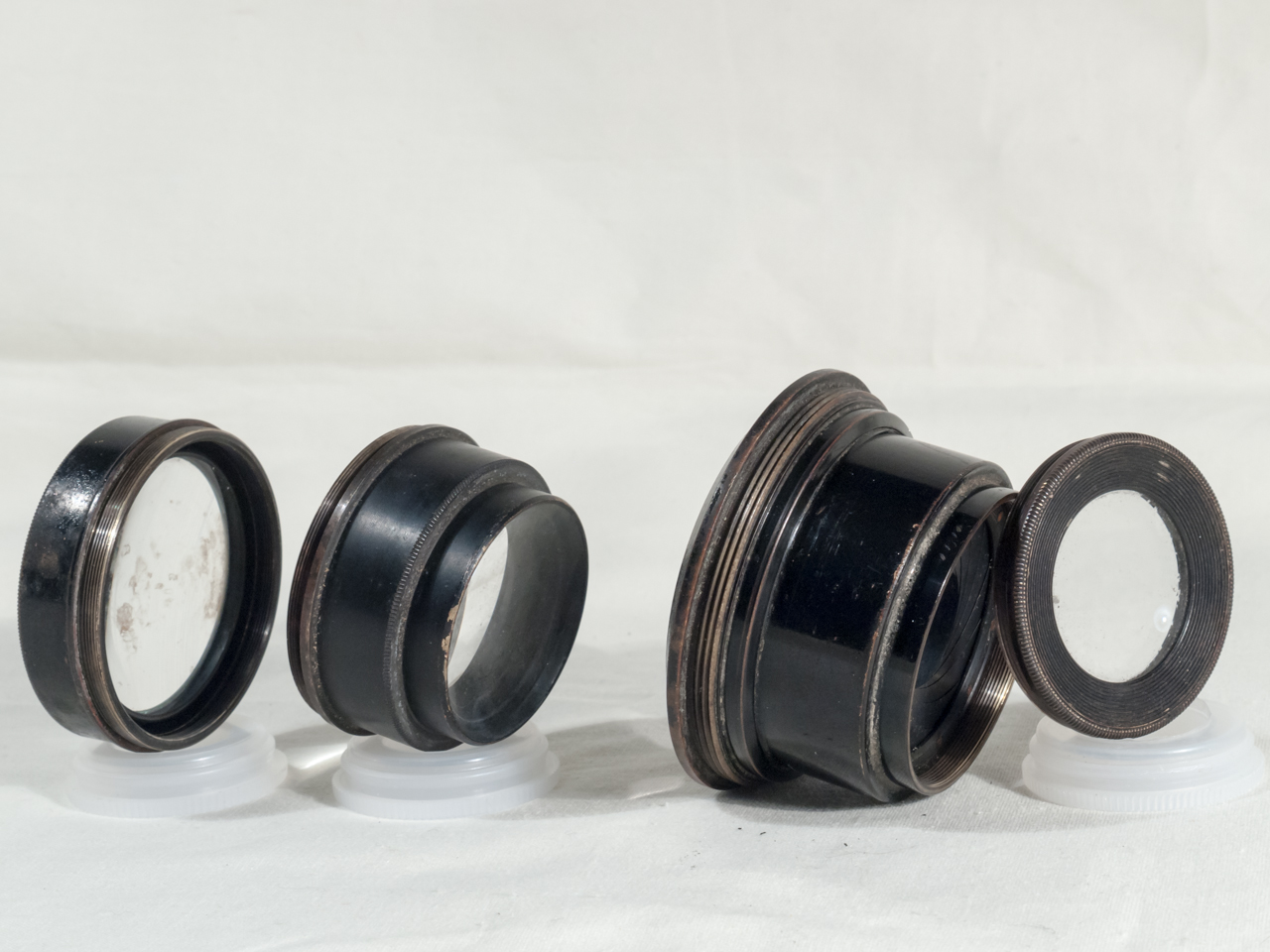

Not quite sure what you meant by "second from the ends of the lens ", but here's another couple of shots.
I can easily do more if these aren't helpful, as I'm set up for photographing lenses today :smile:
post 1 picture 2, turn the barrel 90° so the lens ends are facing the camera (2 pictures) and rotate picture 1 180° (1 picture).
Check all threaded sections for damage or burs. Measure the threads, different thread pitch suggest there was a mount ring in the camera that the sections attached to.

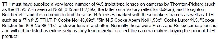

From the Vade Mecum: TTH must have supplied a very large number of f4.5 triplet type lenses on cameras by Thornton-Pickard (such
as the f4.5/5.75in seen at No58,685 and 82,39x, the latter on a Victory reflex for 6x9cm), and Houghton-
Butcher etc. and it is common to find these as f4.5 lenses marked with these makers names as well as TTH
such as a "7in f4.5 TTH/T-P Cooke No148,89x", "5in f4.5 Cooke Apem No91,53x", Cooke Luxor f4.5, "Cooke-
Butcher 5in f6.8 No 88,41x"- a slower lens in a shutter. Normally these were Press and Reflex camera lenses,
and will not be listed as extensively as they tend merely to reflect the camera makers buying the normal TTH
product.
