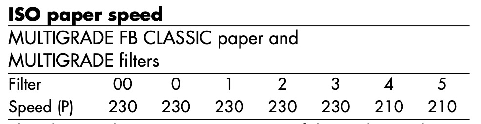

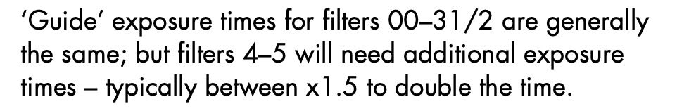

Something to keep in mind, the paper's sensitivity to #5 or magenta filter exposure is less than its sensitivity to 00 or yellow filtration, so you really have to increase the magenta/5 exposure considerably before it starts to significantly affect the highlights.
