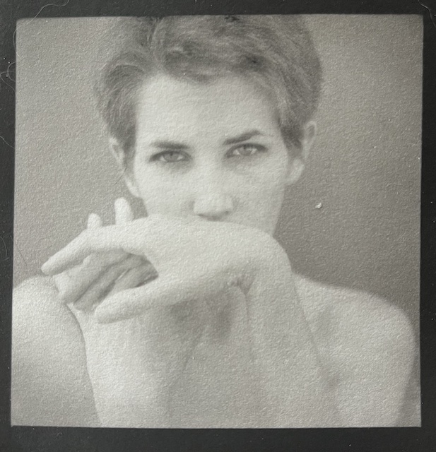

I am getting black values that are similar to what I have gotten with palladium prints. I experimented with longer exposures but got solarization, not deeper blacks. I did test for max black through a sheet of film. Highlights are not paper-white, but close. I am using Richard Boutwell's program, QuadToneProfiler, to linearize the QTR curve. I'll attach a shot of the last print, of an old photo I posted to APUG ages ago:
As you will see, the Pt/Kallitype lacks sufficient contrast between skintones and background, and also among skin tones in hands and shoulders. I think I can balance it out by darkening midtones with the gamma slider and reprinting the negative, but it does make me wonder whether I am missing something for the tones to diverge this much from the original file.

It's hard to discern on the browser photo, but it does look to me that your Dmax is kind of low based on the border. Unfortunately, solarization/bronzing is like a hard stop for Dmax. In salt prints I found that drying more thoroughly moved the "bronze point" higher giving me a slight boost on the Dmax. I don't know if there is anything like that in the kallitype repertoire.

Update: I printed a test using a negative with markedly darker midtones. The result was a marginal improvement, but not a complete fix.
I am wondering whether the issue is with my chemicals. I mixed this batch of ferric oxalate 10 days ago. It should still be good. But I am running out of culprits.

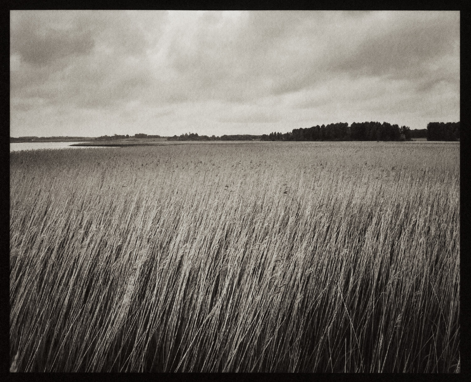

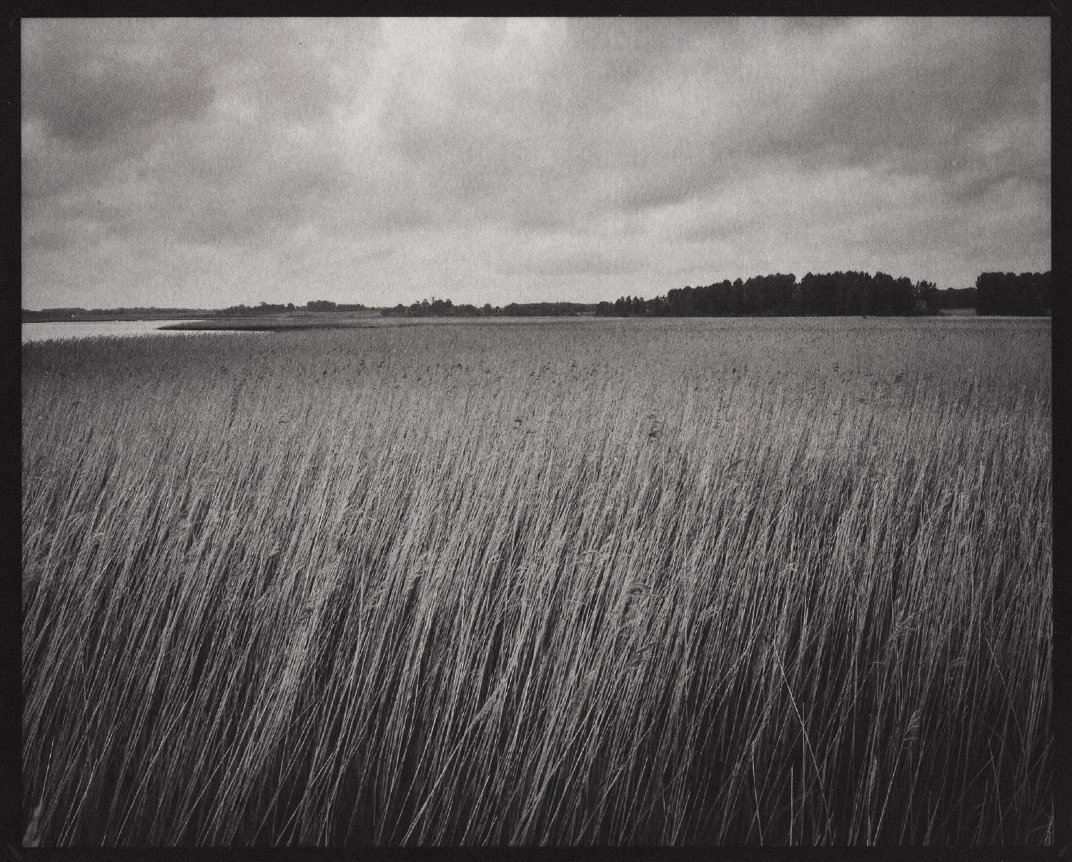

I've only used Wolfgang Moersch Kallitype with contrast booster in the developer (Sodium Citrate) and the EasyDigitalNegative process for producing curves.
Kallitype Pd toned
Kallitype Gold toned

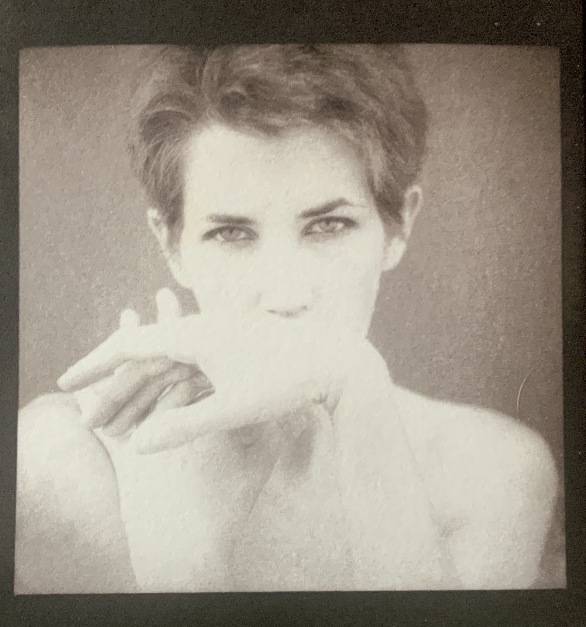

Now I have a new problem. The highlights bleached out in the clearing baths. I am attaching a snap of the print, toned in gold. I followed Sandy King’s Kallitype recipe on the Alternative Photography site, in which he specifies two five-minute clearing baths in a 3% citric acid solution.
Reading further now, I see that Sandy King’s Kallitype article on Unblinking Eye specifies a maximum of four minutes in the same solution, not ten. Of course I will retest now with a shortened clearing bath. Do you all have any thoughts as to the appropriate times and solutions for clearing the print after development?

I have found through frustration that a step wedge won’t lie but my monitor sure will. If your printed step wedge looks perfect but it’s looks wrong on your monitor than you might adjust your monitor. I find I have to always darken the shadows on my iMac to match a good print. Just something to ponder

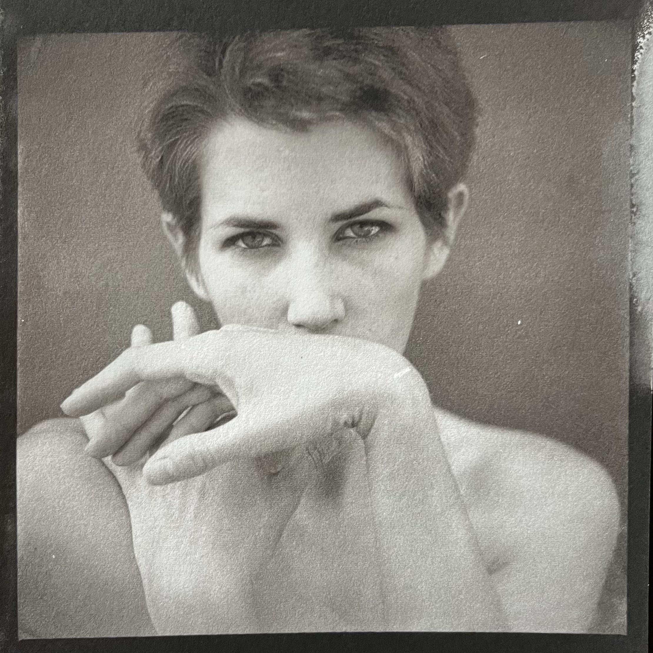

Update: I shortened the two citric acid clearing bath times from five to two minutes each, and used a dilute (1:6) TF-4 fixer. And relinearized the curve (again) to reflect the changes. And reprinted the negative with the new curve, darkening gamma a wee bit.
It worked!
Lessons learned:
Use ferric oxalate in solution within a few days of mixing it.
Use an alkaline fixer.
Modest changes to midtone balance can improve the printed image, even with a properly-linearized print curve.
