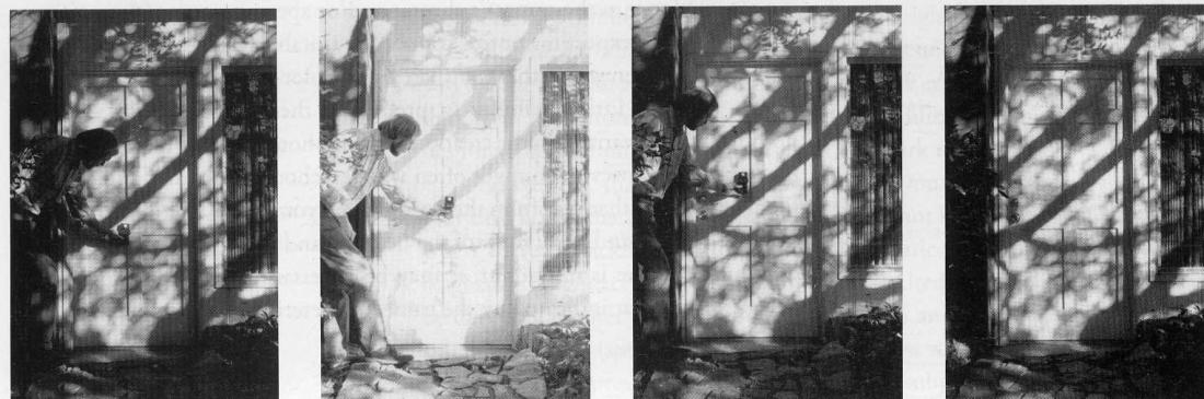

I don't think so. It's pretty basic stuff. Now I have done this and verified for myself with my incident meter and it is true. What I have been saying is simply fact----basic incident metering facts. From left to right, as indicated in the text, the photos were taken using the indicated meter reading---it's a poor scan but you get the point:
-Alan Ross has the dome of the incident meter placed in sunlight, you can see that the shadows are underexposed. (my interpretaion of the text: this should be painfully obvious to you---the exposures recommended by the meter aim to reduce the density on the negative in the sunlit area to that which will print closer to a middle gray, thus underexposing the shadows.
-Next, the dome of the incident meter is moved just a few inches up into a very narrow beam of shadow, you can see that the sunlit portions are blocked. (my interpretation of the text: this should be painfully obvious to you---the exposures recommended by the meter aim to increase the density on the negative to render the shadow middle gray, thus blocking the sunlit areas.)
-Next, the dome is placed in "lightly spotted sunlight", the exposure is much more satisfactory. (my interpretation of the text: I'm not going to be searching for just the right mix of sun and shade with my dome, when a reflected reading is simpler, more reliable, IMO in these situations)
-Lastly, a reflective reading with the exposure made using the camera's built- in meter gives the same exposure as as the previous example. (my interpretation of the text: the distribution of light versus dark areas of the scene are obviously pretty even because the in-camera meter (that also assumes the subject is middle gray) rendered a negative with well proportioned densities that printed very well, no manipulation of the meter was used.) Once the distribution of light vs. dark areas of the scene become heavy in either direction, the in-camera meter, or a hand held wide area reflective meter will get fooled and the photographer has to adjust in that instance.
Like I said, pretty basic stuff.

O.G., IMO, I was addressing "Better Sense's" comments about incident metering and going back to read the OP, it's pretty much in line with the discussion, IMHO. I realize these threads take on a life of their own sometimes, nature of the beast.
Subjectively speaking, the "proper exposure (or relative exposure)" for a shadow can be "underexposure" in many cases.
In real life, most shadows probably aren't Zone V or VI; many shadows are truly IV, III, II, or etc. And, if incident metering leads to a recommended exposure which puts shadows that are truly Zone II on Zone II in your image, then the incident meter did its job. But, of course, dynamic range capabilities also play a major role in this.
I think people get way too hung up on underexposure and overexposure in photography. There is no right or wrong way to respond/handle these extremes. It's an aesthetic decision. If the photographer wants to interpret the scene differently, then they could change the exposure or make changes during the developing/printing process to suit their vision.
But, there are no rules, or objective methods, for interpreting the scene or for responding to underexposure and/or overexposure in the scene. For instance, some photographers may want the "underexposed shadows" on the door to go even darker in the final print (in CPorter's example above).
I think you took his post the wrong way.
To help clarify, his point wasn't that you weren't in line with the discussion. His point was that the dilemma you brought up, "Taking an incident reading in the sun will underexpose the shadow areas" is a not a result of metering (be it incident or reflective). But, it's actually a result of extremely high contrast inherent in the scene and also a lack in our photographic process's ability to capture and show an extremely high dynamic range.
In a contrasty lighting scenario, it isn't an incident meter's job to recommend a "perfect exposure" for the entire scene simply based on one meter reading. It seems that sometimes people don't realize that it isn't the meter's "fault" that some lighting scenarios are too contrasty for the meter to recommend a useful exposure for the entire scene (with just one meter reading). That's part of the reason why I recommend that people begin learning how to use an incident meter in even lighting until they get a sense of how it functions (i.e., what it does and what it can't do, capabilities and limitations). Meters certainly cannot compress all of the inherent dynamic range in scenes into fully visible detail on film, allowing our cameras to capture more detail in the shadows and specular highlights. If meters could, then metering and photography would be easy, :D.
What's in the scene is in the scene. But, if the range of brightness in the scene is extreme, then we can't just solely rely upon the meter or blame it. When the contrast is inherently high, then it's best to do extensive metering and to go through trial-and-error until you get desired results. It's up to the photographer to evaluate the whole scene with precise metering, and then to make aesthetic exposure decisions based on that info and his/her tastes.
