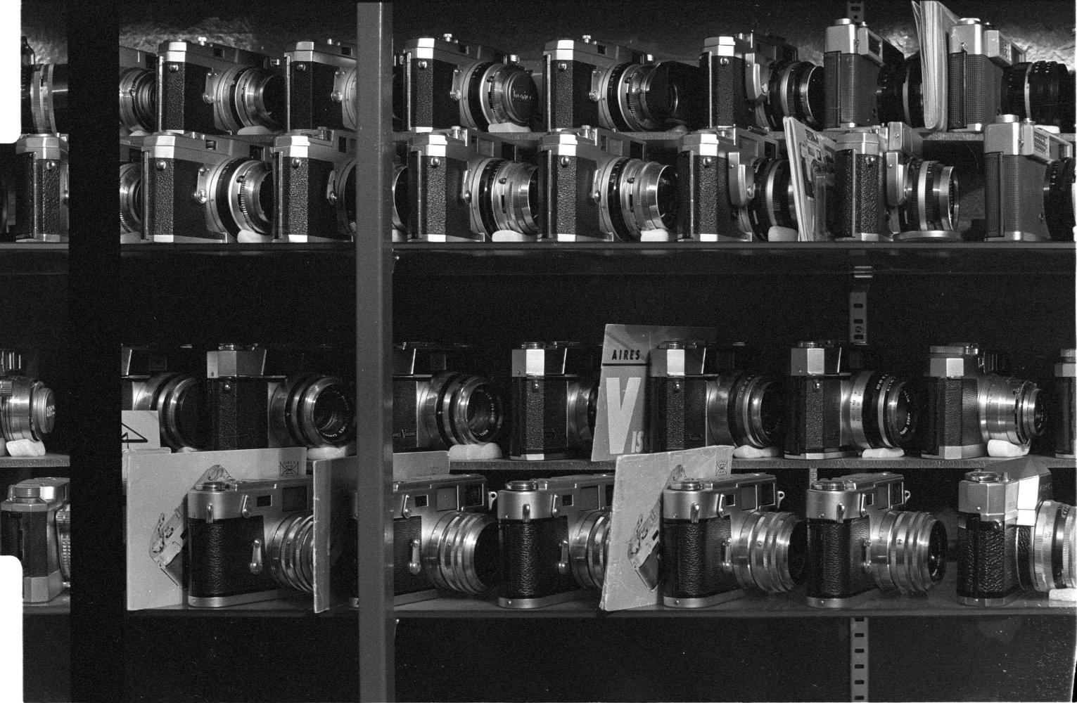

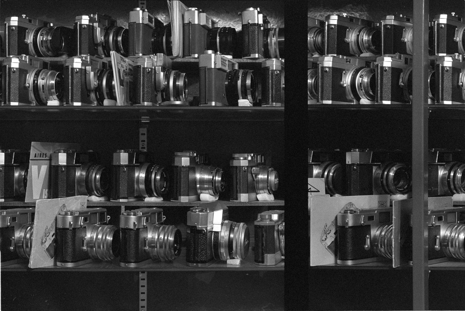

Here is the XTOL scan:

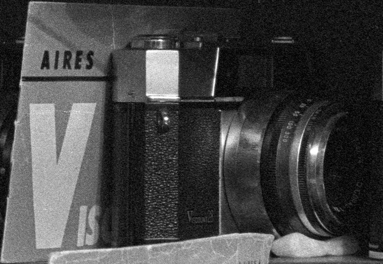

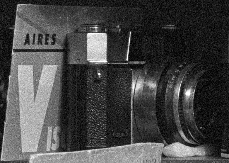

3-00-XtolNormalLoRes.jpg And a crop: 3-00-XtolNormalCrop.jpg
And here is the scan of the above formula:
3-18-Concen1stLoRes.jpg And a crop: 3-18-Concen1stCrop.jpg
These images are darkish because I set the white-point as high as possible in the scanner, to clip as little data to white as possible (i.e., maximize the dynamic range). The black-point was set to the left side of the histogram (which was always the same). Gamma was 1.5.
This is part of my camera-collection, lit by the overhead tungsten candelabra. It's hard lighting, which creates plenty of specular reflections to see how the dense part of negatives are doing. Unfortunately, my Coolscan IV ED scanner doesn't have enough dynamic range to cover such specular reflections well (and still show shadow-detail in the neg's), so many reflections clip to white.
In the crops above, my formula appears to have less grain than XTOL. That's not true. In 22X loupes, they seem to have the same grain. The scanner's focus has a little variation, and the film isn't held perfectly flat, so grain is defocussed by unpredictable amounts. To get sharp images of grain, I want to photograph negatives in a microscope.
Mark Overton
Thanks Mark;
IMHO the experimental developer looks less sharp. Look at the numbers on the lens in both crops. The grain is similar and low.
PE
Thanks Mark;
PE
Oops, that was poor scanner-focus, being near the edge of the neg-carrier.
I re-scanned that neg, but this time manually focusing the scanner on that crop-area. That made the scan sharper there:
Mark Overton
Thanks again. Looks better now. There is some "hash" on the right top in the dense areas.
Both developers look similar in contrast to me when viewed as thumbnails. I can't view them side-by-side for a more accurate examination. Just keep on working. looks interesting and you are learning as you go.
PE
