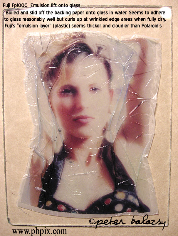

I was in touch today with Mr. Steve Pfaff the President of Daylab
( www.daylab.com) and he asked me if I had any "emulsion-lift" success using the new Fuji FP-100c film because many customers have been asking him about it and worried about if it can be accomplished or not.
So I tried a test tonight and met with relative success right away.

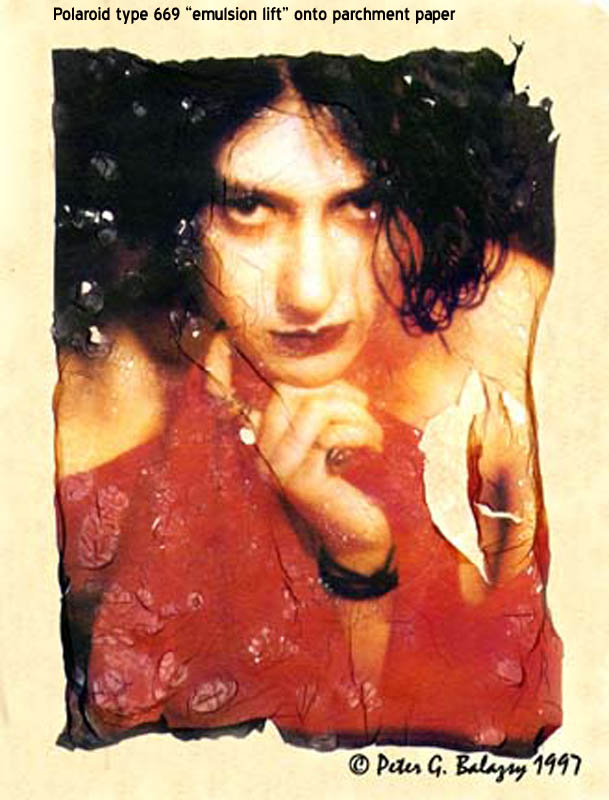

I feel that the effect is not exactly the same as with the Polaroid emulsion because the layer is thicker and stiffer and not as delicate or as diaphanous.
It seemed to stick well to the glass but the dry edges where wrinkled seemed to curl up.
I guess that one way to try to address this ....when using glass ....is to mount the image against a nice color backing paper with the glass reversed so the right side of the image faces down against the backing paper and back of the image shows up through the glass and then the effect of the manipulated, wrinkling is still evident but the entire work is protected behind the glass.
Another idea is to place another glass flat against the front side of the image to hold entire area flat.
If you are not wrinkling for artistic feel perhaps a spray adhesive might work.. I'm sure someone will invent a better technique as soon as we all experiment a little more.
Here's tonight's results:
My Polaroid stock is dwindling, so this is encouraging. My thanks to everyone taking the time to experiment with the Fuji material and for sharing the results on forums like this one.
so peter, you are placing the lift against glass, have you tried other surfaces?
No Ann I have not tried any other surfaces yet. That one I posted was just my 1st test experiment with Fuji lifts last night.
I noticed however that when I boiled it and slid off the "emulsion" there was a goopy clear gelatinous mass left on the surface of the original backing paper.
( I think Polaroid used clay)
...but this stuff swelled up from the hot water like clear Cream of Wheat ....lol
I guess it's a bonding agent...used to adhere the top plastic-emulsion-layer to the backing paper.
So whatever that stuff is ( maybe like Knox Gelatin?) it could be used to help the lifted emulsion stick to the new receptor?... maybe?
I imagine if the lifted emulsion was placed smooth and flat onto a new receptor.. and kept smooth... then maybe a spray adhesive would work well... But since most artists like to wrinkle the "lift"... one needs to have a nice slippery receptor surface on which to slide the lift around a bit.
So in that case maybe a wetter goopier adherent would work better. So maybe something like Knox Gelatin?
So maybe if we can find a wet bonding agent that dries shortly after wrinkling the "lift" would work.
I've never used Knox Gelatin per se.. but maybe it ...or something like that would be a good inert bonding agent.
