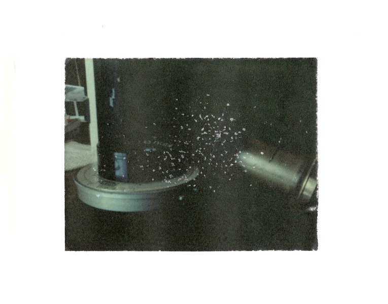

    OK, I posted the link in reply #2 and just so I can prove it does work, I did it.
    And not only did it work, it worked in spite of my bending some of the rules he set forth.
    I just grabbed a piece of paper of the scrap pile, I know it is hot pressed and I'm pretty sure it was Canson but right now I couldn't tell you which. And I'm quite sure it has at least some sizing. Second I didn't use a hard rubber brayer. The one I had on had I would call medium soft. The pack film camera on had with Fuji FP100C in it was my "Frankenroid" pinhole so I just set some LF lenses on the table and guessed at an exposure, turns out 10 minutes was probably to little.
    Quickly, the light/dark banding that would otherwise be considered a "bad pull" isn't. It is the water color paper rippling a bit and my craptacular scanner lid wasn't heavy enough. Also, the tonal range is better in the print than the scan (same ole' song and dance, I know). However, the large "snowstorm" in the middle isn't an artifact. It is bits of emulsion that didn't transfer. Brayer only run in one direction and possibly the work surface wasn't smooth enough. Or brayer too soft, too little pressure, too fast peel, you know the drill with transfers. Any number of things can go wrong.
    But son of a gun if it didn't work!
