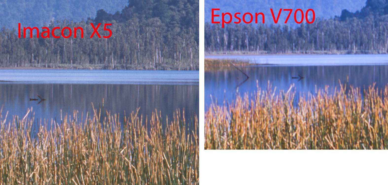

Not sure about the older Flextight model but I got a Imacon scan done by AGX lab in the USA. I live in the NZ and it is so expensive that I send my film to the USA for processing, I also buy my fresh film from the USA.
Here is a side by side comparison with my Epson V700 using the better scanning film holder. Versus the X5 Imacon. Epson is scanned at 2400pi which is what most pple say is the maximum detail that it gets. Attached photo is a 100% view crop section. Fuji Velvia 50 RVP 120 format, RB67.
