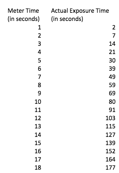

Thanks - I'll do some tests without extensions. I'm interested in streamlining film, camera and chemicals for a project I'll be working on for the next year or so. Mostly still life shot indoor with natural light. I've done a lot of colour, produced at lab, and this has been very easy. Although B/W was my personal entry to photography, 14 years ago, it's feels so good to be back...this time with 4x5. I love the troubleshooting and experimenting aspect.
Yeah I found a reciprocity card via google. It looked extreme compared to what I'm used to myself. I've added a screenshot.
FYI, each film will have it's own reciprocity failure rate, so the chart you posted may only be for one specific brand/type of film.
The book "Using the View Camera" by Steve Simmons has a good reciprocity failure chart for various films in chapter 7. A great book, with a bevy of info on learning and using LF. It even discusses bellows factor in an easy to understand manner.
You need to find the one specific to the film you're using. Each film is a little different. I use an app on my iPhone - I think it's called reciprocity timer or something similar? It helps figure the correct time based on film, bellows factor, and filter factor. For those of us who are math challenged, it's GREAT. It's probably my favorite app.
Your chart only goes out to 20 seconds the data sheet goes out to 100 seconds?
I trust you understand it is a non linear effect.
Noel
It was just a quick cropped screenshot. The chart goes further.
