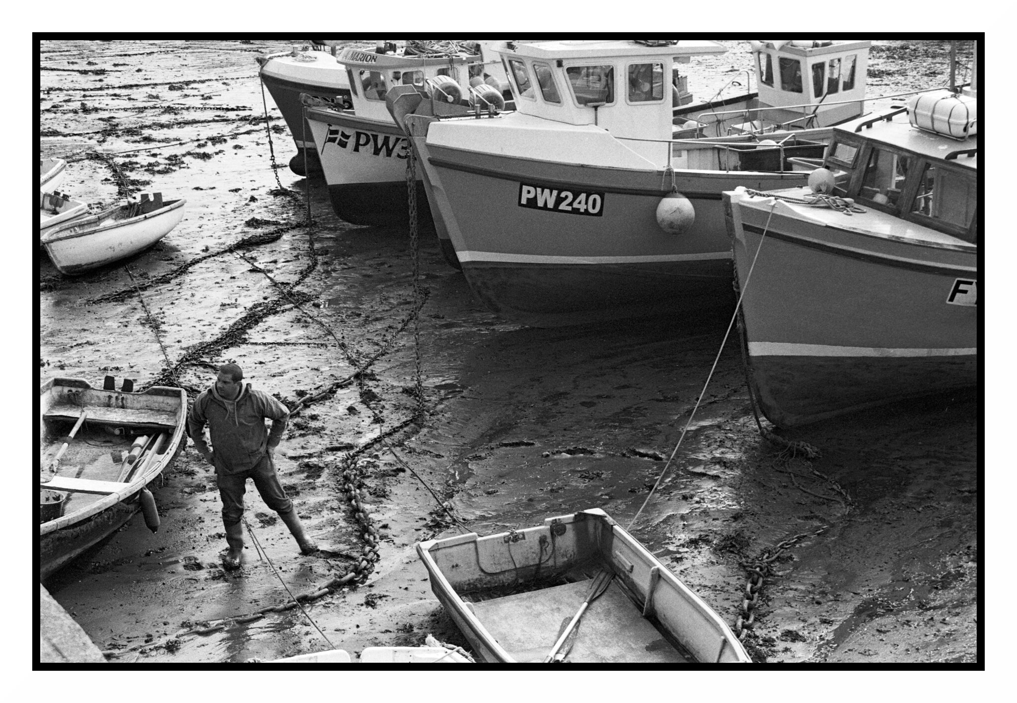

High tide at Mevagissey by E.J. Bragg, on Flickr
Weather beaten Angel, Charlestown, Cornwall. by E.J. Bragg, on Flickr
Mevagissey anglers by E.J. Bragg, on Flickr
Graveyard Geometry by E.J. Bragg, on Flickr

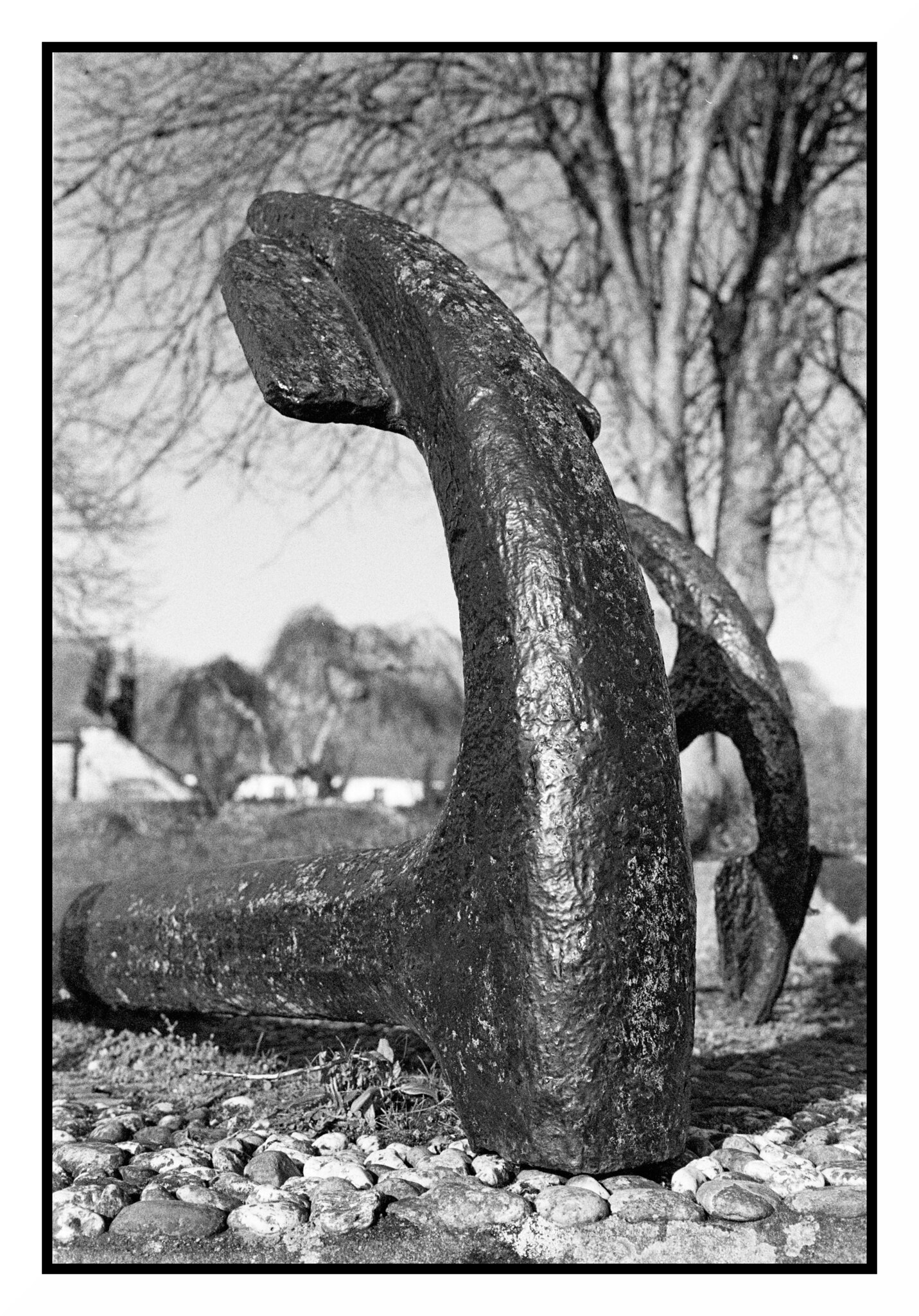

Anchors at Charlestown, Cornwall by E.J. Bragg, on Flickr

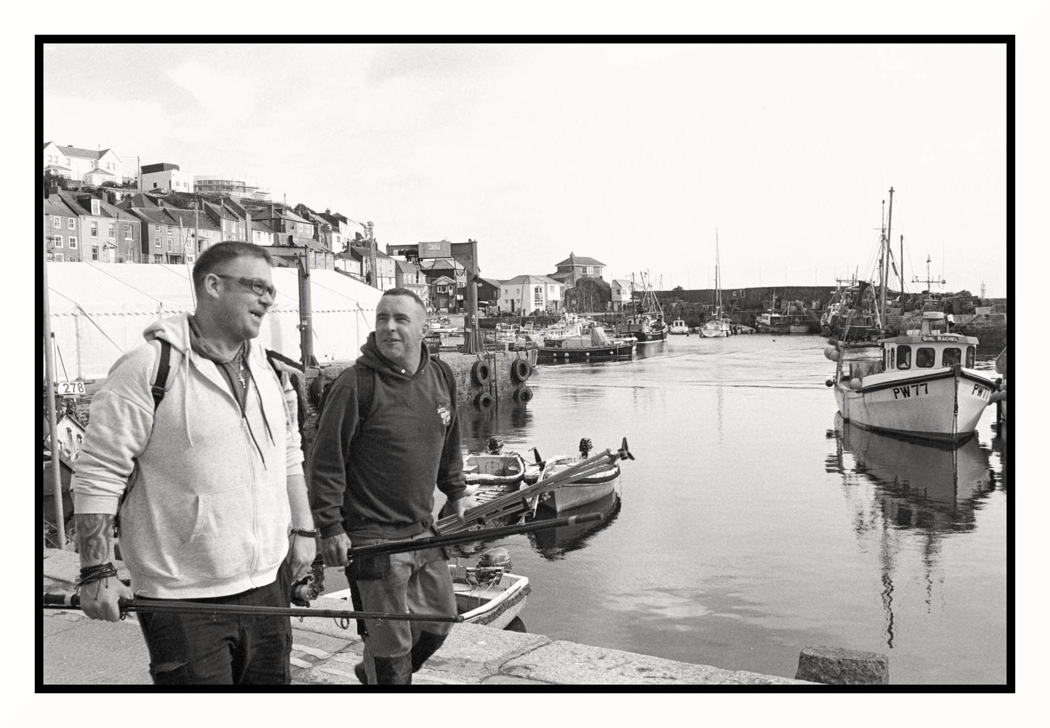

Fixing Moorings in Mevagissey harbour. by E.J. Bragg, on Flickr
Barnacles by E.J. Bragg, on Flickr
Working Man by E.J. Bragg, on Flickr

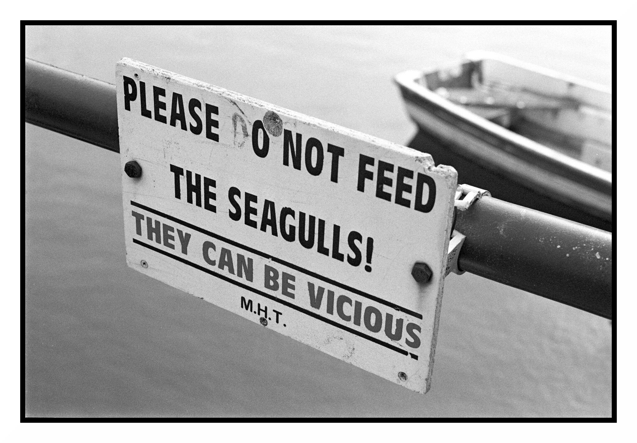

You have been warned ! by E.J. Bragg, on Flickr

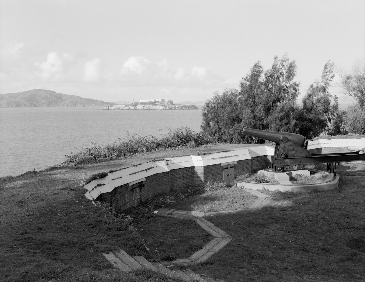

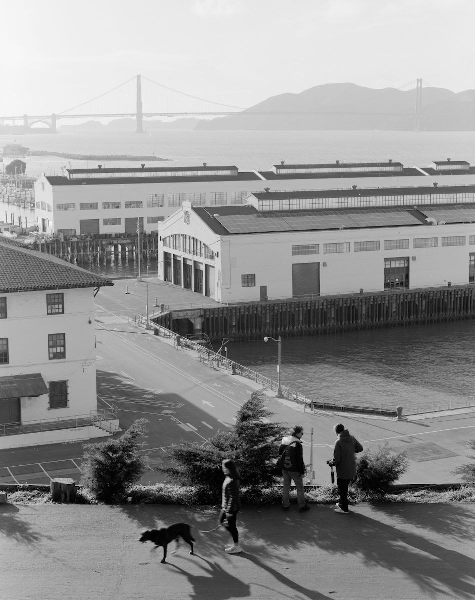

@John Bragg you definitely have a style, sir. I suspect some of this comes down to scanning too, you're very protective of both the shadows and the highlights. And speaking of Ilfotec HC, for some reason it works pretty well in combination with HP5+ in large format, see below. But for 35mm I seldom use it.
HP5+ in Ilfotec HC
HP5+ in Ilfotec HC

John, they are large format, so grainy appearance is not a problem. I was never 100% sure what do people mean when they say "shoot at" or "rate at" a certain ISO. This is the equivalent of saying +1EV exposure compensation, but that would be incomplete without knowing how metering was done. Those shots were spot-metered. The meter was set to ISO 400. Usually I'd sample the shadow where I need visible detail and add between 2 and 3EV based on what else is in the scene.
Having used large format for about a year, I am still a newbie. What I am noticing (gut feel, not a measurement) though is that LF negatives seem to hold a greater range of densities and I never had a problem with blown highlights with HC. I don't know whether its true or just a coincidence. The golden bridge shot had crazy contrast, and yet there's detail everywhere on the negative. The pure black appearance of the bushes in the foreground came from digital editing where I moved the black point to the right.
