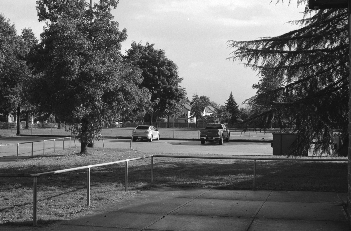

Shot a very short roll yesterday of FP4 (EI 100), and developed it in Ilford MG developer, 1+60. 9:30 20C. Agitation 5s every minute. Negative looks great (subject matter not so). B+F is the same as Ilfosol-3 at 1+14. This is the route my students will be going. Can't beat the economy!

what is “B+F”?

'B+F' = Base + Fog.

Thank you for posting the photo and the details.
To me the results look great.

Ilford MG is about 5 dollars cheaper per litre of stock than Blazinal (our Rodinal here in Canada). From what I can see, there is no loss in quality. Also please keep in mind that this is for high school students who wouldn't know quality if it hit them in the face... :whistling: That said, I wouldn't hesitate to use it for my own, personal work.
