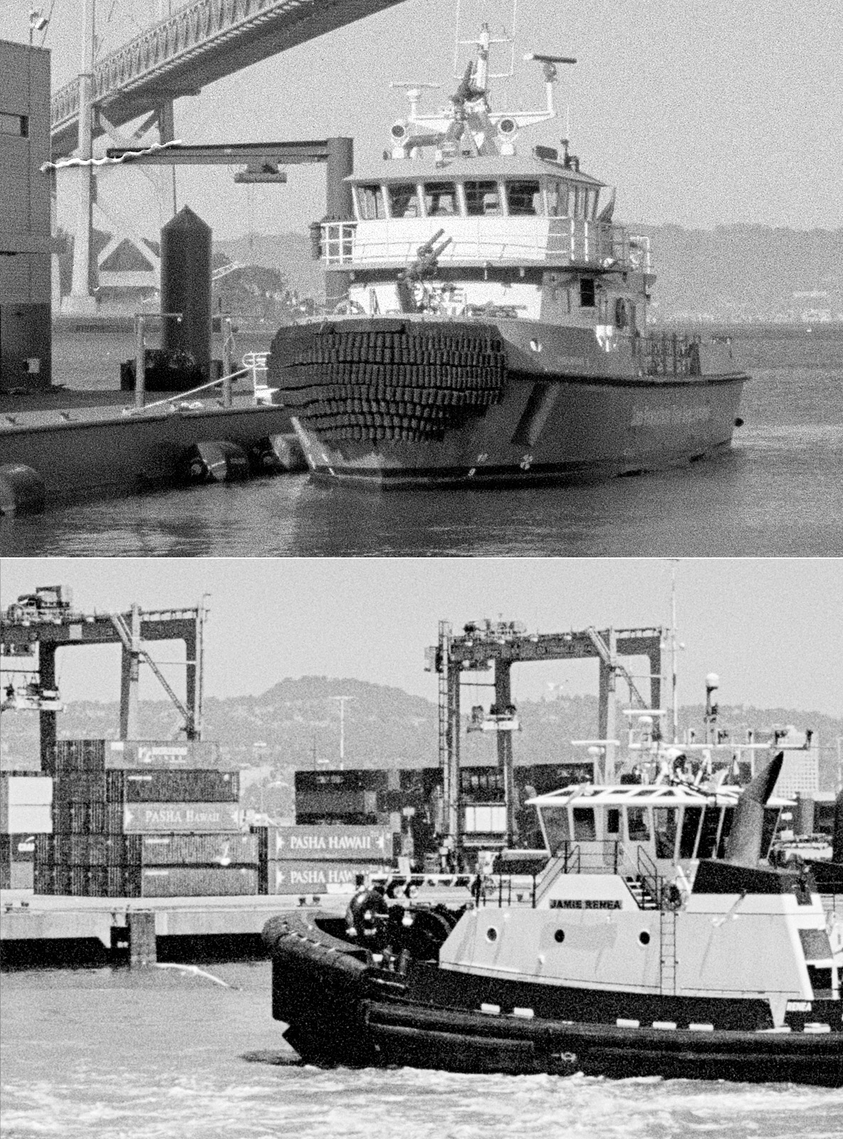

Here's what I'm talking about. 100% crop from two identical sans. Same light, same camera/meter, similar scene, but different dates. Delta 400 is on top exposed at EI400, XP2+ is at the bottom exposed at EI200:
Links to full-sized scans:
Here's what I see:
XP2+ despite being over-exposed by a stop still delivers under-exposed shadows and higher overall contrast. That is why I will never consider it a true ISO 400 film. From the grain quality perspective, Delta 400 grain is finer, more refined, and not as big and blurry as XP2. In terms of detail, the XP2+ has the blotchy appearance and begins to fall apart at lower magnification than Delta, just look at those containers in the background, or open the full sized image and look at all zone 2-5 areas. It looks like it was scanned on a low-DPI flatbed.
Unfortunately I cannot offer a better prepared comparison of both films. But this example demonstrates my issues with XP2+ pretty well, and it was done with a fair amount of rigor. The light & equipment were identical. My processing is controlled and measured: the densities are within aim values as verified with densitometers and control strips. I scanned them using the same workflow. The same gamma, curve, and sharpening were applied to both scans.
The difference shown here represents perfectly what I've seen as I exposed the 100ft of XP2+. Its highlights look great, but everything else falls apart vs better ISO 400 B&W films.
