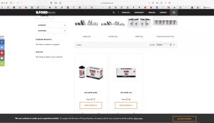

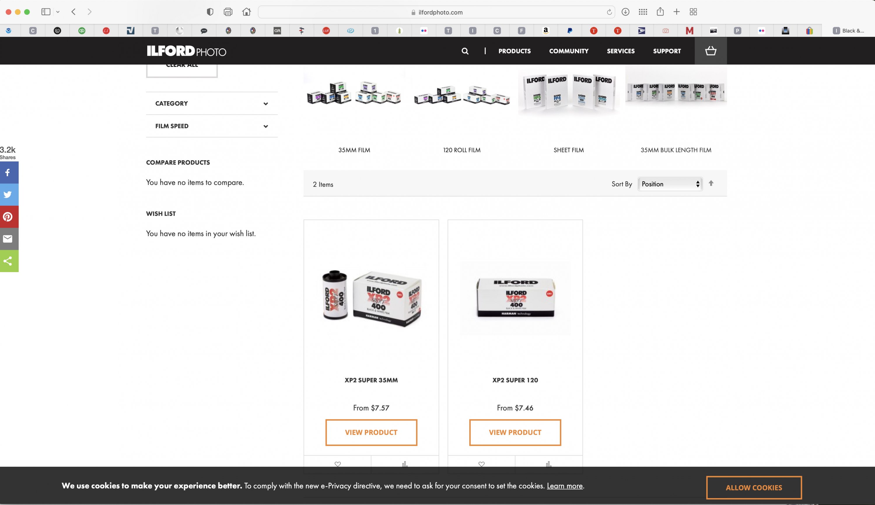

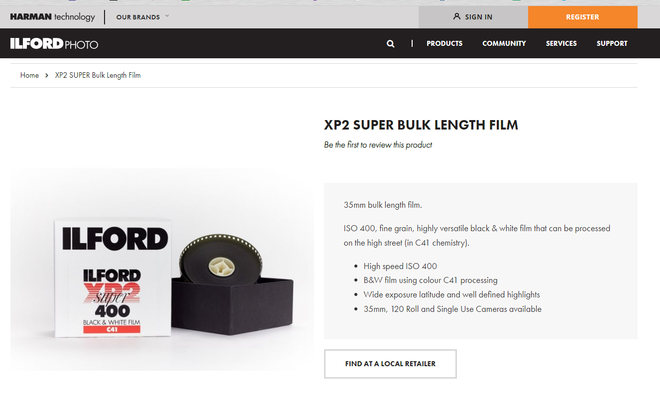

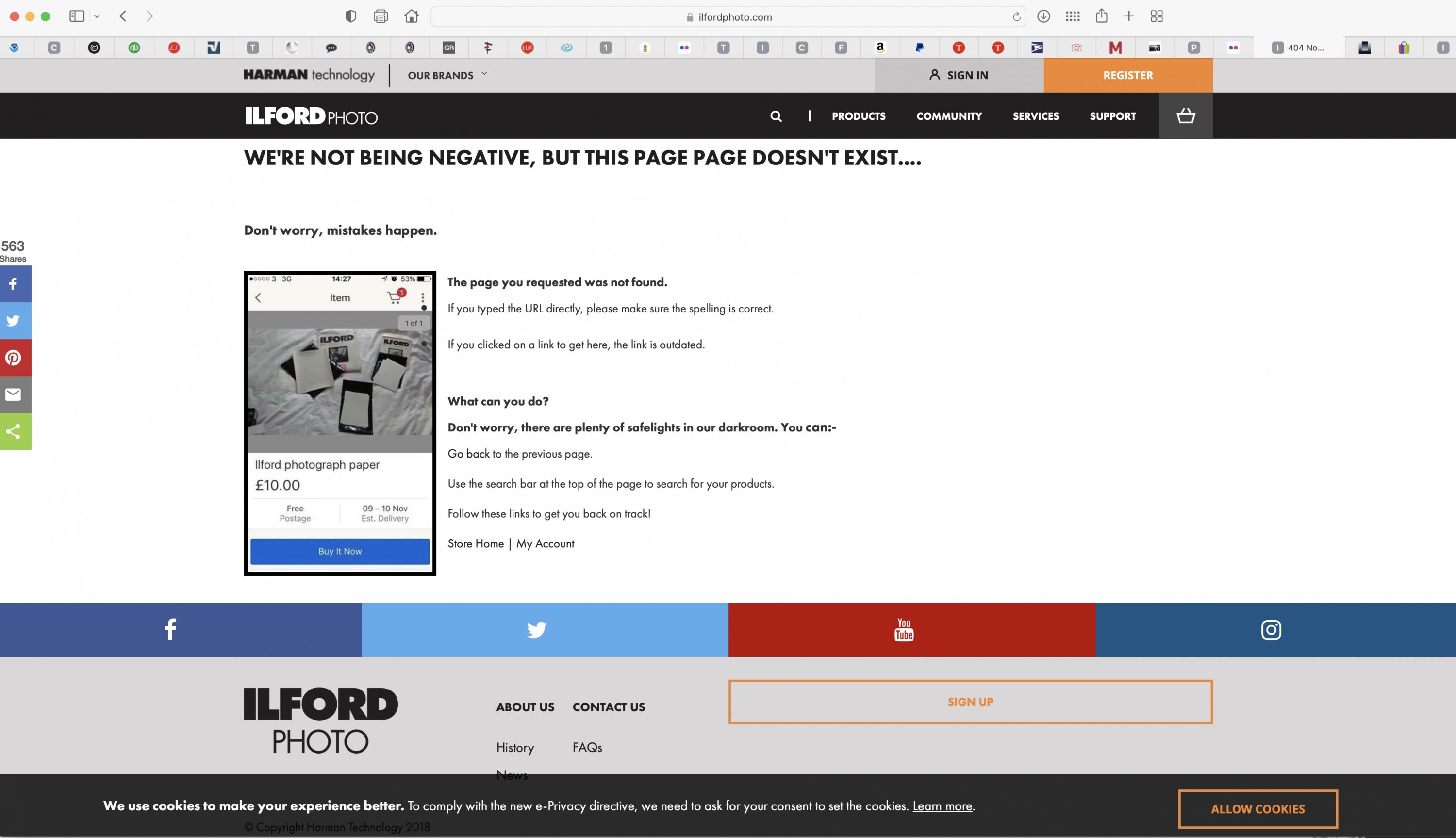

Does anybody know...Has Ilford discontinued XP2 35mm in 100' bulk rolls? I don't see it on their website anymore.
If yes, that would make me sad. Others, likely, too.
(I flipped through this thread, didn't see this being answered...sorry if I missed it!)
I saw XP2 Super in bulk rolls on B&H just the other day; I'd be surprised if Ilford discontinued one of their more popular products in a format that probably has the same or better margin than pre-rolled 24 or 36 exposure cassettes.
Yes, there is still product out there. But strange it is no longer on the Ilford site. Usually, they will put a "sold out" tag on those things out of stock, not just remove it entirely.
What "site" are you referring to - the Ilford/Harman website doesn't have a "store" on it.
Here's what I get when I search for XP2, all formats
Maybe it's just not on Ilford's USA site?
You see XP2 bulk rolls on that page? Because I do not.
Me neither. Might be on a production hiatus due to Covid-related supply chain issues in England?
