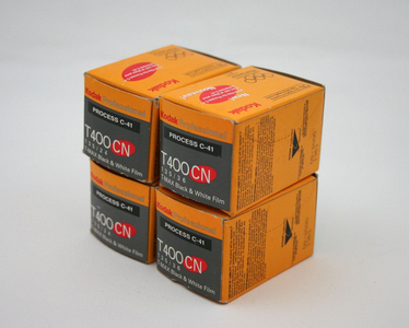

Kodak also sold a differently designated chromogenic B&W -- C400T?

From reviewing the respective datasheets, it appears that T400CN was available as 135, 120, 220 and sheet film, while BW400CN was available as 135, 120 and 220.
T 400 CN was Kodak's first chromogenic b&w film.
